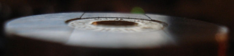

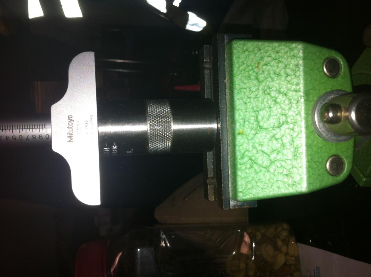

I am definitely referring to headspace not the expansion of the diameter of the case.
Pics should be added as I am using a smart phone.
The pics show the case head protruding from the gauge.
The gauge its self has an internal shoulder so that the gauge replicates that specific calibres chamber.

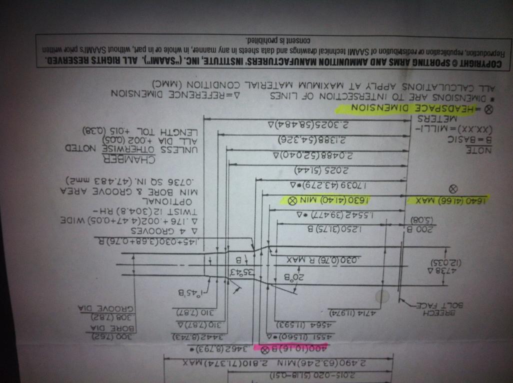

These are saami spec'ed min and max cartridge headspace said:
This is what I want.
The cases are all once fired in someone elses bolt gun.
Once I have SAMMI spec I will fire them once more and the brass should be fire formed.
I do not want several case head seperations in my rifle as from what I have read they can effect precesion over time.
My rifle is customised through a smith and not cheap.
