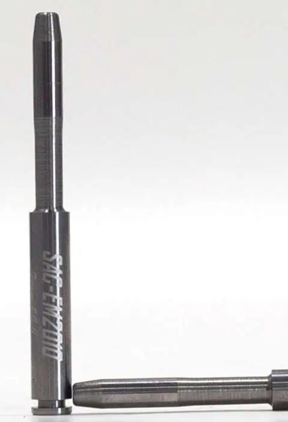

Yes the decapping mandrel they sell. In my situation it wasn’t doing much. .241 mandrel and .266 bushing combination allowed the mandrel to just slip in and out. I have a 21st century mandrel die with their 6mm turning arbor. So I’ve used both.
Even with just sizing using the .266 bushing and then running it under my 21st century mandrel the mandrel just slips in and out of the case mouth.
If I or someone was using a bushing smaller than .266 I could see the mandrel actually opening the case mouth up but in my situation .266 is already larger and the mandrel doesn’t actually do anything.
I’ve read GAP recommends starting with a .266 bushing so that’s what I got. Works well and I get great numbers without a mandrel.

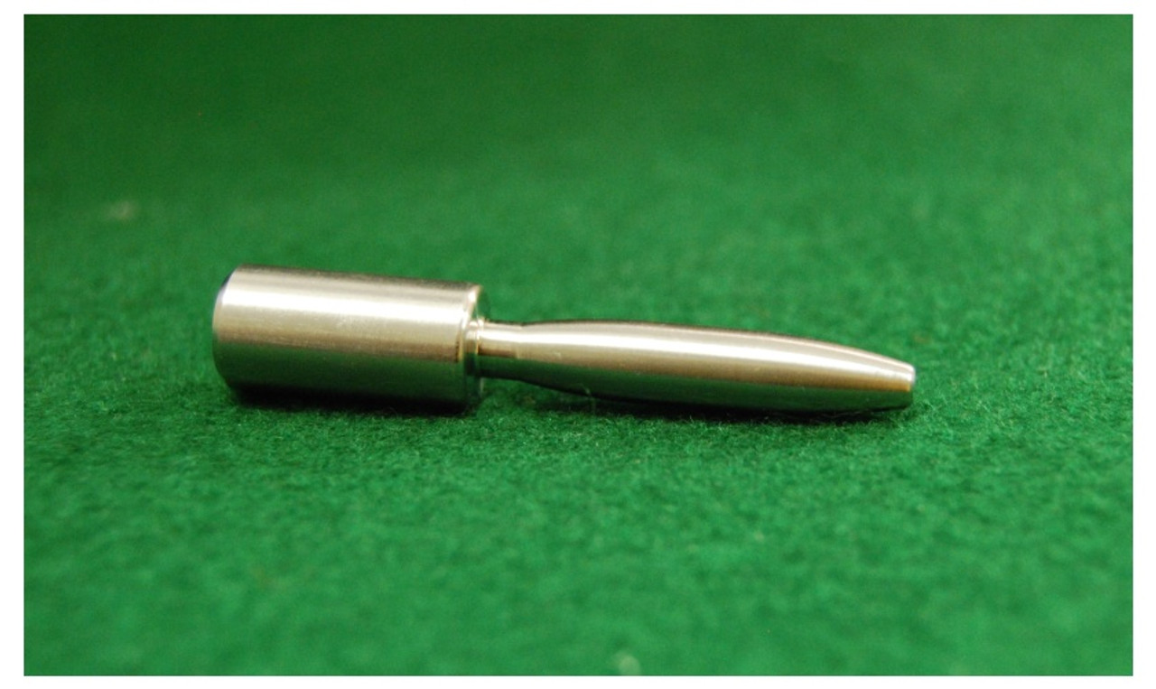

If one looks at how SAC’s Decapping Expander Mandrel works inside their dies, one can see that first it expands the case mouth (not doing a whole lot on the way in as the case mouth is open with fired brass), then there’s a smaller OD section on the “mandrel” that allows the die body to squeeze down the case neck/mouth without the brass getting stuck inside the die, and then it pulls the fatter OD “mandrel” section out of the case (like a traditional expander ball would work, and arguably this is the only time their “mandrel” is really sizing anything). It’s a really good, updated, expander-ball design, but it’s not a mandrel and doesn’t work the same way a traditional mandrel in a second step does.
Half of the point of using a mandrel is to not have to pull up against the case’s shoulder while sizing the neck like a traditional expander-ball piece would… but that’s exactly how the SAC piece works.

On the way down into a case, a mandrel pushes the neck open with the strong mechanical advantage of the case's shoulder supporting it, which delivers the consistent sizing (same concept as why an arch can support a lot of weight in architecture due to the distribution of the forces working against it). On the way up/out, a mandrel isn't really doing much of anything.
Arguably, you get a more consistent neck and don't distort the case shoulder doing it this way.
With the SAC piece, it's just a fancy expander-ball design, that still pulls up on the shoulder while sizing the neck, and not sizing as consistently due to not being supported.

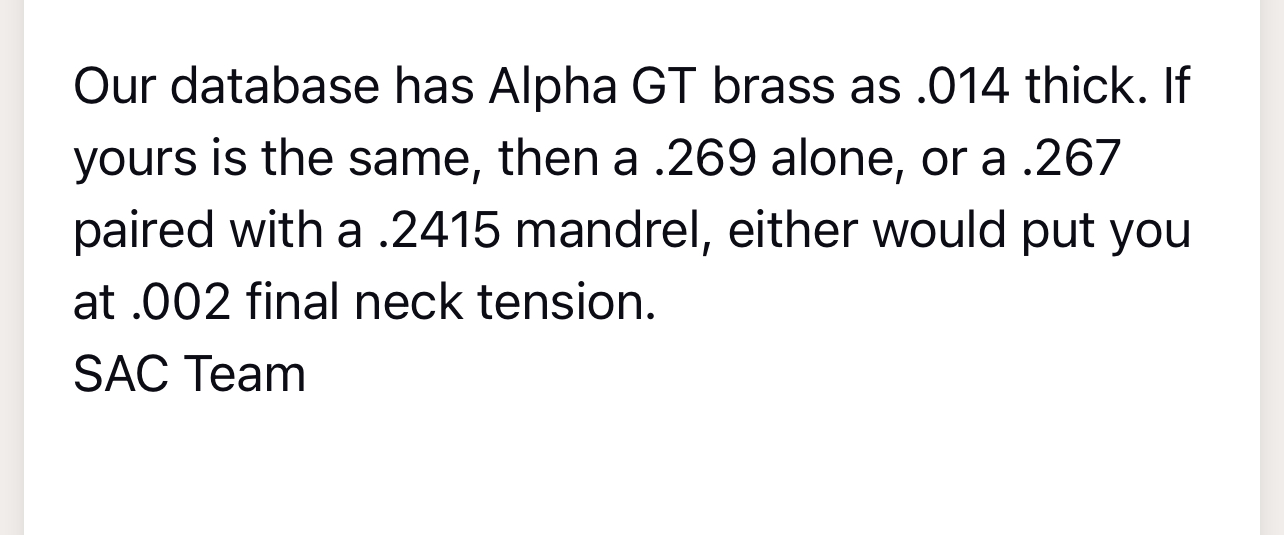

IMHO, the problem is just good 'ol math: if one uses a .266" bushing, but also wants to use a traditional .241" mandrel inside a die at the same time, they're kind of fucked since the tolerance will only allow brass with a consistent case wall thickness of ~.0125" to not get stuck (.266 - .241 = 0.025 and I guess we'd divide that by 2?) ... so IDK if it's even possible to pull off sizing the outside of the cases and sizing the inside OD of the case necks both at the same time.

From SAC

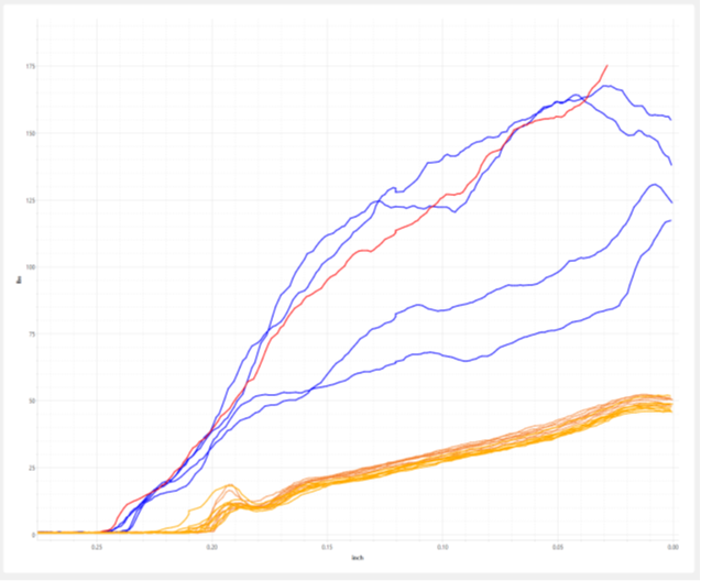

For people wondering about the efficacy of using a mandrel - and I'm adding in neck lube along with it - please look at this overlay of seating forces for two different groups of bullets.
One of the groups was using neck lube plus a mandrel, while the other used neither. See if you can guess which is which. Oh, and this was Lapua brass for both, same prep aside from lube/mandrel, no neck turning. And before you ask, yes, seating force consistency has a correlation to SDs.

Seating force does not correlate to sd.
I’ve shot plenty of f class matches with sd under 5-7 never touching a mandrel or neck lube
