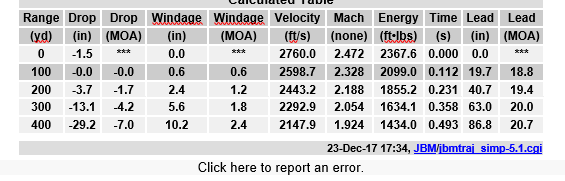

What does lead indicate or meon the ballistic chartan
