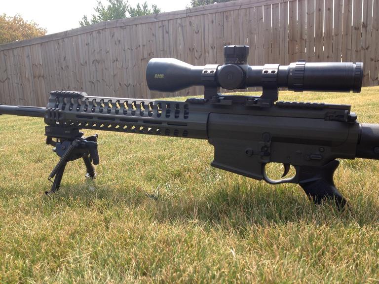

Just get the Badger 1 piece... for the money there is nothing of its quality out there, and you gain little/nothing with shit that cost 2x as much. Its also one of the lighter options.
For a 16" .308, the DMRG2 is a little heavy. I ran that for a little while and would have liked something lighter. Look at the 3-12 Bushnel FFP G2. 30MM, lots of elevation and ALOT cheaper.
If your .mil/leo, they can be had for around $650. The DMRG2 is a fantastic option, but it will weight down a lighter rifle right quick. The 3-18 MK6 and Vortex 2.50-10x32 are also great options.
My suggestion, ADM Recon if you want something removable, JP Enterprise mount if you're leaving fixed.
I'm running both of these and they are high quality, durable, very well made, and do a great job holding zero if you need to remove / remount the optic on the gun.
I'm using the Alamo Four Star mount as well. Mile High has them for 200.00 and it will clear Magpul BUIS with no other riser. Beware, this advice could be 90% downright shitty.
