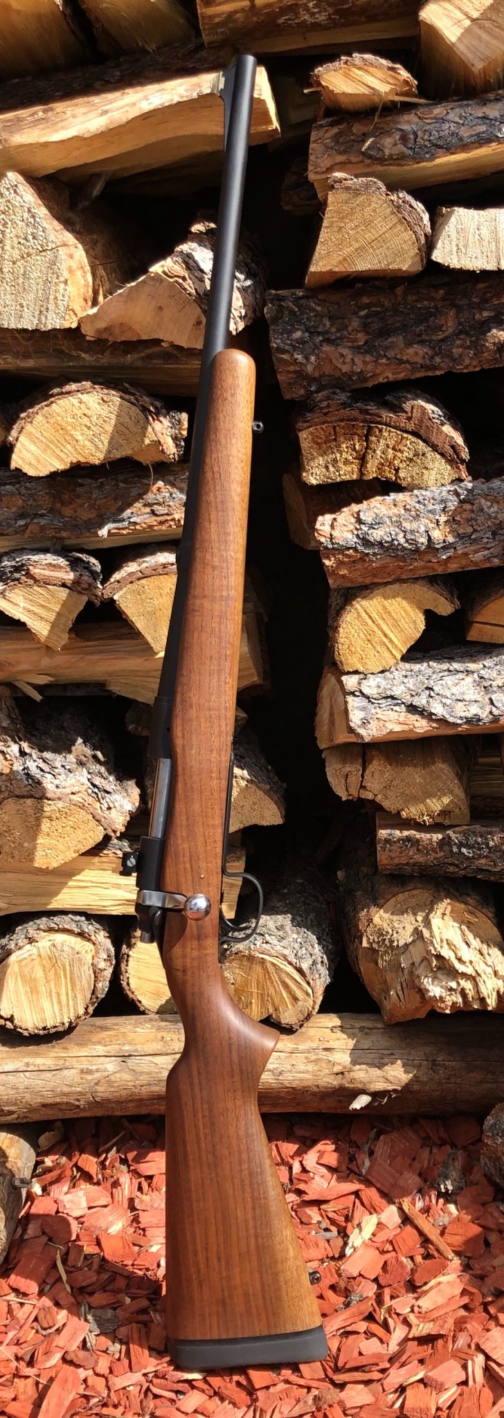

My wife recently inherited her grandmas 722 and I just finished restoring it. It’s a .300 savage so probably not quite as punchy as the 06’ but the decelerator made a big difference.
Nice rifle! I have it's brother in 257 Roberts.
As to the OP's question; what everyone else has said. Fit, pad and weight.
