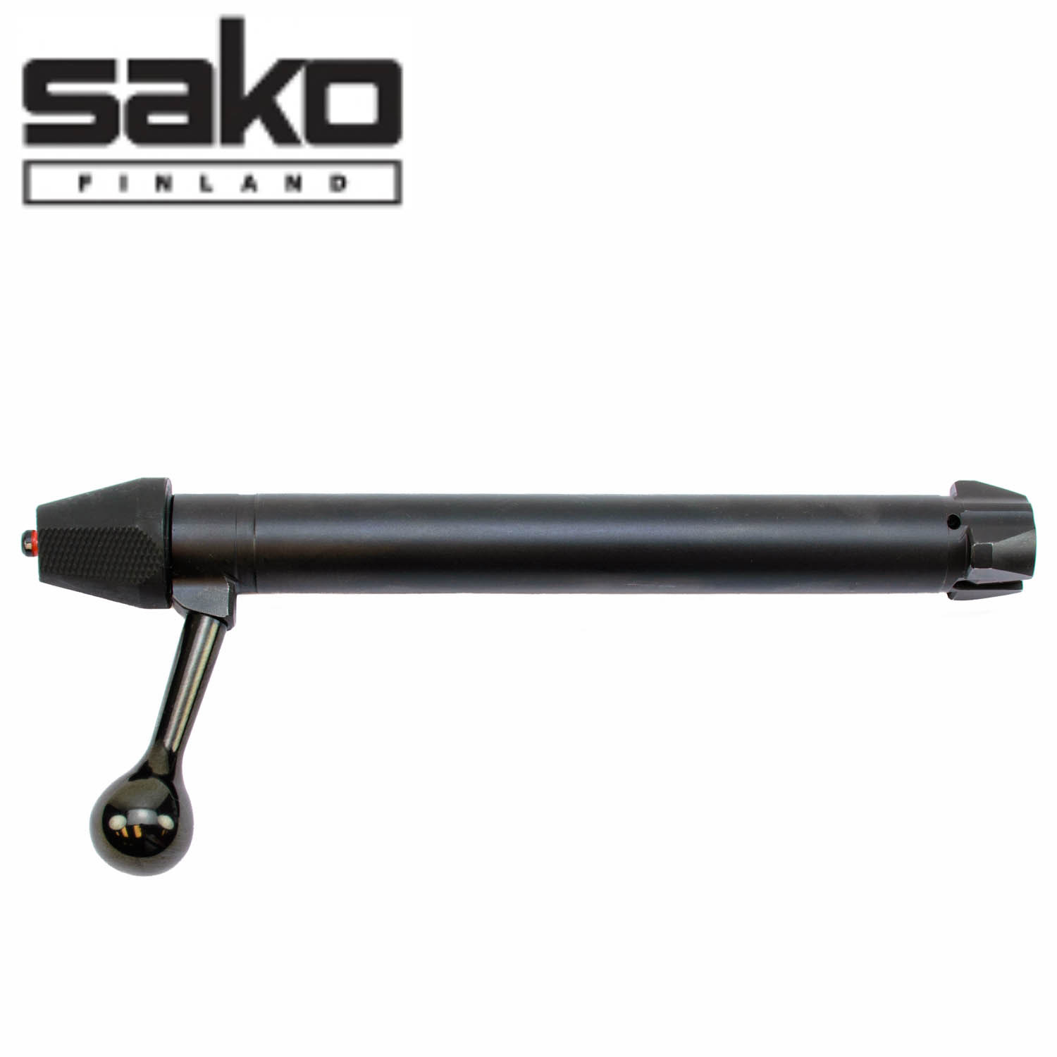

Not certain on what to do about a magazine (perhaps a 300WM magazine with adjusted lips and a spacer in the rear like the 6BR mod for AICS mags).
As for the bolt, the Sako TRG-S (M995) was chambered in 30-06 I believe. You can buy a bolt body for it and use it in your TRG42.
Here’s a link, but it’s not in stock. Find one in stock somewhere and figure out a mag and you’re good to go (easier said then done).![]()
Sako M995 RH D12 Complete Bolt, Blued
