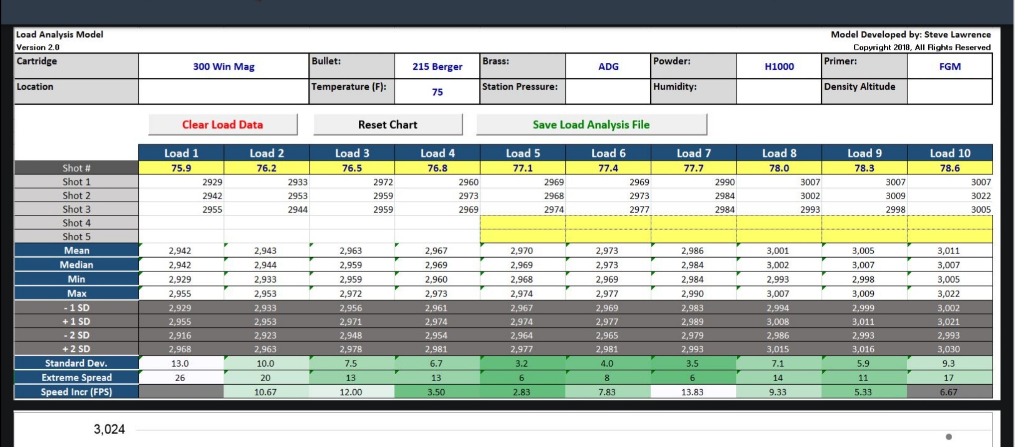

I've been reloading for a few years and have really tried to improve my handloads this year. I turn necks, anneal, full length size with bushings, expander mandrel to final neck tension. I don't sort bullets or cases and I use RCBS Chargemaster. I don't weigh to the kernel. I've tried different neck tensions, different lubing processes, seating depths, bullets and case prep.
OK, so here's my question. I can only achieve SD's of 10 and ES of 30. These are repeatable and measured over a Magnetospeed. Should I call it good? I'm a long range steel shooter and mule deer hunter out to 600yds max. I shoot 7/08 in a custom build. I don't compete or aspire to shoot 1 hole groups, although I wouldn't complain if I could, lol. I can shoot 1/2"- 3/4" groups. I've had a few .3" groups.
My thoughts are it's more than likely in my powder throws, but could be a combination of things. Thoughts?
