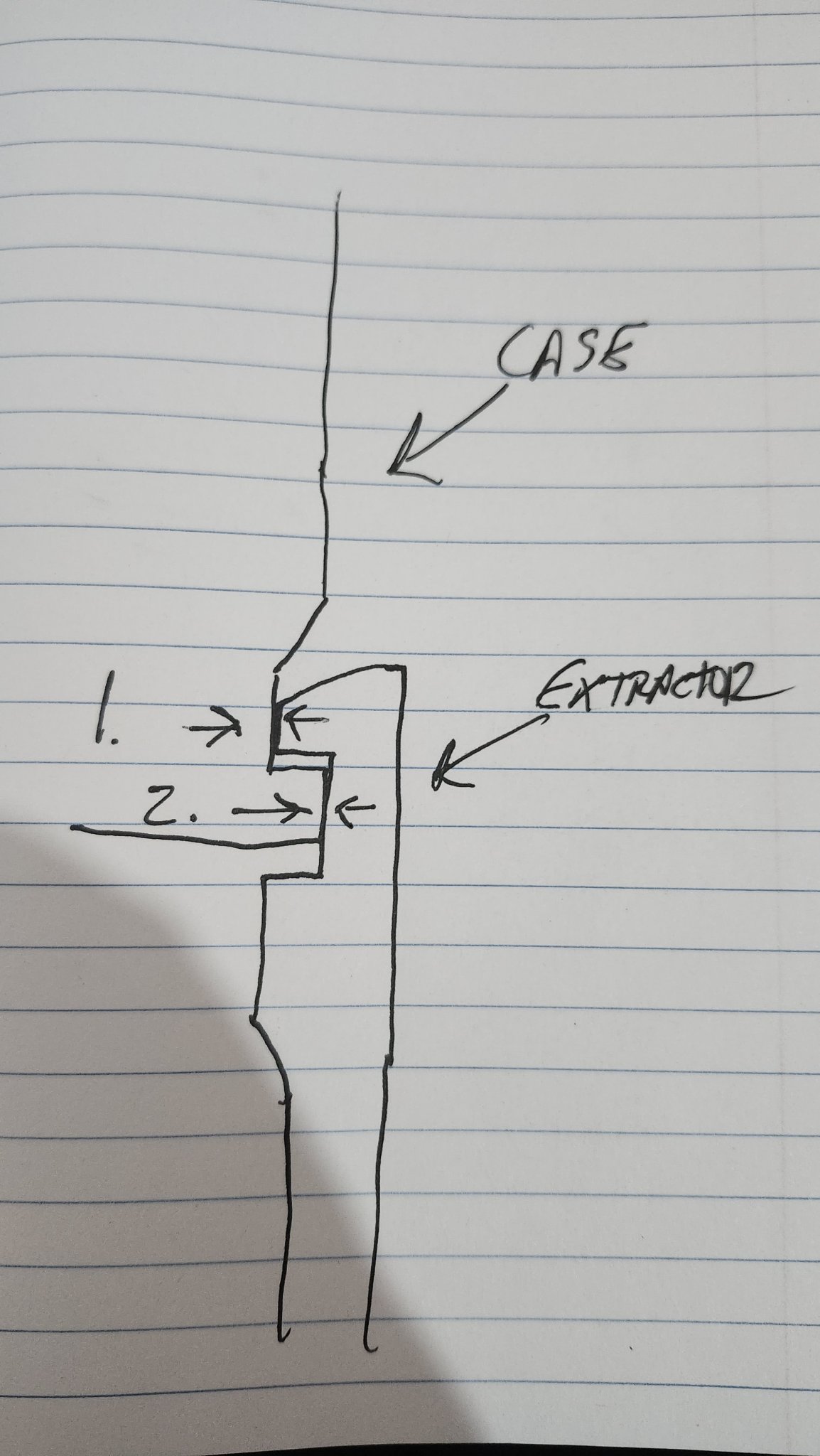

Yeah when a 1911 begins stovepiping that's 99% an extractor issue. If the little claw tip is too short, or if there's not enough tension, it'll come off the rim as it's moving back.
Geometry:
1. You want the tip of the claw to contact the inner portion of the rim. 2 you want the lower portion of the rim to contact the cut-out portions of the extractor. This will give you maximum sirface contact. (See picture)
Tension:
Take the slide off. You'll want to be able to push a live round between the extractor it it will have enough spring force to basically hold the round without you helping. Better to error on a hair "too much" force than too little in my experience.
Hope this helps.
Installed new extractor yesterday afternoon and went to the range today. Shot 72 rounds of steel case and 50 rounds of brass. No failures. Looks like the Tisas DS 1911 is back in action. But, from now on my match range bag will contain a backup gun, just in case…

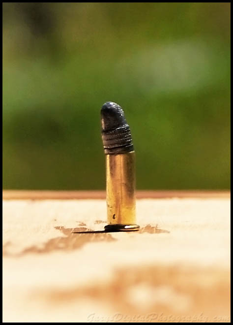

Ever fix a jam during rimfire positional practice and it looks like a bent nail?
But you say what the hell, it's practice/plinking anyways.
So you unbend it and jam it back in the magazine to save that 2 cents/round from the Winchester 555 bulk pack you bought in 2006 and proceed to shoot because you know, "practice."
From the wear induced by the additional dirt/debris, risk for a squib, a flyer from something that looks like the cars that Big Foot drives over, and ultimately not knowing whether you missed the shot because of the boomerang shaped cartridge or poor position build, I just wasted time and wear/tear on my system.
Poors gonna do what a poor does best... waste the most valuable resource that can never be replaced, time.
PS. If you've picked up ejected rounds after 22LR matches and shot them to see if match ammo does what match ammo said it can do, you my friend are on the SnipersHide welfare system.

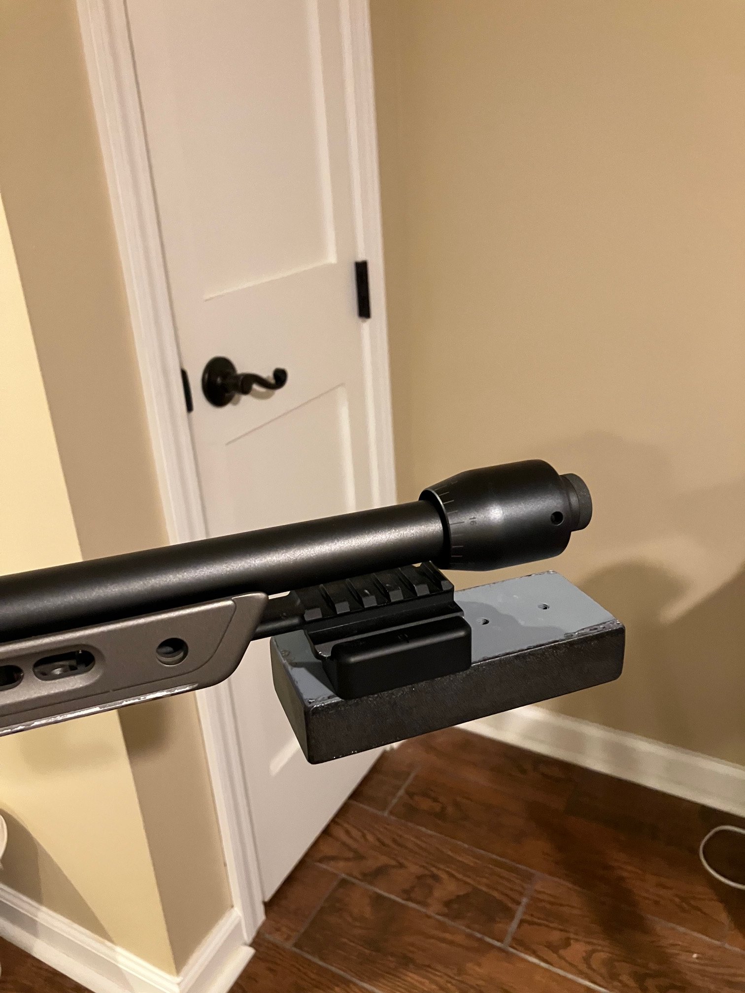

Back on track... a thing that took me forever to learn in this PRS game is that the game is about balancing the rifle at a single point.
Mass and balance point of the rifle 2-3" in front of the magwell helps tremendously for positional stages.

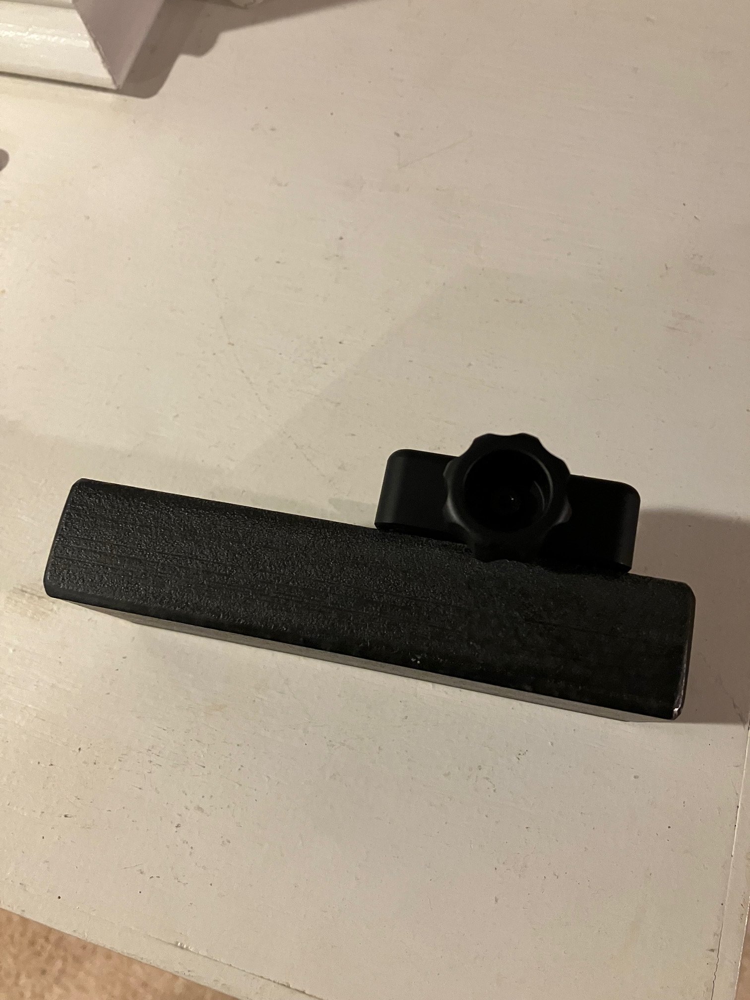

Well being a poor, I could not afford the fancy M-Lok weights that run between $59 - $99 for .5 to .75 lbs.
Poor-engineering to the rescue. 5"x2"x1" iron bar stock, rattle can, drill + tap set, and $15 ARCA rail from Amazon and you get this 2.5 lbs piece of modern art suitable as a counterweight.
It moved the balance point 2.5" in front of the mag block for my Bergara B14r Steel Barrel when mounted on the springboard, I mean bipod spigot. Even I know not to mount my Caldwell clone from Chynuh on that wobble contraption.
YMMV, happy shooting.
I totally dig your cheapp-ass chassis weight work around.
