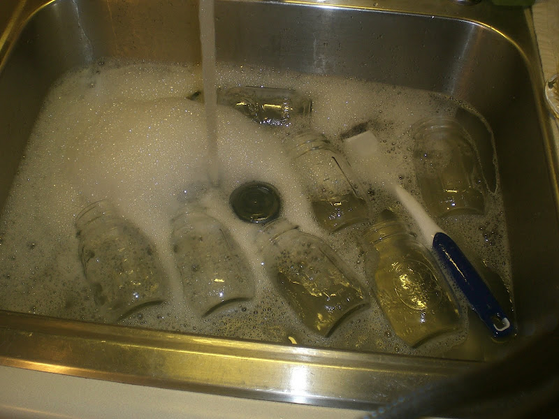

First, sanitation is key. The purpose of canning is to kill the little nasties that live in our food. Freezing is another good way to preserve food for a long time when done correctly, but canning does not require additional electricity. It only takes having to replace a fridge/freezer full of food once to recognize the benefit of having some of your meat stored by this method. So...lets begin.
Wash the appropriate number of jars for the meat you have on hand. You can always put clean jars away, or cook up the extra meat if you find you don't have enough jars (like me...)
After inspecting the jars for cracks and rough rims which would prevent a good seal, then wash the jars, rings and lids in hot soapy water - as hot as you can stand the water.

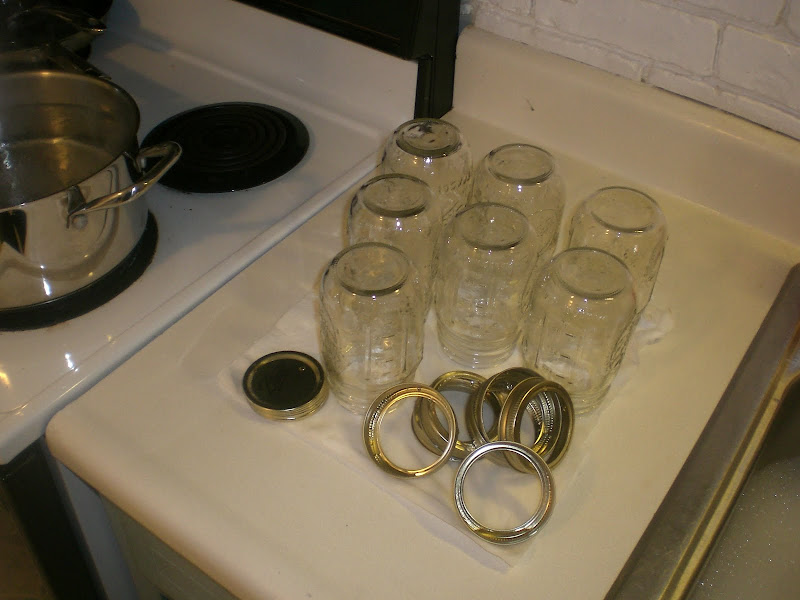

Once cleaned, then the jars need to be sanitized - a dip in boiling water will accomplish this. Keep the boiled water handy - you need to keep the lids in this until ready for use. Not BOILING water, but just below - about 180 degrees. Let the lids rest here until you need them for the packed jars. This pic shows the sanitized jars, rings, and the lids are ready for thier dunk.

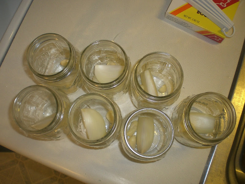

I will now begin to pack my jars. What you put in them is entirely up to you. The proven recipe used by many people every year is simply a single tsp of <span style="font-weight: bold">canning</span> salt in a quart jar, packed with raw meat as tightly as you can get it in without breaking the glass. Table salt has fillers that will form a cloudy mass at the bottom of the jar. :barf:
Make sure to leave 1" of head space for cold packed meat. Do not add any liquid. You will see soon that the meat will make its own liquid very quickly.
My recipe is 1/2 teaspoon salt or beef bouillon powder, 1/8 of an onion, a grind of pepper, and one clove of garlic in pint jars.
Here are my jars ready for packing (minus the bouillon powder):
When packing the meat chunks into the jars, make sure to work clean, and be sure to leave the proper amount of headspace or when you open your canner, you will have glass and venison stew. I used a small sandwich bag with the bottom cut out to keep meat off the rim of the jars. Please go spend the 2 bucks to get a Ball funnel - i was too far into this when I realized i didn't have one.

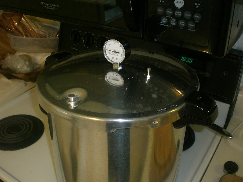

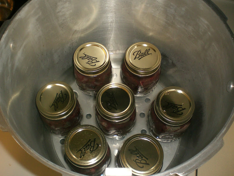

Here's all the jars in the PRESSURE canner, ready to rock. Water filled to the line as instructed in the manual for MY canner. Yours may/will have different levels of water to maintain during the canning process. An old tip to keep white reside from forming on the jars is to add a couple table spoons of vinegar to the canning water.
My canner suggests that you bring the water inside to a boil, then place the lid, and allow it to semi-pressurize before putting the pressure regulator on. Allowing the pre-seal to engage and letting the canner vent steam for 10 mins as directed in the manual is seen here:
Process at 11 to 14 lbs pressure (10 lbs will get you to 240 deg F) and process PINT jars for 75 minutes, QUART jars for 90. I did mine (pints) for 80. Do not quick cool the canner after the time is finished, just shut the heat off and allow the canner to cool on it's own. once the pressure vent and overpressure plug drop on their own, check for steam by tipping the regulator. DO NOT let the pressure gauge be your indication that pressure is gone. it will still read zero lbs and have a good degree of steam inside.

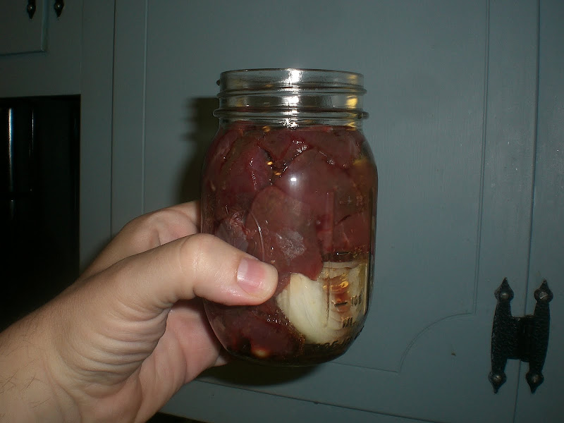

I found it interesting just how much liquid was in the cans after the cooking had completed. be careful not to tilt the cans until they are cool to the touch, this may prevent them from sealing. I also found it interesting that the liquid inside the jars would continue to boil for some time after removing from the canner.

Enjoy...this was easy enough that it is now a permanent part of my deer processing now that I have the pressure canner.
as for how to use the canned meat - most folks just dump the can into a sauce pan, add some kind of gravy or thickener and serve over noodles or rice. another good one is to add some diced soup or stew veggies and make vegetable beef..er...deer soup or stew. I'm a sucker for a can of mushroom soup mixed in with a couple dallops of sour cream for some stroganoff served over noodles.
the canned meat is amazing in flavor and texture. IMO, it's the ONLY way to treat an old buck. yearling or 2 yr old does will go to the steak and jerky pile, but the old bucks are now going directly into cans.

Well after seeing this thread I went out and got a pressure canner and finally canned some deer meat. Did it yesterday on a snow day and ate the first jar today. First impression...It was great! Put one pint jar in a skillet and 2 cans of cream of mushroom soup in a skillet. Got it nice and hot and served it over egg noodles. Had a nice 12 year old single malt. Fast and easy after a day of working. I followed the JasonB's directions from above but put half a jalepeno along with the onion and garlic. I used a meat from a deer that I had just quartered up and frozen from bow season. So anyone could still can some stew meat from earlier in the season. The pressure cooker made alot of noise and pissed my wife off. I would suggest doing it when the Mrs isn't around unless yours is more understanding than mine (which isn't a big deal). Walmart didn't have any mason jars. I got mine from Big Lots. After talking to friends it is mainly dollar stores that have them. Ordered the pressure canner as a kit off of Amazon. It had everything needed and had all kinds of good recipes that are awesome for wild game. I made a venison roast and it was really good (wife loved it).
Guys this is really easy to do. It is a little time consuming and it I was going to be doing alot of this I would have to have multiple canners. It is a long process. The results are worth it though.
Here are some pics
Canned Deer Meat
In the Skillet
The best part
