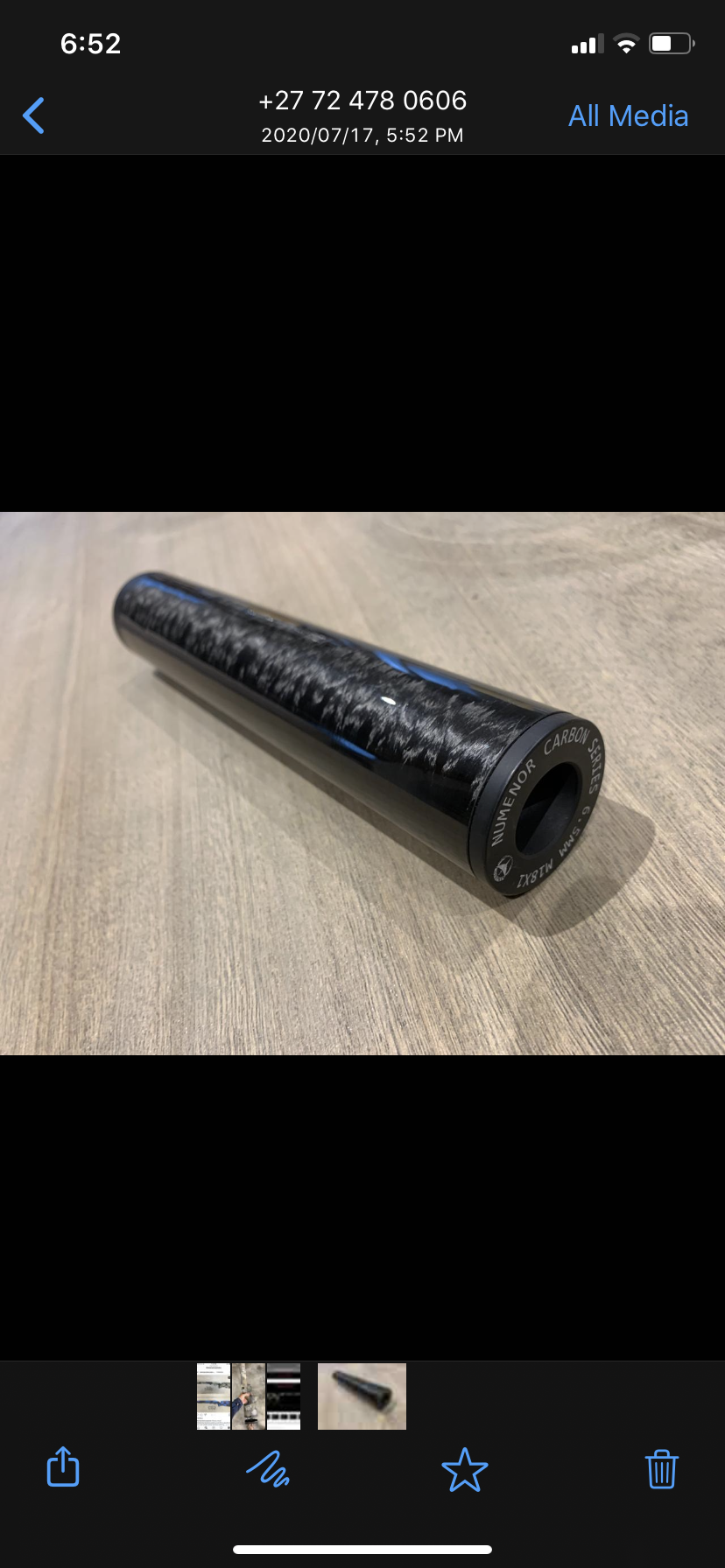

Hi I’m in sa and have ordered a locally made carbon fibre suppressor in 6.5 there are a lot of benefits to it like heat dissipation and weight advantages
