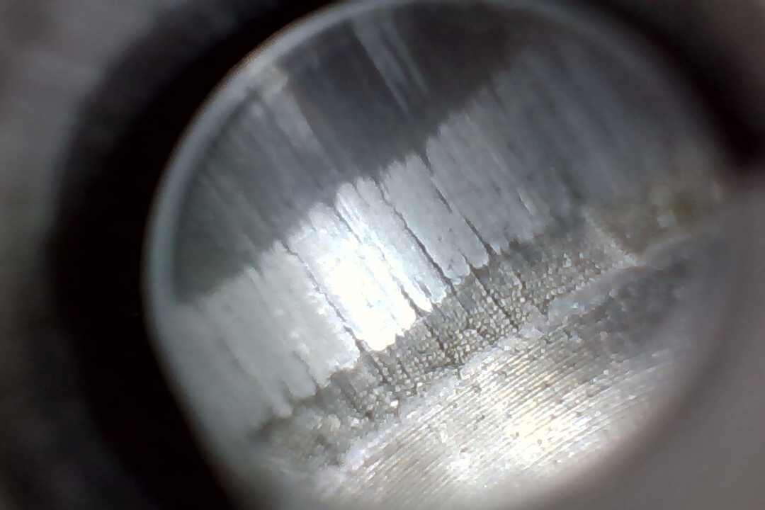

Hey guys tell me if you see the carbon ring I scrubbed the hell outta this barrel with CLR, Let me know what you think just I am not trying to overthink it but what some pros perspective who have delt with this before. In my mind it is still there but I may be looking at the wrong area.
Just texted this to a good friend who is very knowledgable in this. People new to carbon rings and dealing with them, the small bit of carbon at the bottom of the barrel is actually the transition between the chamber and the barrel. The bright spot is where my carbon ring was that has now been removed.
For the future guy may look into bore tech c4 carbon remover to help fight carbon as well. But yes there always seems to be a dark mark at the end of the chamber you could chase all day. Even if there’s a little carbon there if it’s not affecting velocity or accuracy then run it!
