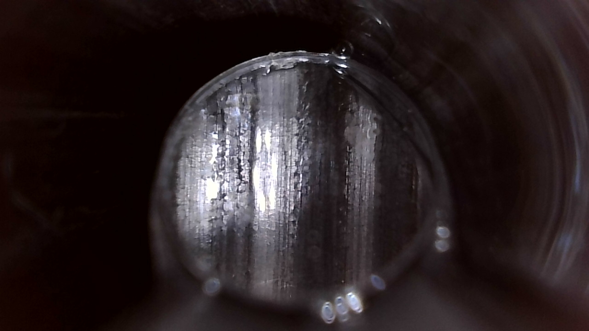

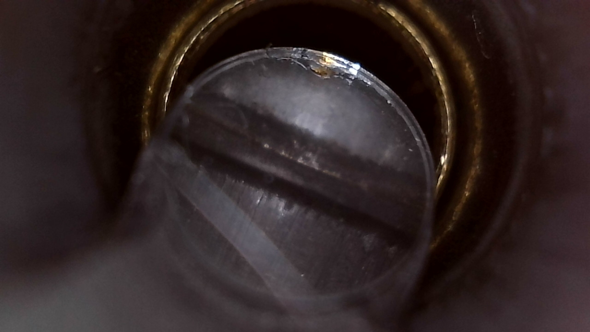

Had my first carbon ring cause issues and of course, now am paranoid.
Got the borescope gave it a thorough cleaning. What the F am I looking for?
Here'a pic with and without a piece of brass
Which area am I trying to scrub out--when i was getting marks on bullets, im guessing it was in the throat, but there is that black shadow right there at the edge of the chamber--which one am I trying to remove?
Get a bore mop or shotgun mop and soak it in a carbon remover, twist that in there and let it sit, repeat that a couple times then flush fith brakecleaner and see if it goes away.

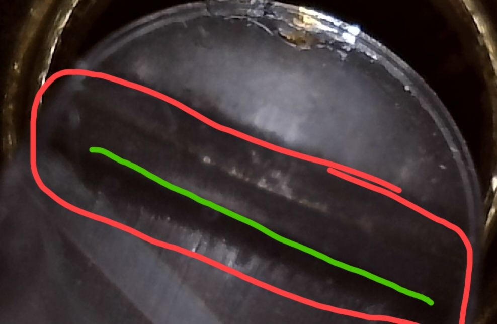

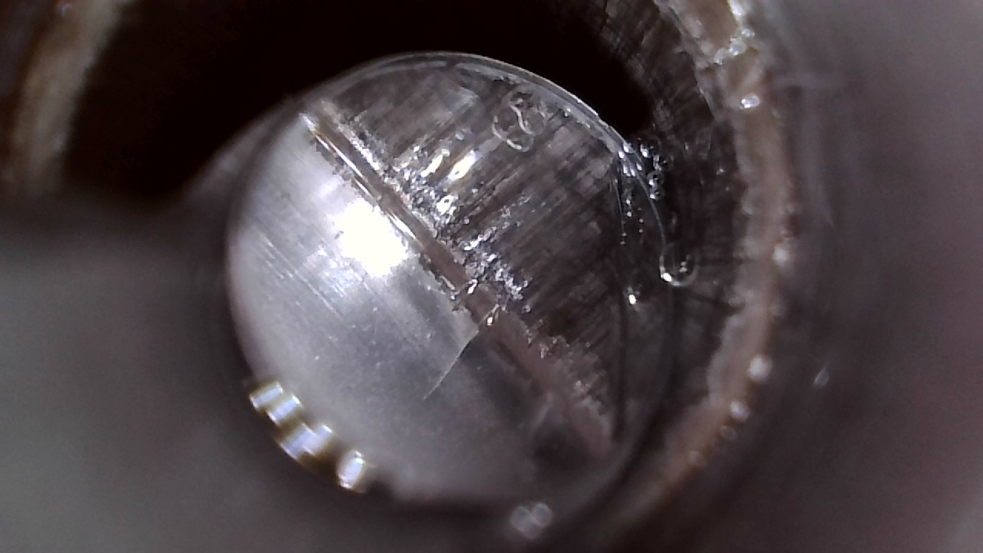

Couple further questions (feel free to mock my noob-ness and use of borescope)
Here is the start of my throat (lands to upper right). Do I need to worry about the discoloration? I've pounded this barrel with cleaner and elbow grease (Its the same barrel as above). My though is, its clean enough to shoot (1500+ rounds on this one). I stand to be corrected.
Near the throat the riflling looks a little carbon-ized. Is this something to obsess over or just drive on.

I’m probably guilty of this also. Also, I’ve noticed that sometimes the dark streaks are shadows of the lands. As I gain experience with the borescope, turning it as it moves in the bore eliminates the land shadow and reveals the carbon or lack thereof.
THanks guys I appreciate it. I'm calling it good for now. Main goal is to avoid those pressure problems and not go OCD over complete bore cleanliness like the F-Class doods (no offense F-class doods). IF I evver get good at F-class, maybe I'll let the OCD go hog wild, but I got too much **** to do to spend hours cleaning a rifle.

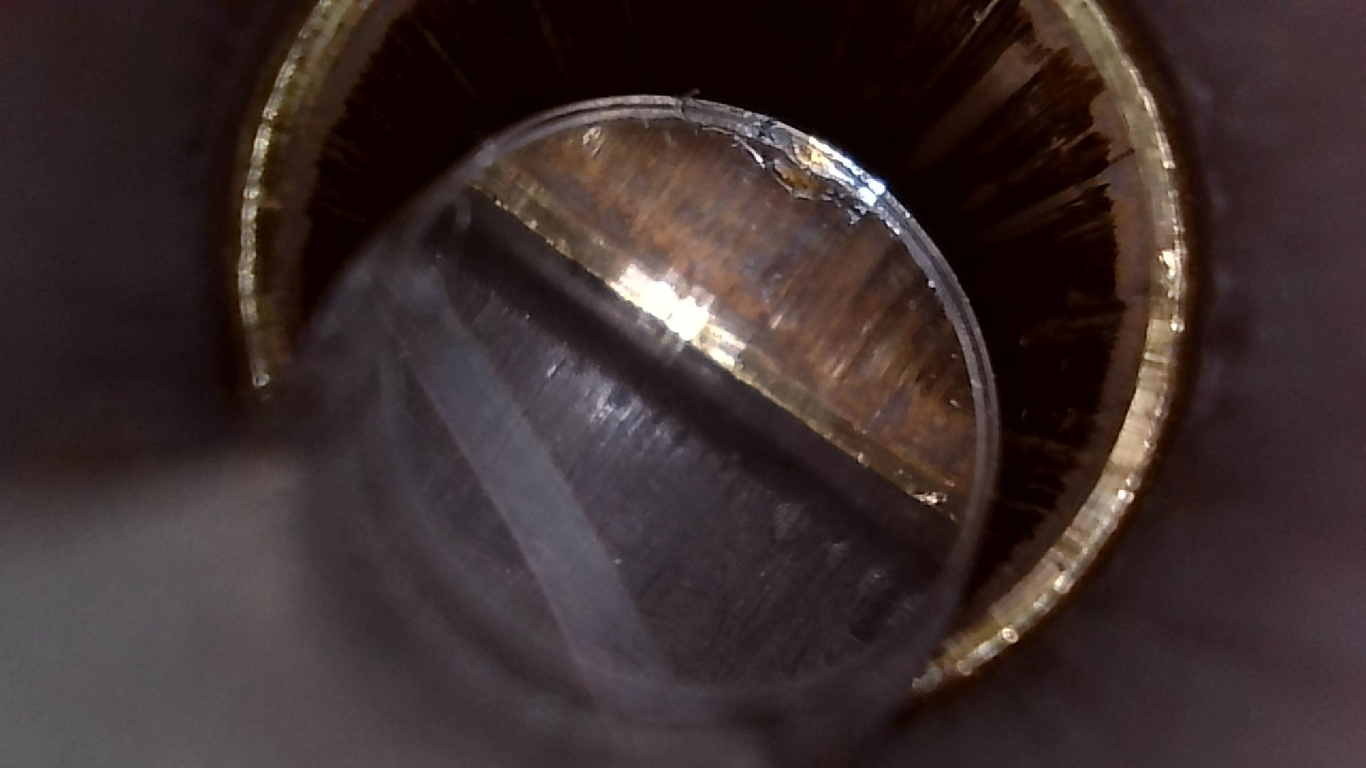

I just had the same issue Wednesday. Met a very experienced guy that was going to help me with several things, one being making sure my rifle is set up correctly and I had good dope out to 1100 yards. Started out good and then I couldn't hit anything. He shot it and the same thing so we knew it was the rifle or possibly my reloading which is quite possible since I am new to it.
My throat area had a ton of carbon build up and also had quite a bit right where the lands starts so hoping this was the issue. I didn't have a boroscope so feel like an idiot now and bought one yesterday. Evidently between my previous cleaner I was using and my cleaning method I thought I was cleaning it good but obviously I wasn't. Barrel seemed to be clean but didn't realise so much carbon was building up in the throat area.

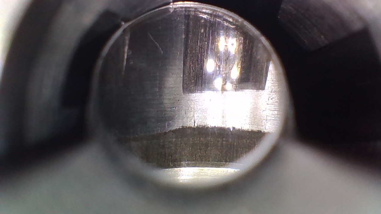

I had to get the barrel rethroated. The original reamer only had 50 thou freebore. Bit tight to shoot Lapua Scenars. The clean part is where the reamer took steel away.
