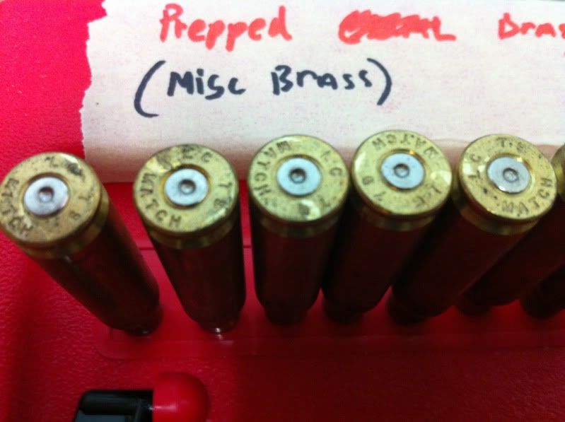

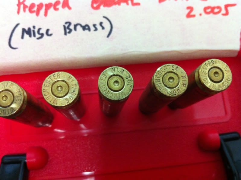

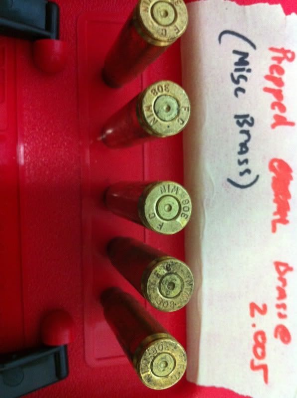

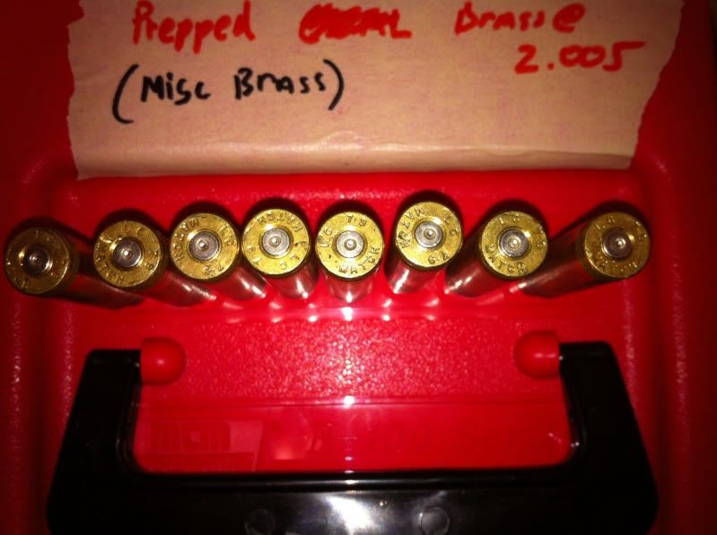

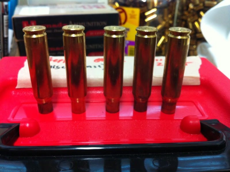

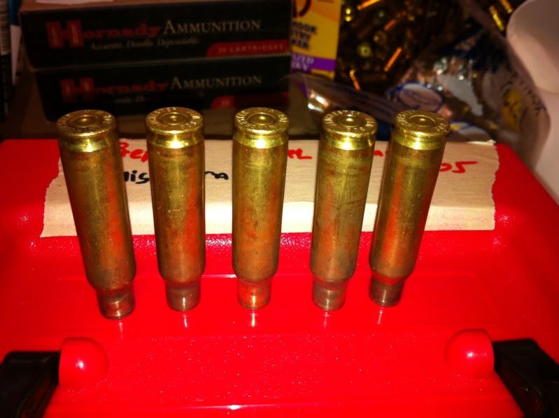

***Updated with pics**
Dirty and light marks on the head case.
FGGM 168:
New winchester brass loaded:
LC Match once fired loaded:

You have kind of indicated two different problems. The title states case head swipes which can be from just overgassing a mild load but then in the text you mentioned ejector marks which usually indicate over pressure. can you post a pic?
typically a ejector mark is a round brass flow into the area around the ejector from extreme overpressure. a case head swipe can be caused by the ejector but can also be from any part of the bolt because it's unlocking so fast and the brass is staying stationary in the chamber. swipes don't really mean overpressure in the case. so the terms are not really supposed to be interchangeable one is much more severe than the other in terms of pressure.
hopefully the picture will help diagnose the problem.
I think you are overgassed. it's kind of hard to definitely tell since there are two different primers but none look overly flat and there no real ejector flow marks. my recommendation is to GET AWAY FROM VARGET first and foremost. If you have an adjustable gas block then by all means trying closing it down some and try again. H4895 is much better in gas guns and has much lower port pressure for comparable chamber pressures.
