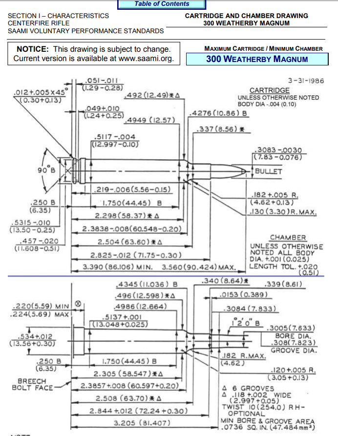

If you have a print of the reamer that made your barrel refer to that, if not I am including saami specs just for some fyi
The case overall length is 2.825-.012 so a case length from 2.813-2.825 is in spec. When you full length size the brass you will find that it will have grown, likely somewhere in the range of .010 if I were to hazard a guess. That puts it right there above your modified case.
Notice that the chamber is called as 2.844+.012 so it could theoretically take a case up to 2.844-2.856 long but I wouldnt dare go over the specs mentioned above when shooting something as large as that when its just too easy to trim and not blow yourself up.
