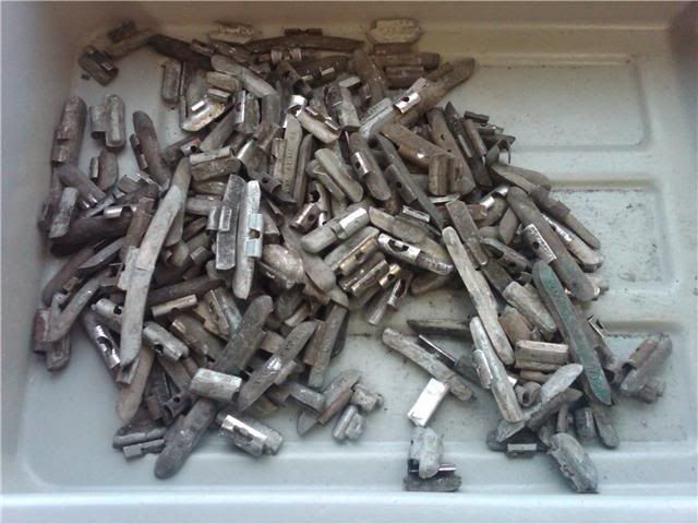

I went to a Local tire shop an picked up approx. 30 lbs of tire weights. They were more then happy to see them go.

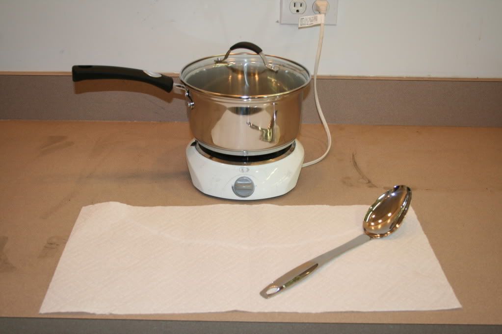

I then went to a grocery store and picked up a pot (To melt the lead weights in)and a large spoon (to skim the top)
Make sure to be in a well vented area. Also, use leather gloves, safety glasses, a dust mask and an apron.
I placed the pot on top of my small camping burner. I filled the bottom of the pot to start. After a little bit, the lead started to melt. At that point I added more weights. In all, I fill the pot to about half full. As the lead melted, impurities and the steel started to float to the top. I then used my large spoon to skim the top.

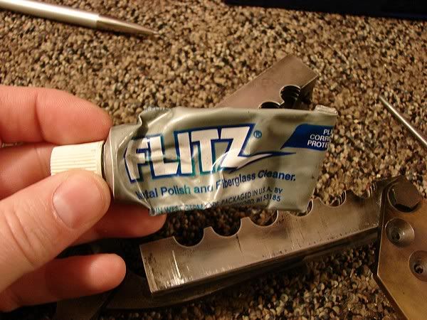

A little trick if you have a sticky Lee Mold! Take one of you cast bullets and hold it in one of the cavity's. Scribe a line along the center of the mold and find the center of the bullet. Take a drill bit and drill a hole into the bullet while holding it in the mold. Put a piece of tape on your bit to keep from drilling to deep. Then take a drywall screw and screw it into the bullet. Clip the head off the screw and your ready to polish you mold cavity's.
Put a little bit of Flitz metal polish on the bullet place it into the mold cavity and hold the mold together tightly. Spin the bullet in the cavity for several minutes. Repeat for all cavity's and then clean the cavity's out with brake clean and a tooth brush.
The next time you cast you should notice the bullet release out of the mold with little or no tapping, wrapping, beating of the mold. I have done this with all my molds and it is night and day how the drop out.
The match trick is not to heat the mold its called smoking the mold! What your doing is trying to get a nice black layer of carbon on the cavity's. This is the old fashion release agent.

uuuuuhhhhhhhhhhh NOOOOOO dont use that pot for sure i have been casting for 15 years everything from .224 52 gr lyman molds to .308 110-220 gr molds (i have over 40 moldsand probably more than that.....that hardly ever get used)and all different kind of 9mm, 452 and 44 cal molds. You need to sit down and read quite a few books Lyman 2nd editions (great book) and not burn down your house. It takes time and your house isnt ventalied near well enough to use a cooking pot. lol geez man PM me and Ill help you out with some ideas it just kills me how people think they can get by with dangerous ideas it takes years to get the right experience nothing you can gain in a week and NEVER use kiten appliance they arent made for casting BOOLITS. you have to get your metal right or youll have krinkling and bullets not filling out. I say casting GOOD quality bullets is aleast 10x harder than reloading with 3 times the risk of self injury.
Re: Casting Bullets!
Great advice shooter. That room is a decontamination room with a lot of ventilation. I just took a picture in the room, I melted the lead outside. Great advice though

Personally I think you are going to wish you went back to the tire store and picked up the WW. I have tried range trap scraps before. It was one of the biggest messes I ever got into. I will never do that again. I would pay $1 a pound for scrap WW before I would deal with that mess again. It just was not worth it to me(and I am pretty cheap). One trick to help you a bunch. Do not do any smelting until you buy a lead thermometer.

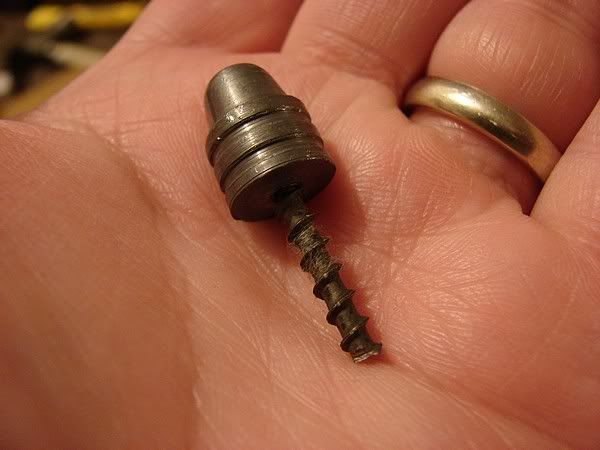

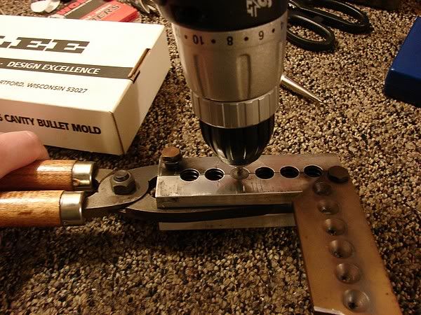

I have had a couple of tumble lube six cavity lee molds over the years. They are a quick way to produce large numbers of cast bullets with minimal labor.
I did not like the lube being all over the bullet, especially the exposed part. The exposed lube attacks dirt. So i now use the traditional bullet mold. The lube groove is covered by the case for a cleaner and neater looking cartridge.
