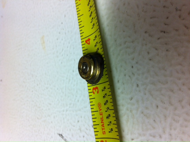

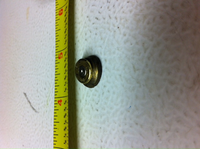

I cannot post pics of the rifle at this time. On the outside I do not see any visible damage to the gun with the exception of the broken extractor and bolt release. However, here is a pic of the portion of the casing that came out gun.
As for the ammo - no not reloads, factory loaded "premium" ammunition.
Sorry, you may have to rotate the pic to see it better

Sorry to hear it and I sure hope you recover 100%! Certainly take many hi resolution photos of the rifle, ammunition and everything else.
If you are interested in the folks here continuing to make wild speculations, please post pictures. (There will also be some insightful observations/thoughts too though).

After viewing the case head pics, this is my guess. Looks like there was no support just ahead of the case web, and the case blew outward into "space" where there should have been a barrel.
Good news, is that if this is indeed the problem, it'll be easy to measure/prove.
Primer doesn't look flattened too much, and the firing pin dimple isn't cratered...looks just like a primer from Federal GMM normally does, having been fired from a Rem700.
Doesn't look like a particularly "high pressure" event took place to me.
