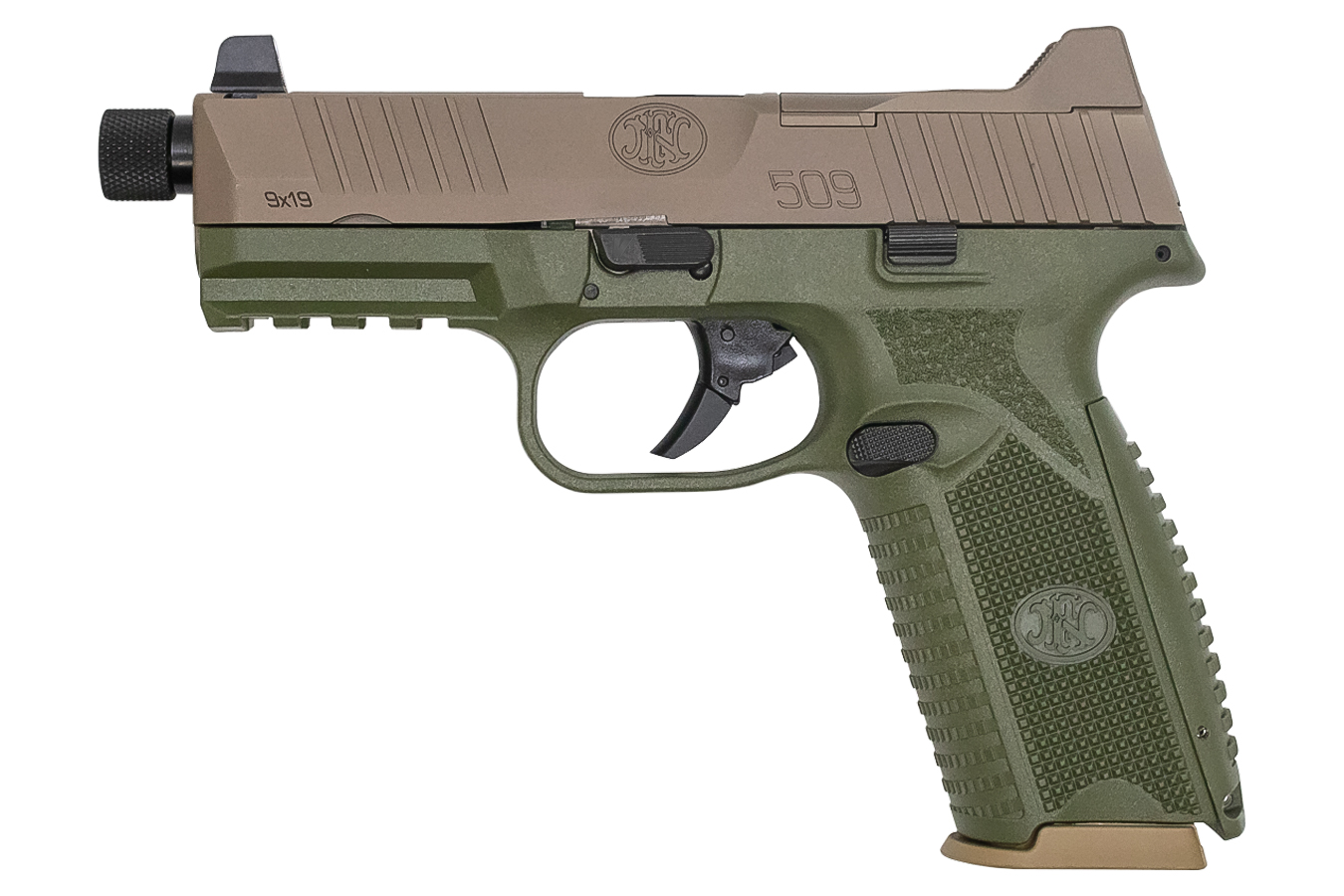

I have had an FN509 Tactical for a little less than 2 years now. It has grown into my favorite striker fired pistol. It really has very little recoil and is more accurate than any other striker fired pistol that I own. I have 975ish rounds through this weapon. Just recently on my last range visit, the slide stopped locking back on an empty mag after firing. I am thinking that maybe it just needs to be cleaned (which I find hard to believe as I only have 230 rounds through it since it's last cleaning), so I'm going to break it down and scrub soon. I was also thinking that maybe I should change out the spring in the upper (comes with 2 springs). After reading the manual, I already have the "softer" yellow spring installed. I'm thinking that the "stiffer" silver spring would only cause the slide to not want to lock back on an empty magazine even more prevalent. These are the only 2 issues I can think of that would be causing the non lock back. Other than something is broken. Anywho, as mentioned above. I will scrub the pistol and not change the spring. If after I clean it and it still fails to lock back, I'll then change the spring. And if that fails to fix the issue, than I am going to figure that something has to be broken. Sound about right? And, did I miss anything in regards to causes to keep a slide from locking back on an empty Magazine?

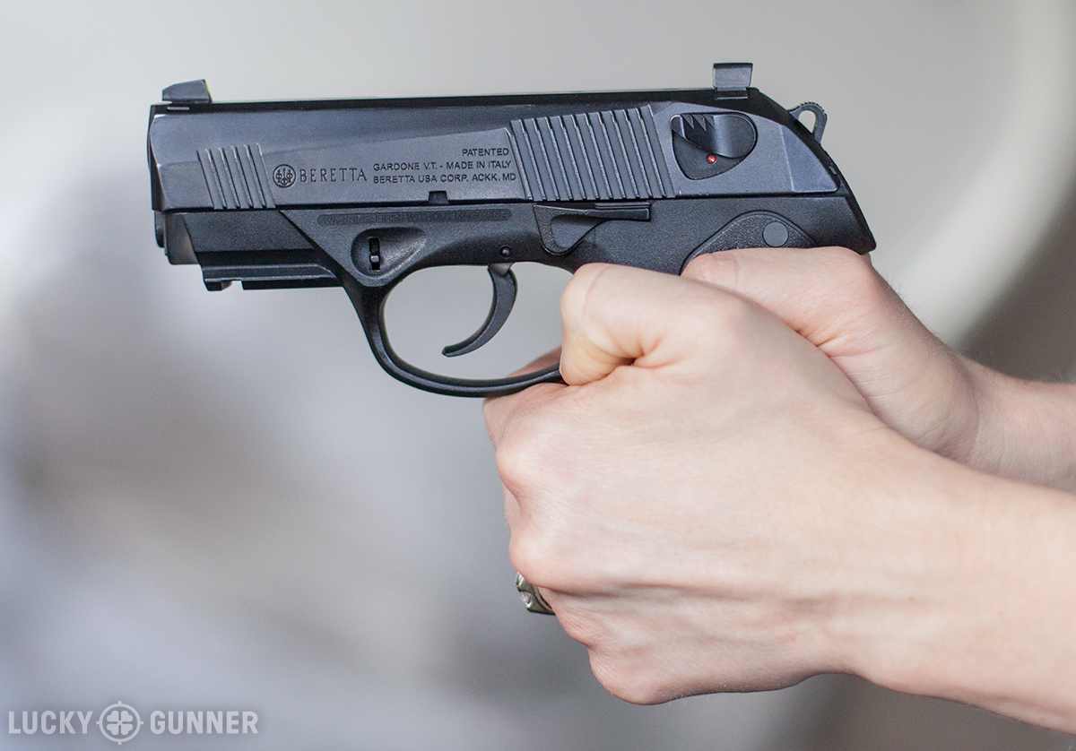

Whatever you do, don't go back to this grip or anything like it
HaHaHa!!! That looks a lot like my old handgun grip. It wasn't that bad, but it wasn't good either. I don't see myself going back to my old grip as the accuracy difference with this new grip is THAT Dramatic!!!
