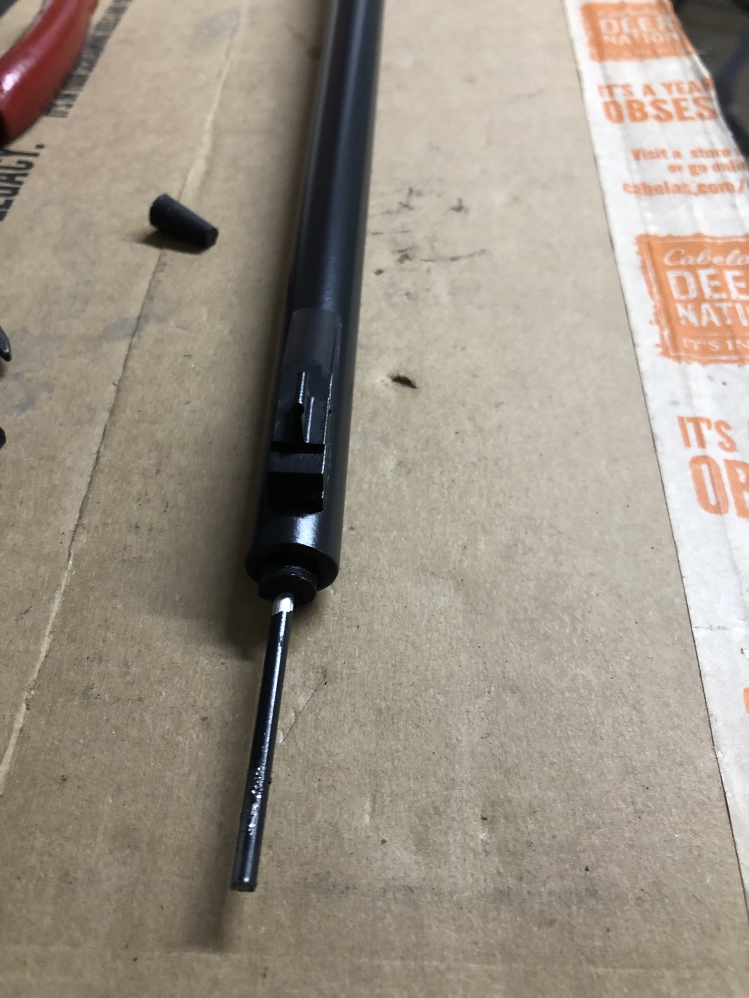

To plug the barrel and chamber end I use rubber/silicone plugs and aluminum welding rod
