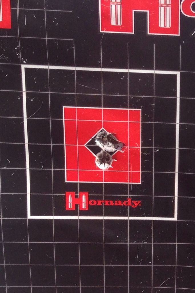

So finally decided to load some 208 AMAX for my GAP 308 which has a 26" Bartlein barrel. I had been hopeful in the CFE223 to get me some decent velocity. I loaded the following
43.1, 43.4, 43.7, 44.0 and 44.3gr all loaded to 2.88" mag length
All groups were subMOA. The 43.1g group produced avg speed of 2501 ft/sec with sub 1/2 MOA group and the 44.0g group produced an avg of 2554 ft/sec with also sub 1/2 MOA. The 44.3g group velocity avg was 2572 but the groups were a little wider could have been me though. I may reload some more at 44.3g and try again. Temperature was 75deg and sea level.
Needless to say I am extremely impressed with this 208 AMAX and CFE223. I did not have any signs if high pressure at all not even at 44.3gr. This bullet going at ~2550 ft/sec kicks the shit out of a 175gr bullet at 2680ft/sec I was getting.
Here is the 44.0gr group picture. This was measured 0.410" center to center

Nice results. Made me go look into this powder as I did not realize it would be good for that heavy bullet in 308.Your measurement looks conservative as it looks close to one bullet diameter center to center to me.

The first two shots were basically same hole. Third shot was a little low. Forgot to mention this was shot using bipod and rear bag. Short of putting the rifle in a rest I think it is impossible to remove shooter error during load developement. Either way I am happy with results
anyone that thinks the CFE223 is not "accurate" or made for heavies is missing out.
