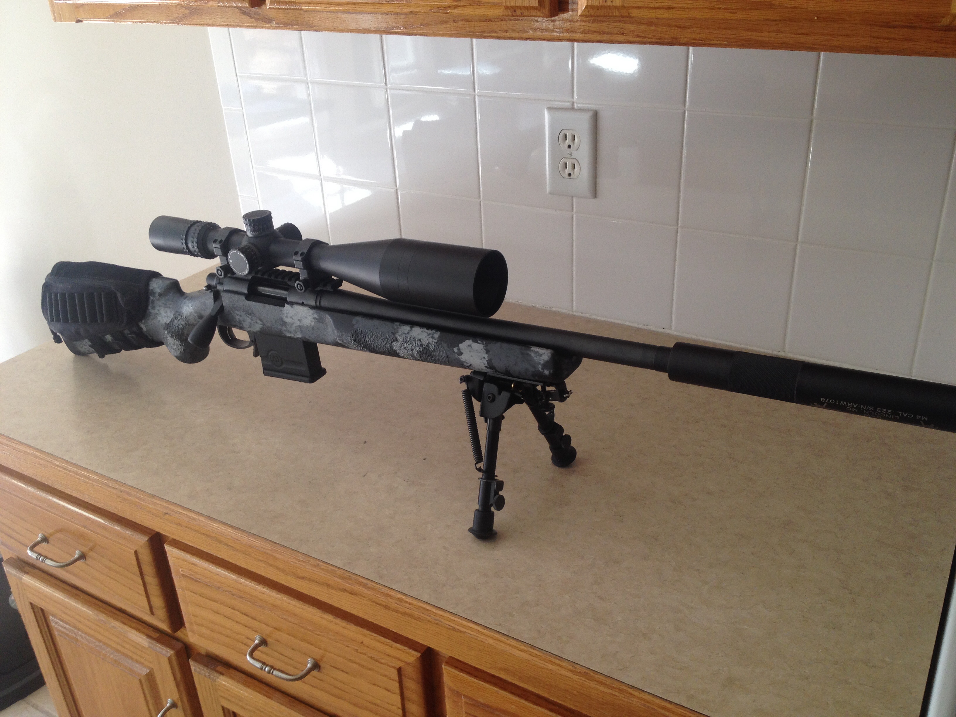

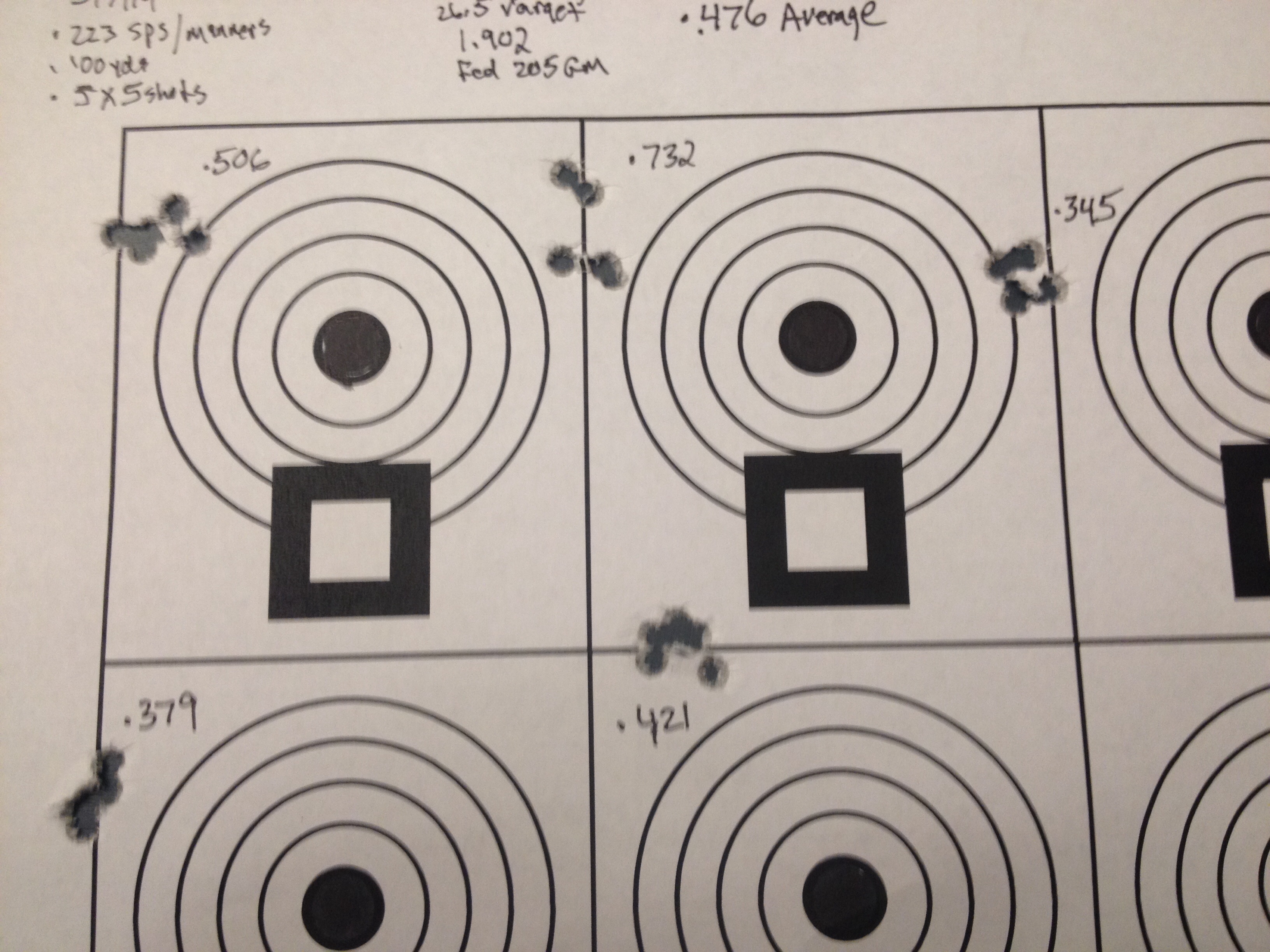

just got mine completely together this week, but the weather and my schedule seem to never cooperate.
stock 700 sps 223 with 20" barrel
Shilen trigger
HS Precision pss stock
PTG bottom metal
Sightron SIII 6-24x50
2 guard , nice stick, what bedding do you have?
Looks like a badger knob ?
Did you do bolt tighting and lap lugs?
Just courious
no bedding, just the hs precision alu block. Bolt knob is from zeffer's weaponry. It is a little thinner in diameter than a badger, about .75" diameter and about 1.5" long for the knob. I was wanting something a little smaller on this build. no lug or bolt work, all factory right now. I will have everything trued up when I rebarrel. I had some combat green duracoat that was getting old and I shot the barreled action and bottom metal with that while I was waiting on the m5 inlet from GAP on the stock, but nothing really special done to it. Shilen trigger is set about 2.5lbs currently. I'm hoping it will like 69 smks with varget. Should be able to get it out this Saturday.
