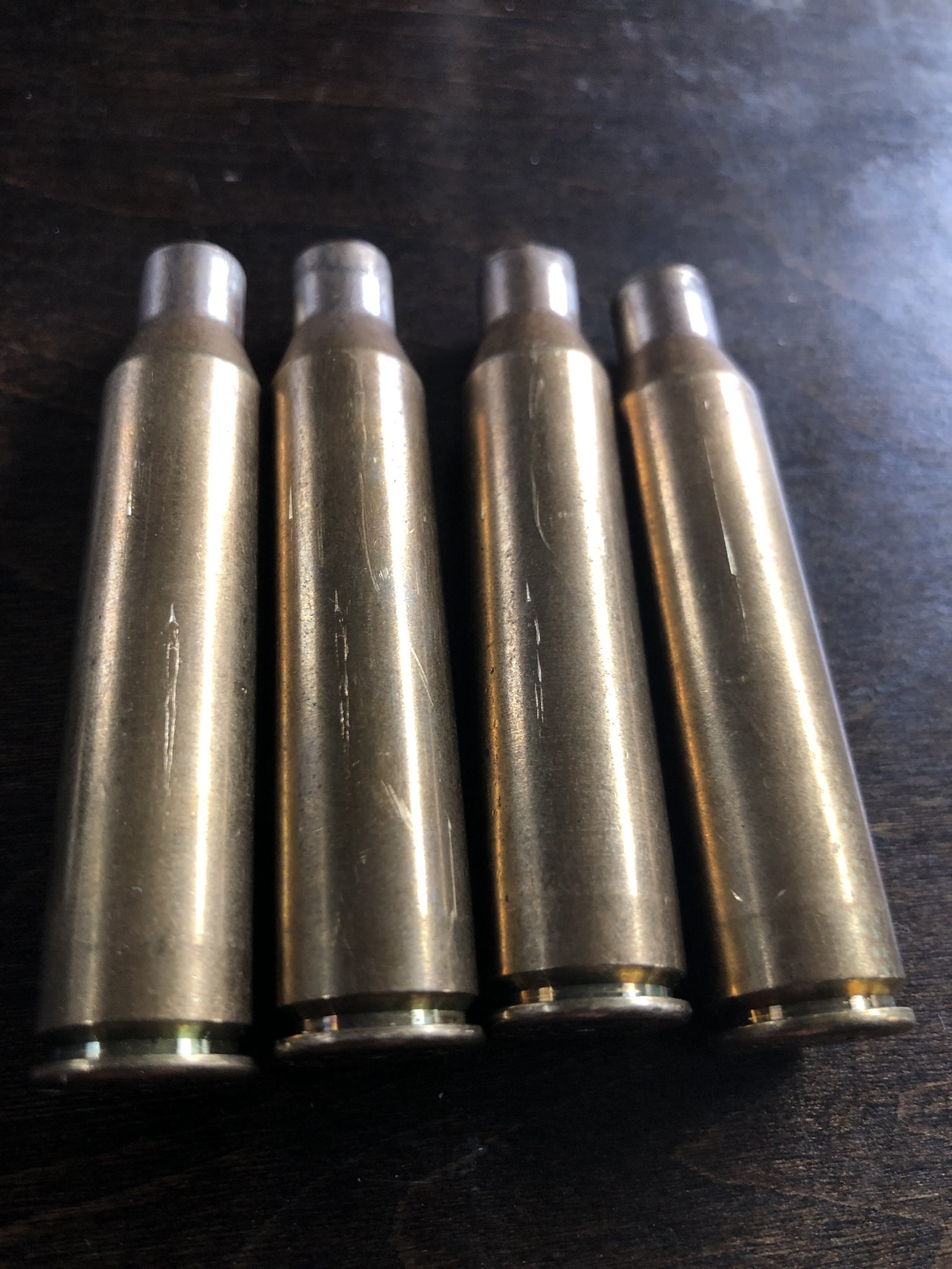

Question for you guys, I have a Savage 110 in 338, the chamber seems to have some burs in it as every round i fire is a pain in the ass to extract, looking at the brass i can see that it is marred from something in the chamber. So the question is does anyone know if there is a chamber hone that I can get?

Be absolutely certain they are not getting scratched while feeding. Slide a few into the chamber by hand, then close the bolt, and see if you still get the scratches.
The problem is (as I understand it) you don't want the chamber to be a polished finish. So be really sure before you start working on the chamber.
i know i don't want a polish finish, needs to be somewhat rough as that is what the case grabs into upon firing (from what i understand), but i need to get the burrs out of the chamber, basically have a single shot rifle now since i can't run the bolt like i should be able to
First what ^ he said hand feed into chamber, fire then carefully remove to check if you still get the marks.
You also need to check if the primary extraction is working properly.
So i just went and was able to freely load and unload an unfired round several times with no issues, so now i am back to square one, i thought it was something in the chamber
