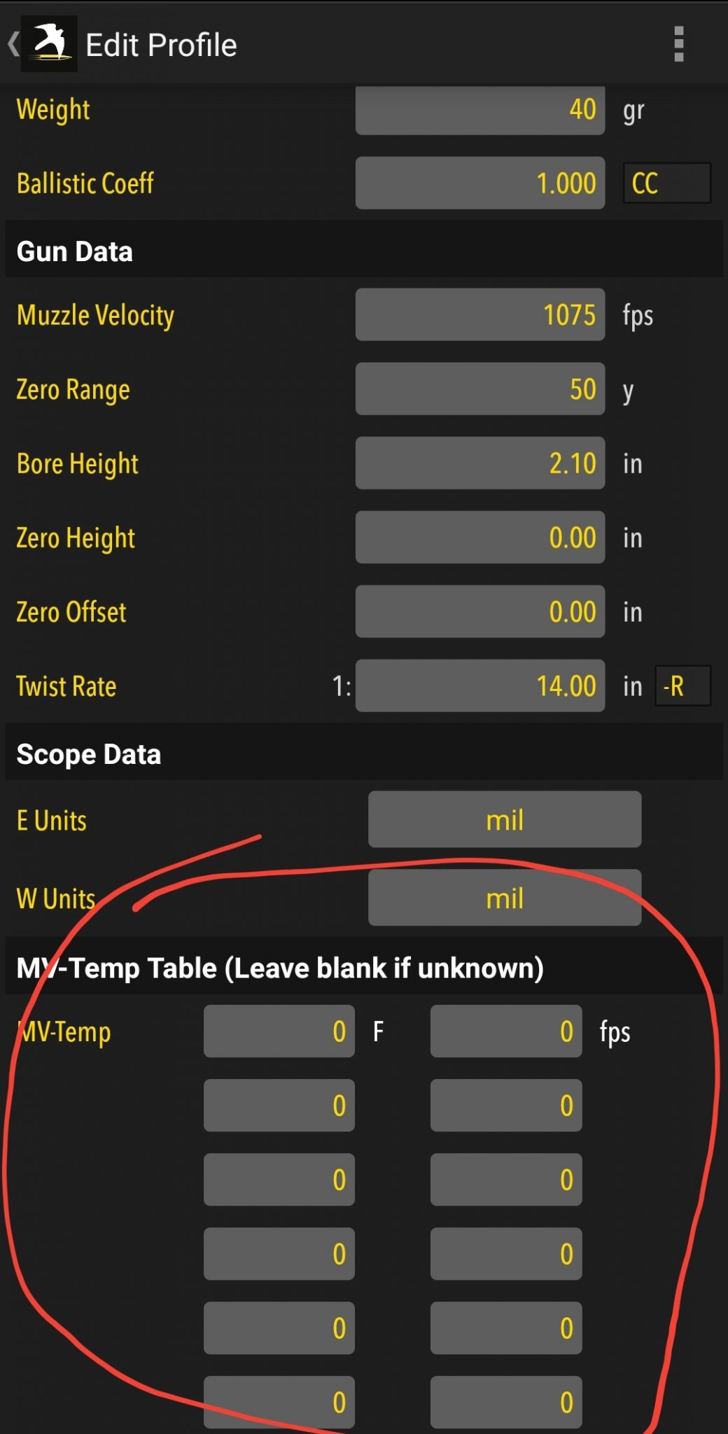

MV temp tables are cool. and in theory work. but this is rimfire. and you're assuming there is no zero shift. even something like where the ammo is stored; ie. on body under coat versus in magazine in gun can make a difference in FPS
the best solution is record MV at different temps and dope the rifle to confirm ballistics. but that's not always possible

I agree with you about reducing variables. I seldom switch ammo brands. My go to ammo is Eley Tenex or Match. It of course varies in velocity. My interest was to see if anyone had compensated for temps by changing AMMO LOTS not brands, bullets, lubes etc.

so with different lots of the same ammo, i havent seen much significant change in zero, mostly changes in group size.
ammo tends to respond pretty similarly to changes in temperature, regardless of lot #, from what ive seen
I agree on a small velocity change at 50Y. At 100Y and a 50 FPS average velocity change can be over an inch in vertical POI.
I also agree that ammo responds in a similar manor over temp range. More so when utilizing the same ammo brand and type. That is why I am considering simply utilizing hotter ammo in colder weather.
My initial question was if anyone has tried this. It was not worth the effort of posting. I will simply do the work and post data in case anyone else cares to read it.
Not sure how to say this. I’m not interested in your ideas other than using ammunition to maintain point of impact in changing temps. And yes 80 FPS is the 8/10 of an inch at 100 yards.
