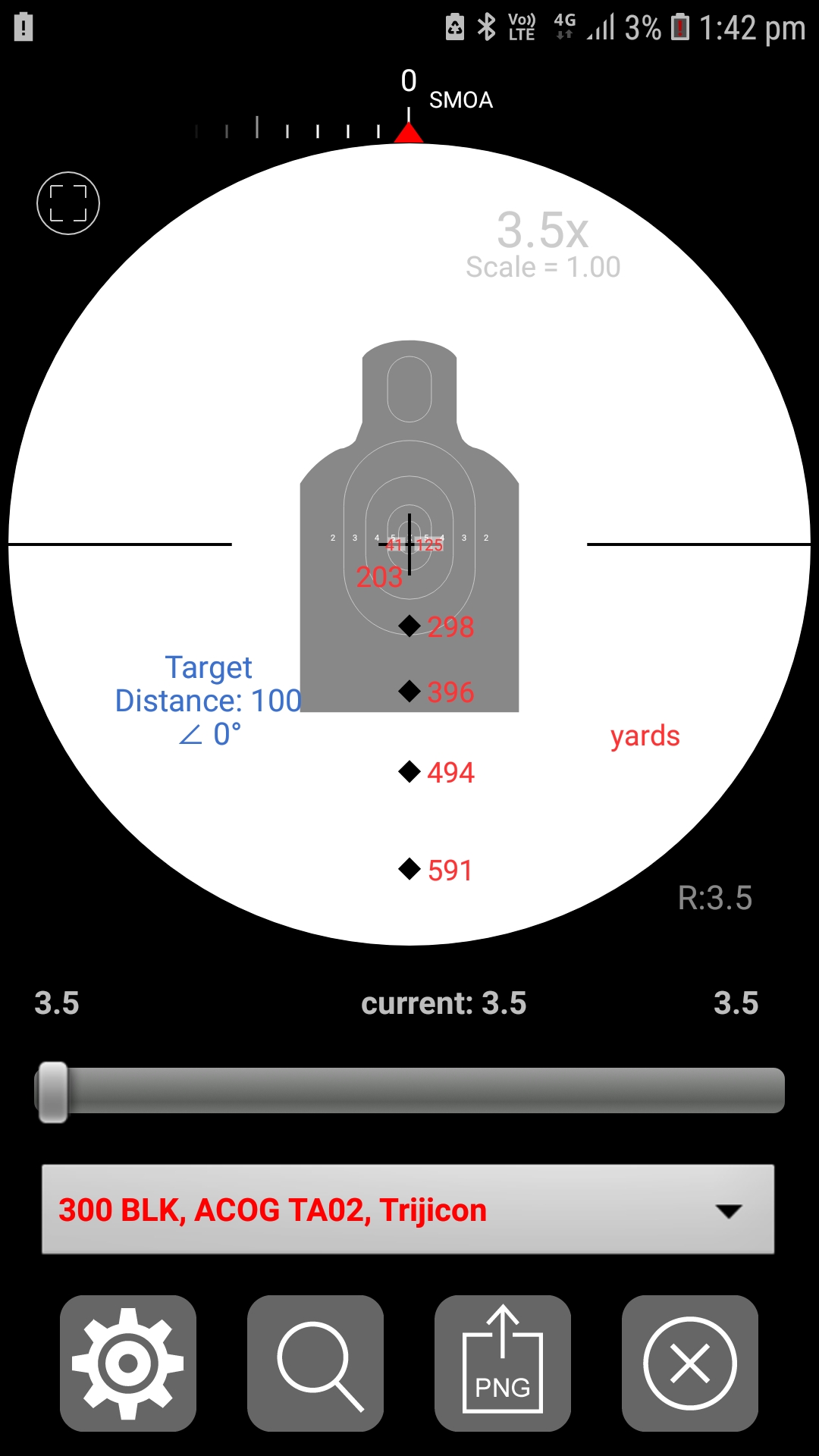

Looking at building a 10" 300 BLK Running a Surfire SOCOM Brake and Suppressor, Maxim Defense PDW Stock.
Before I start down this path, I need to know if it's possible to chase accurate loads with Barnes 110GR TAC-TX around 2300 FPS out of a 10" Barrel? If so what powders are people having success with? I need this velocity range for a 125 yard zero so that the ballistic trajectory will match up with the Trijicon ACOG 3.5x35mm Dual Illuminated 300 BLK Reticle, with shots only being 0.6" high at 100 yards point of aim.
