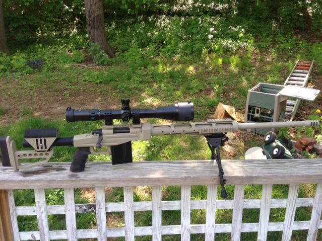

Here's my old XLR. I just used Khaki Krylon Camo from Amazon. I barely did any prep. Just rubbed things down with acetone, then clear coated it. Held up very well.
