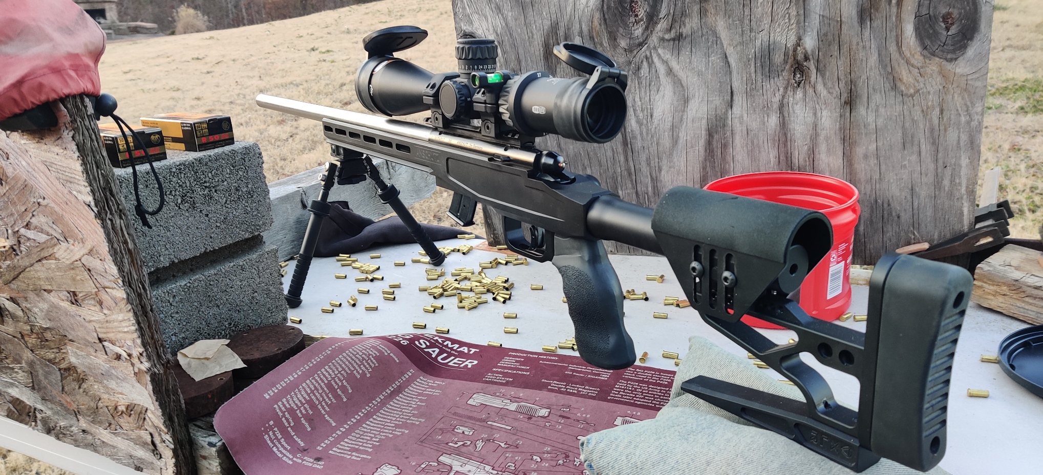

    There may be something out there but the only stocks/chassis I'm aware of are made for the 1710/1712 type repeater actions. Now if you have the same receive bolt pattern the it should work in those. The ones I'm aware of are the one made by XLR for Anschutz and the MDT.

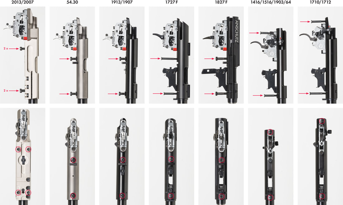

    Bolt pattern is exactly the same for the action that I have, and the repeaters. I have one of them in a McMillan that was inletted for a 54 repeater.

    1710 - 1712 are different than any other bolt patterns. 54 - MSR, Single shot MR and most every other 54 action will not fit the XLR Element 3 nor the MDT. Action bolts are different and the trigger areas are different.ansch-tz-actions_orig.jpg

    1710 - 1712 are different than any other bolt patterns. 54 - MSR, Single shot MR and most every other 54 action will not fit the XLR Element 3 nor the MDT. Action bolts are different and the trigger areas are different.View attachment 7530555
    Echoing what Merlin said and adding to it a little. Pay attention to what action you have and use this as a guide, but note you can add the 18 series (1807, 1813, & 1827B), 54.18 MSR (both single shot and repeater, can be denoted as MS, MSR, or MS-R) of match actions to the 1913/1907 column. Also not the new “match 54“ repeaters fall under the 1710/1712 bolt pattern with the sandwich style recoil lug. Meaning there are some Match 54 repeaters that are the same bolt pattern as the 1907/1913 actions that do not have an action recoil lug but rather a recoil tenon, and there are Match 54 that are completely different.
    Yep, I know this for sure. Most of the Anschutz 54 target rifles have a diameter and pattern that mirrors that of the 54.30 (this one certainly does) That includes the 1413 actions, also - of which mine is one.

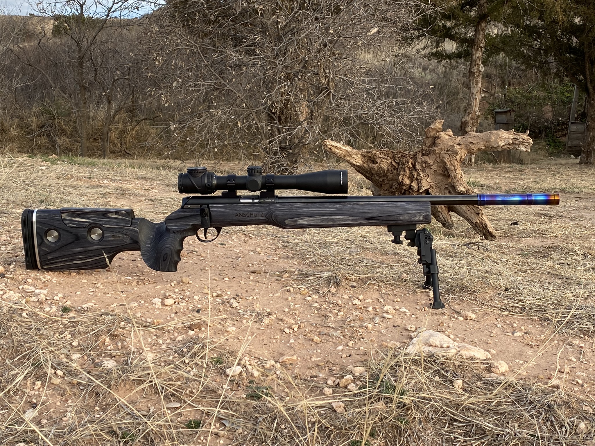

    Another Fortner in a GRS, suppressed with a KG Swarm. I thought I wanted a chassis for it when I got the GRS (also have original walnut stock) but after installing the GRS and more importantly shooting it I am much more than pleased with the GRS.

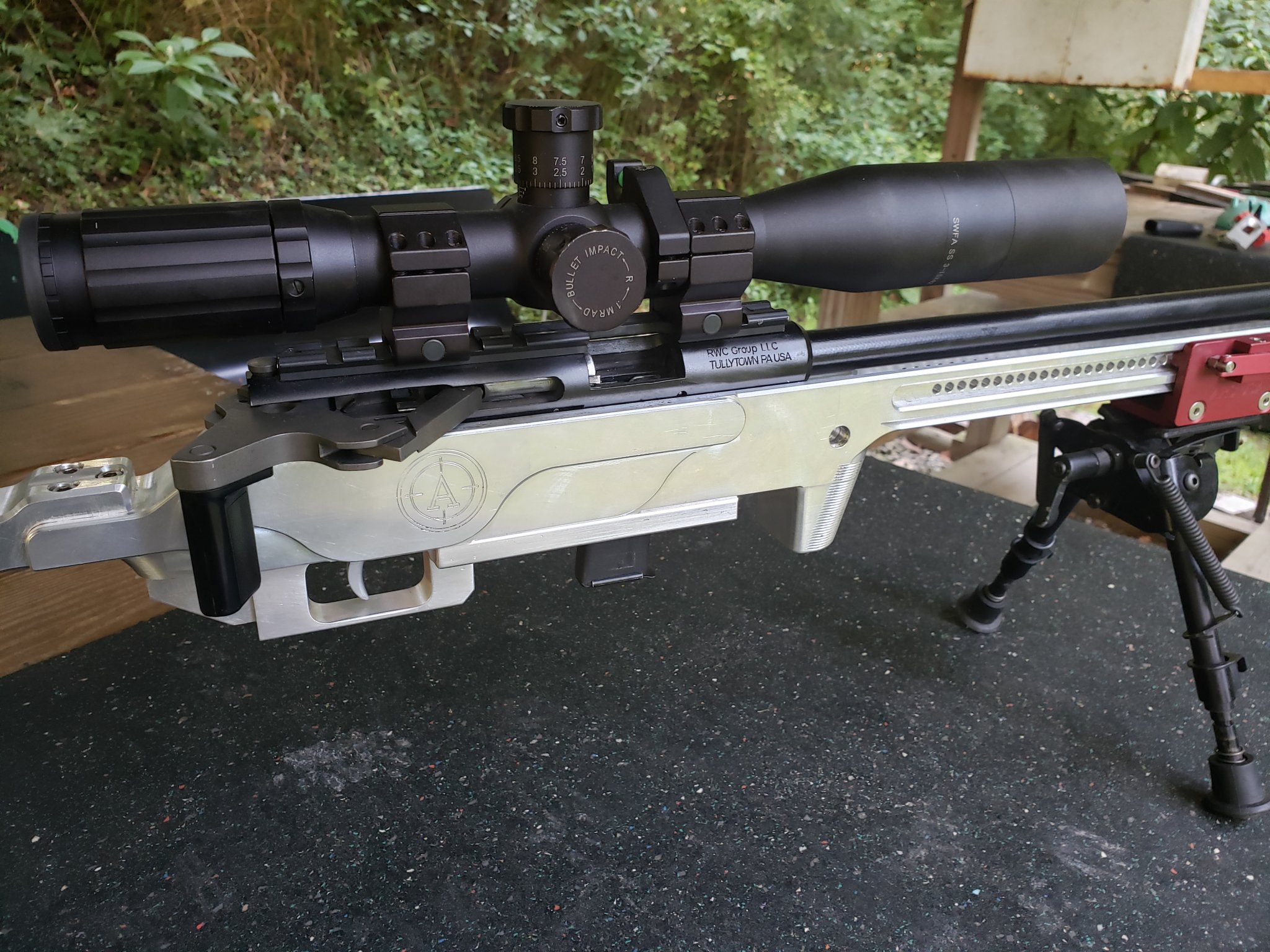

    You might contact Joe at http://www.accurateriflesystems.com/ . He's made quite a few chassis for me including ones for our Izhmash Biathalon guns. He may be interested in inletting for your Anschutz if he doesn't already have it.
    A few versions of chassis designs are available.
