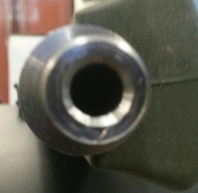

    Here is a picture of the crown before I had it fixed. It looks like someone did it with hands tools. The picture does not do it justice.
    i sent the gun to predator custom shop and they fixed what my local smith messed up and it only took 5 days door to door.
    That's not a crown, its a chamfer with chatter.
    A crown should be burr and chatter free.
    WOW.... I'm gonna say my 7 year old could have done that by hand with a dull 1/2" drill bit
