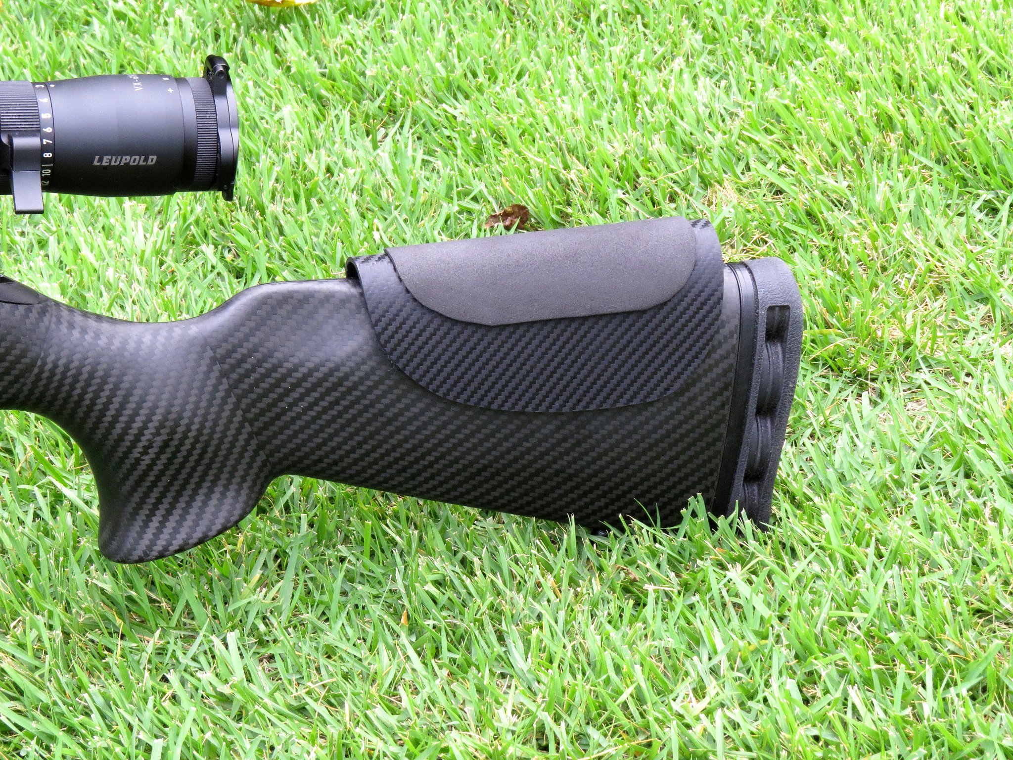

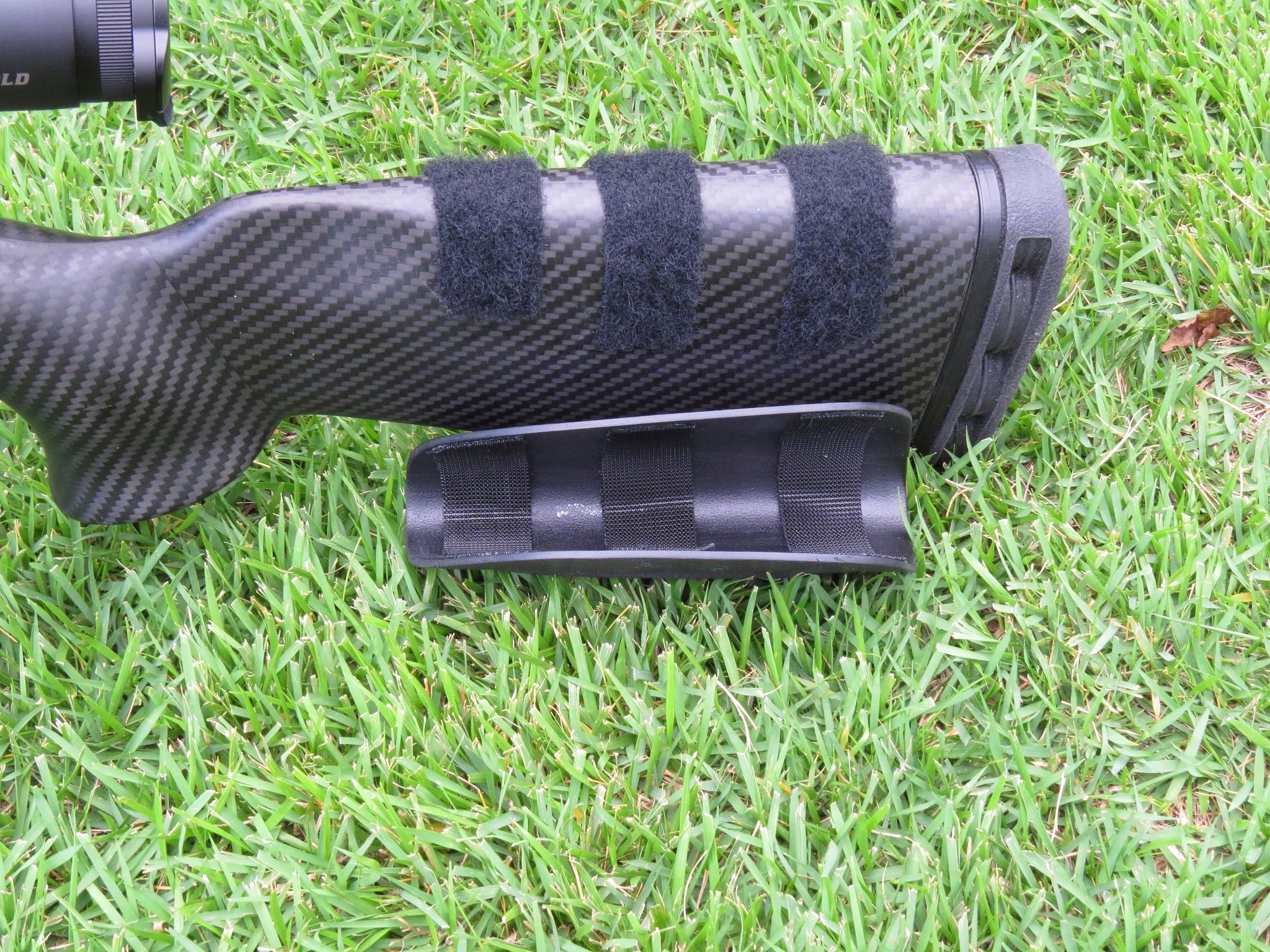

    i made a kydex one and stuck velcro on stock (loop side) and hook side on rest and holds in place perfectly and easy to remove
    I've made several of the Kydex ones using velcro and they work great for me.
