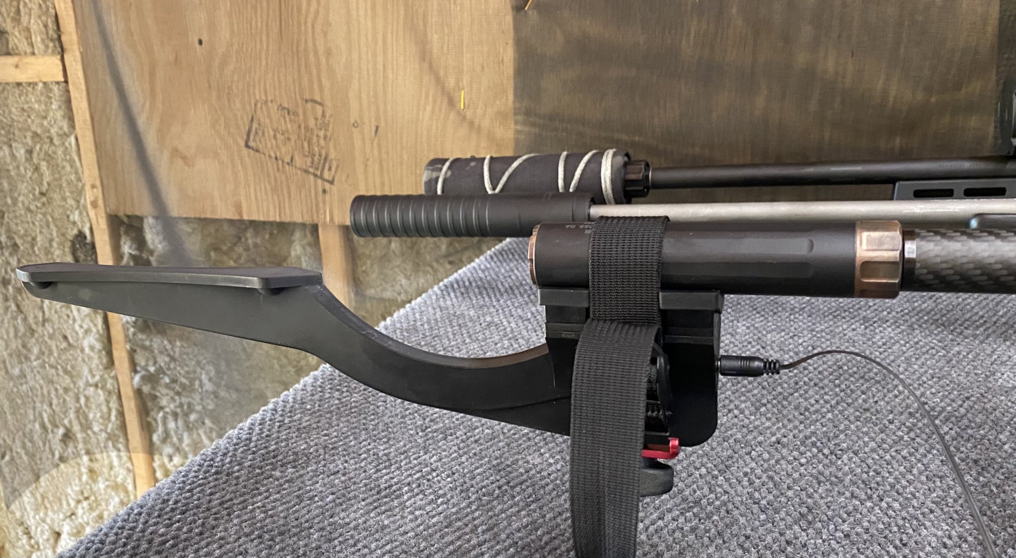

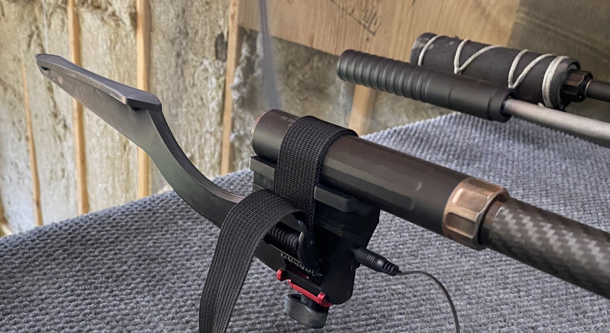

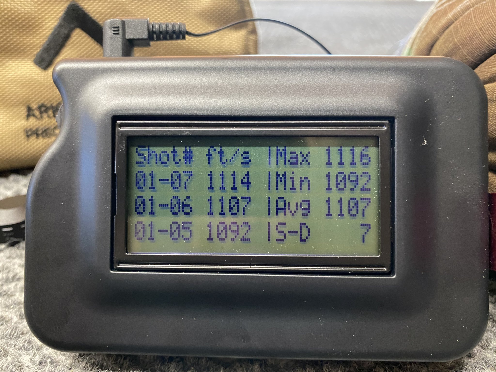

Some recent Velocity testing to find out why my CCI SV goes supersonic in my 18” barrel… Got some answers… It’s average MV is just barely breaking 1100. This was from a 7-shot string.

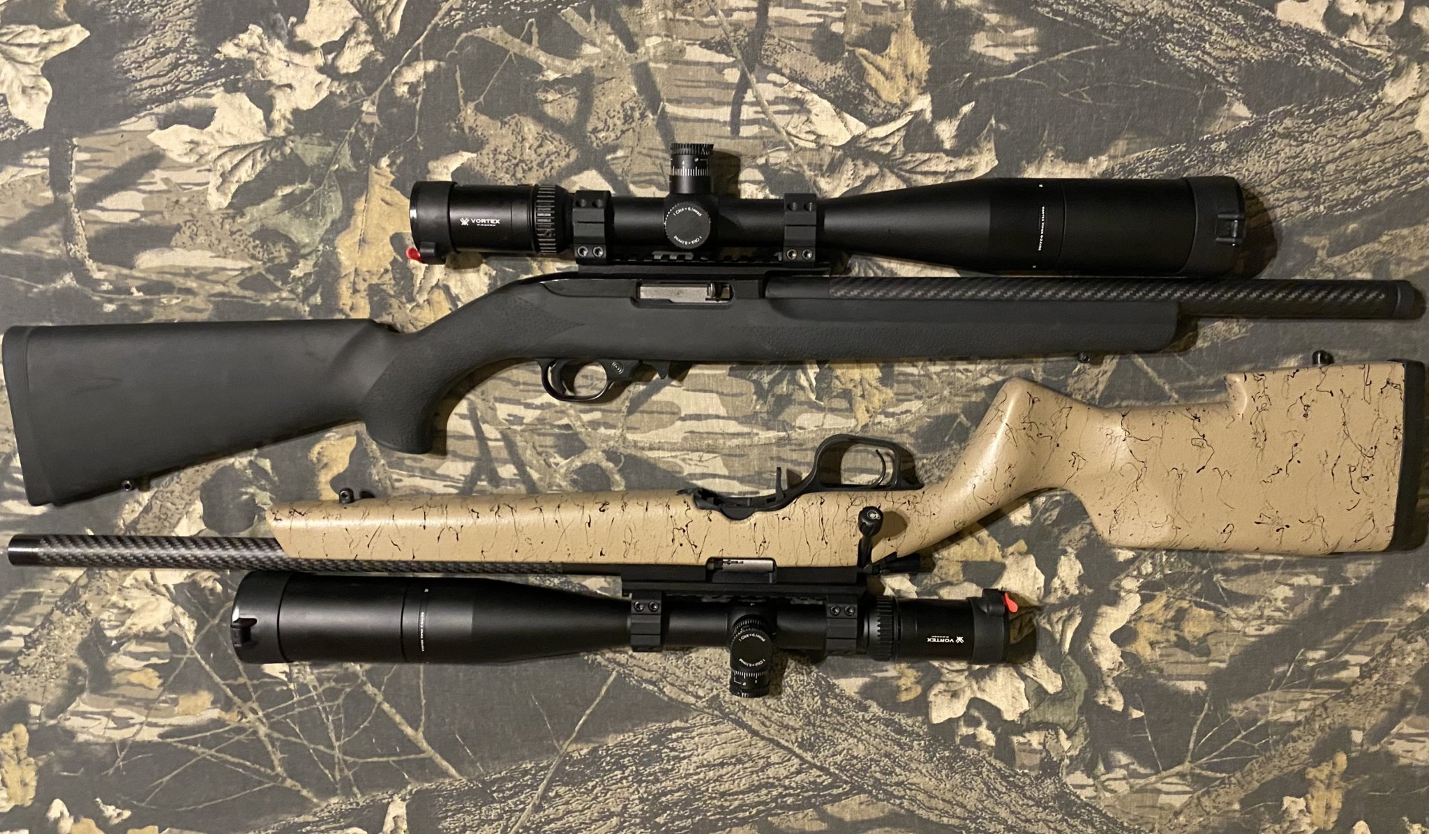

Incase anyone is wondering, the ultrasonic cleaner stripped the finish on my Mask HD mount and end cap. Looks kinda cool, but I’d rather It be black again. I’ll get it cerakoted again. Probably just send the whole thing into Dead Air and get the whole can refinished. Might end up doing it in FDE with black mounts and end cap. That would look pretty cool. 😏

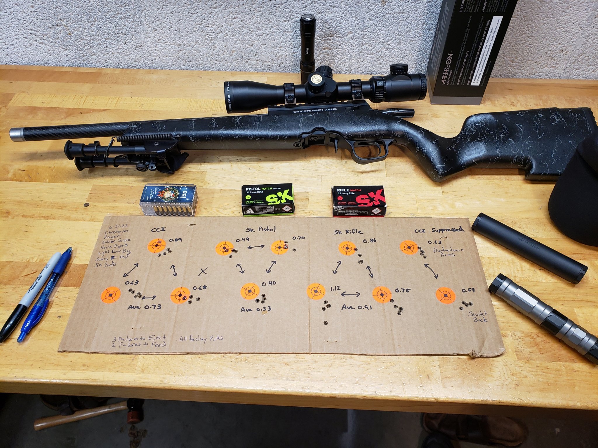

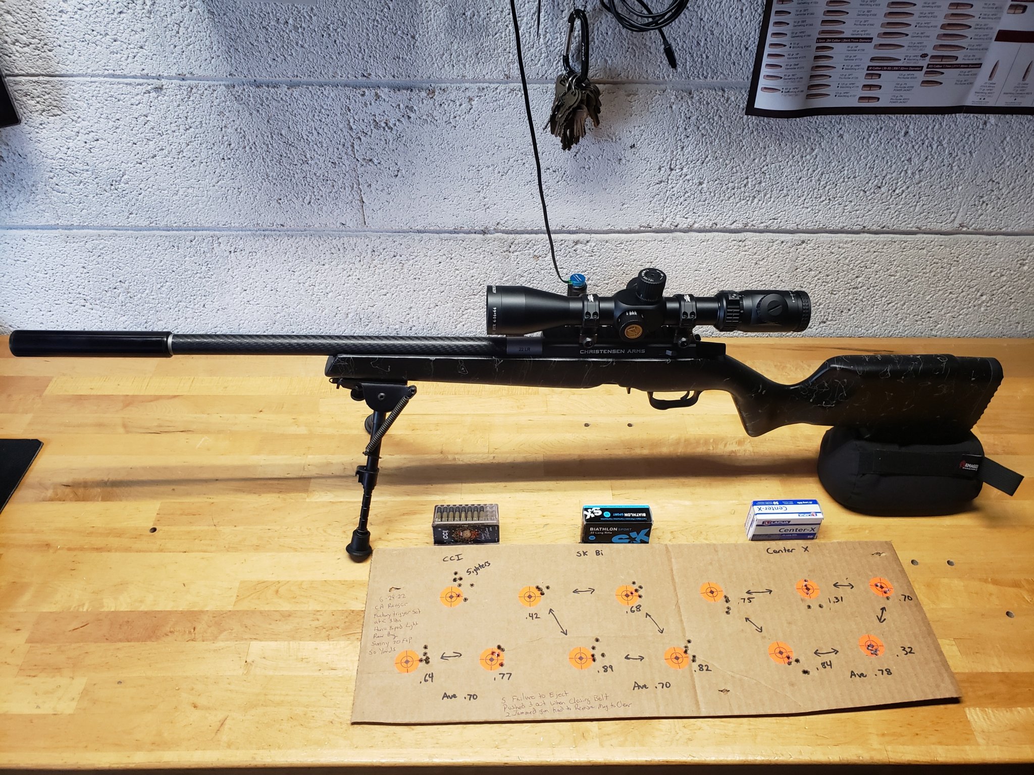

Took my Ranger 22 to the range today (like always)… It’s fun and cheap to shoot, so it always goes with me to plink with while the cans and centerfires cool down between groups. 👍🏼

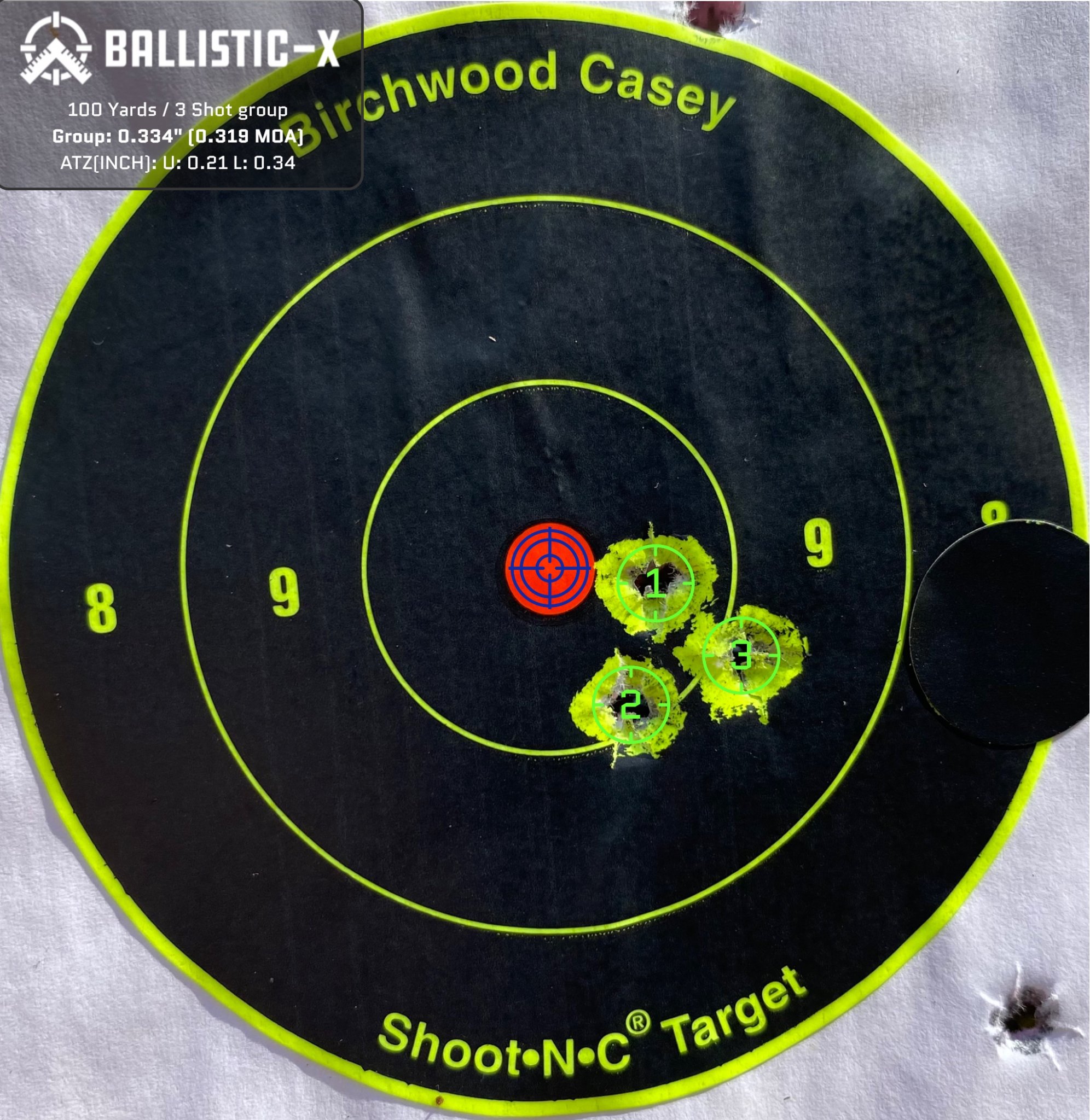

Put down a nice .334” 3-shot group @ 100 yards with CCI SV…
Can you do a 5 shot group at 50 or 100?
I don’t shoot at 50 yards. But I can do a 5-shot group at 100 next time.
Bulk-pack ammo is not very consistent, and has a severe propensity for flyers due to Velocity swings from not being as precise as say, Eley match ammo or SK. Which is why I tend to only shoot 3-shot groups with bulk-pack .22 ammo.
But, I’ll do a 5-shot group next time I’m at the range.

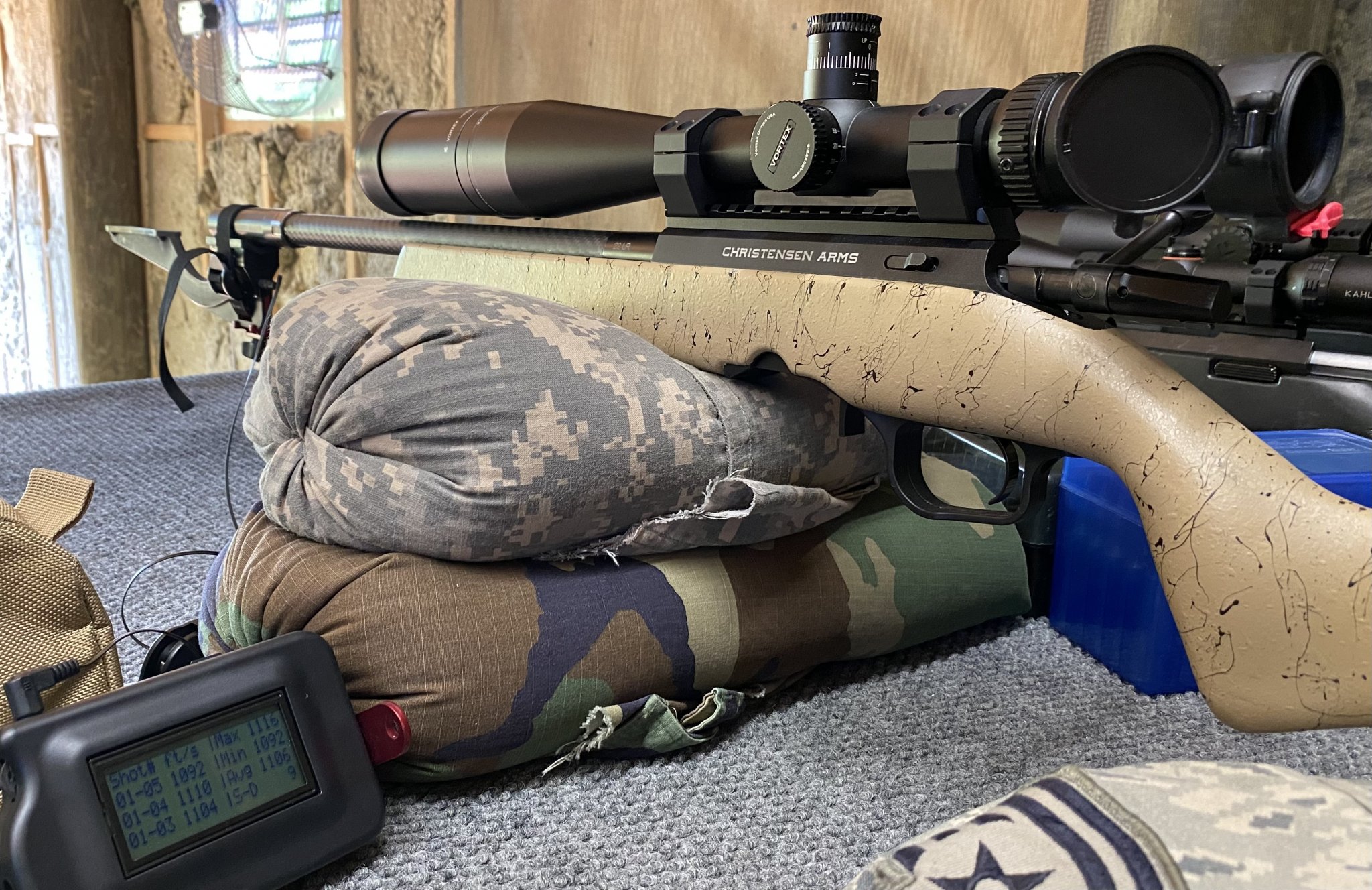

It was rainy here today so I figured I'd sneak out to the range as no one else would be dumb enough to go out there. I took a 25 round mag and boy did I have problems! First fte was about 3 rounds in. I dropped mag to clear, when I tried putting the mag back in the gun the mag release/catch was stuck. Well I wasn't taking home a loaded mag so I held the mag in the gun by hand and fired off the rest of rounds. Getting close to finishing the mag off I heard the catch pop back into place so I reloaded the mag and took this video after having more issues. I think my problem was the mag. The ejector in the trigger frame is about useless. The empty has to eject off the mag and this 25 rounder was a no go once I was not holding it up into the gun while the mag catch got stuck. I took apart the CA mag catch; its a thinner squared off frame compared to a ruger trigger group. I rounded the mag catch and inside of trigger housing and can no longer get the catch/latch to stick. Before when pushing the release very hard (probably pissed about a jam) it would get stuck every time. My gun is A4 serial #. Just bought it last month but have no idea how long the shop has had it in stock. I know they said they had a few more after I bought this one

I went to the range again today and took a selection of 10 round ruger mags. They are definitely not all made equally. I tried several with varying results, even one that I could barely get to lock in place it was so tight. I have a set I use in a 1022 for steel challenge matches that I have worked on and are very reliable. The one I tested today in the Ranger ejected 100% of the rounds I fired from it. I captured a few slow mo videos of the ranger ejecting off the mag just like the 1022. With a good mag I could open the bolt very slowly or fast and get good ejection, with no mag the empty stayed stuck to the bolt and putting the empty mag back in it ejected. I imagine I could fiddle around with a 15 or 25 rounder to get it to fit into the gun correctly and eject reliably.

Nice slow-no footage. Your tests make me wonder if a lot of folks were just simply having magazine related issues with the election problems, and not necessarily rifle issues… 🤔
I’ve used the brand new production Ruger 10/22 mag that came with it, and my 20 year old original Ruger 10/22 mags that have been ticking along for over 2 decades now, even a few older Butler Creek HotLips 30-rounders, and an old discontinued Ramline double-stack 30 rounder that I love. I wish I could find some NOS ones sitting in an old mom & pop shop somewhere.

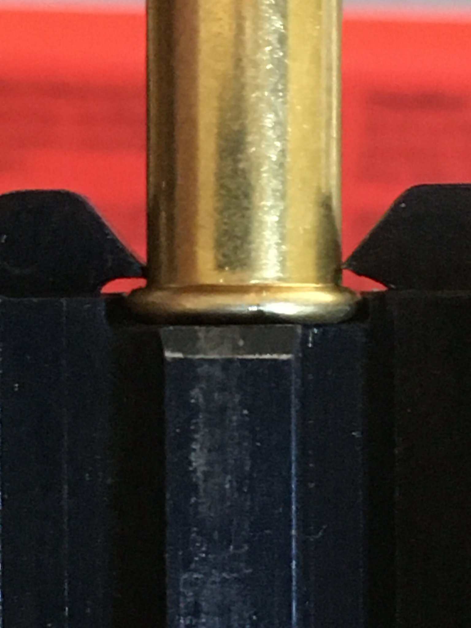

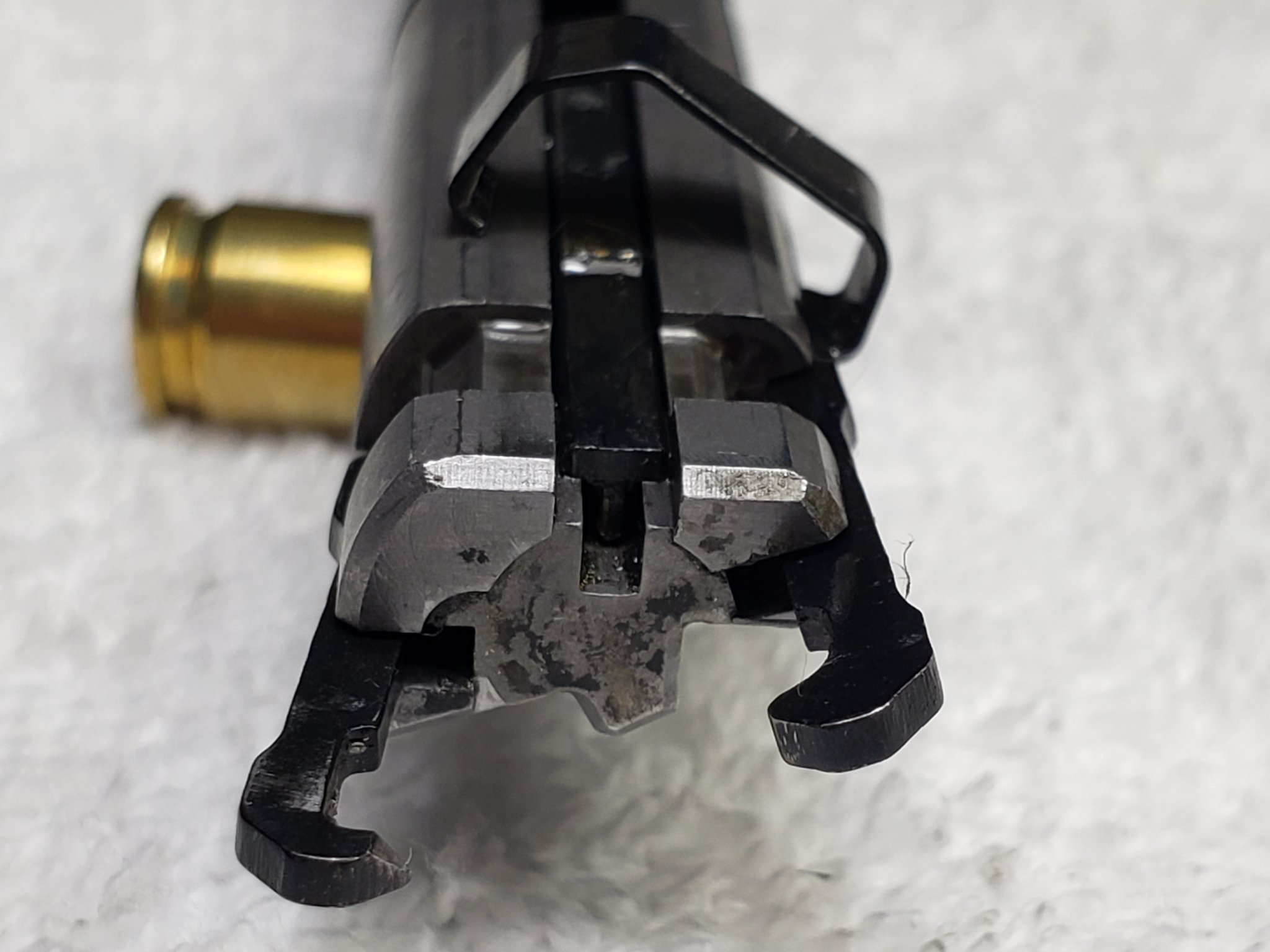

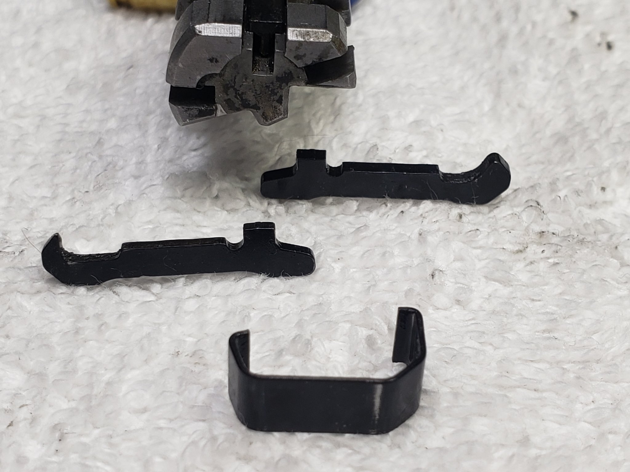

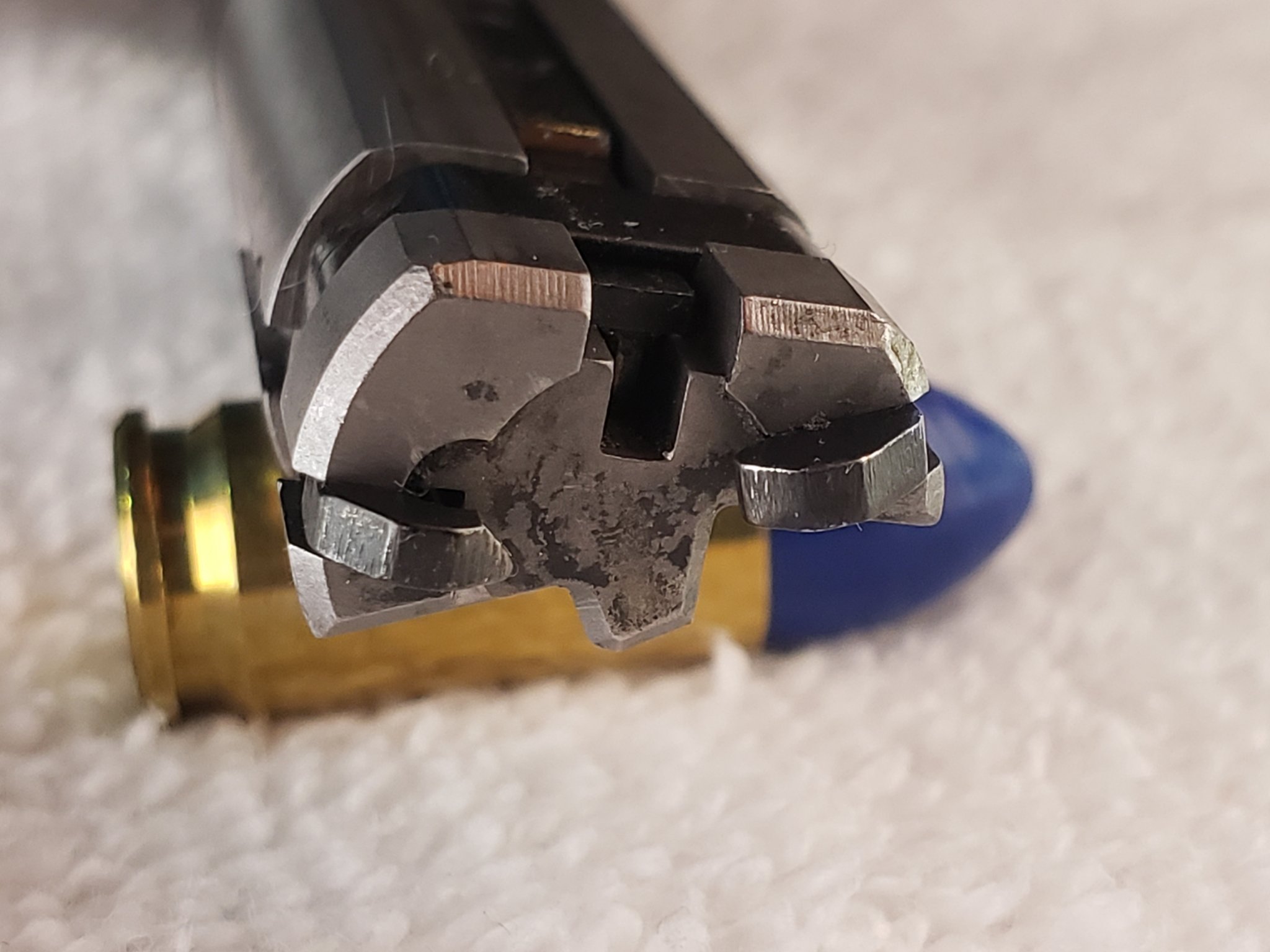

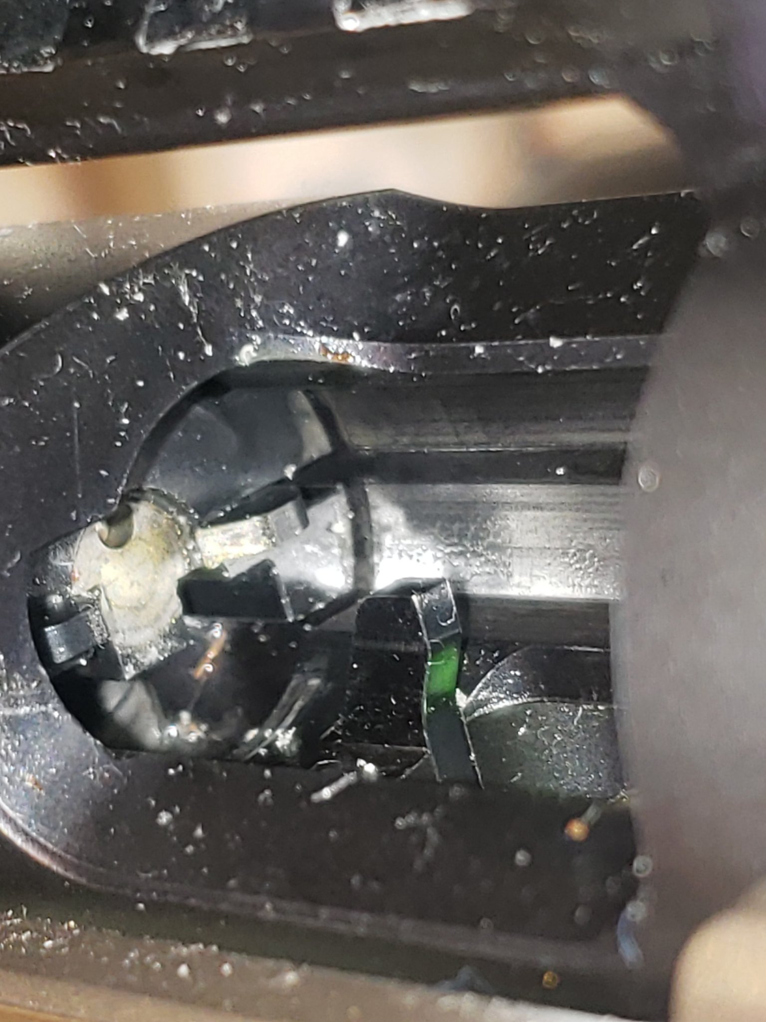

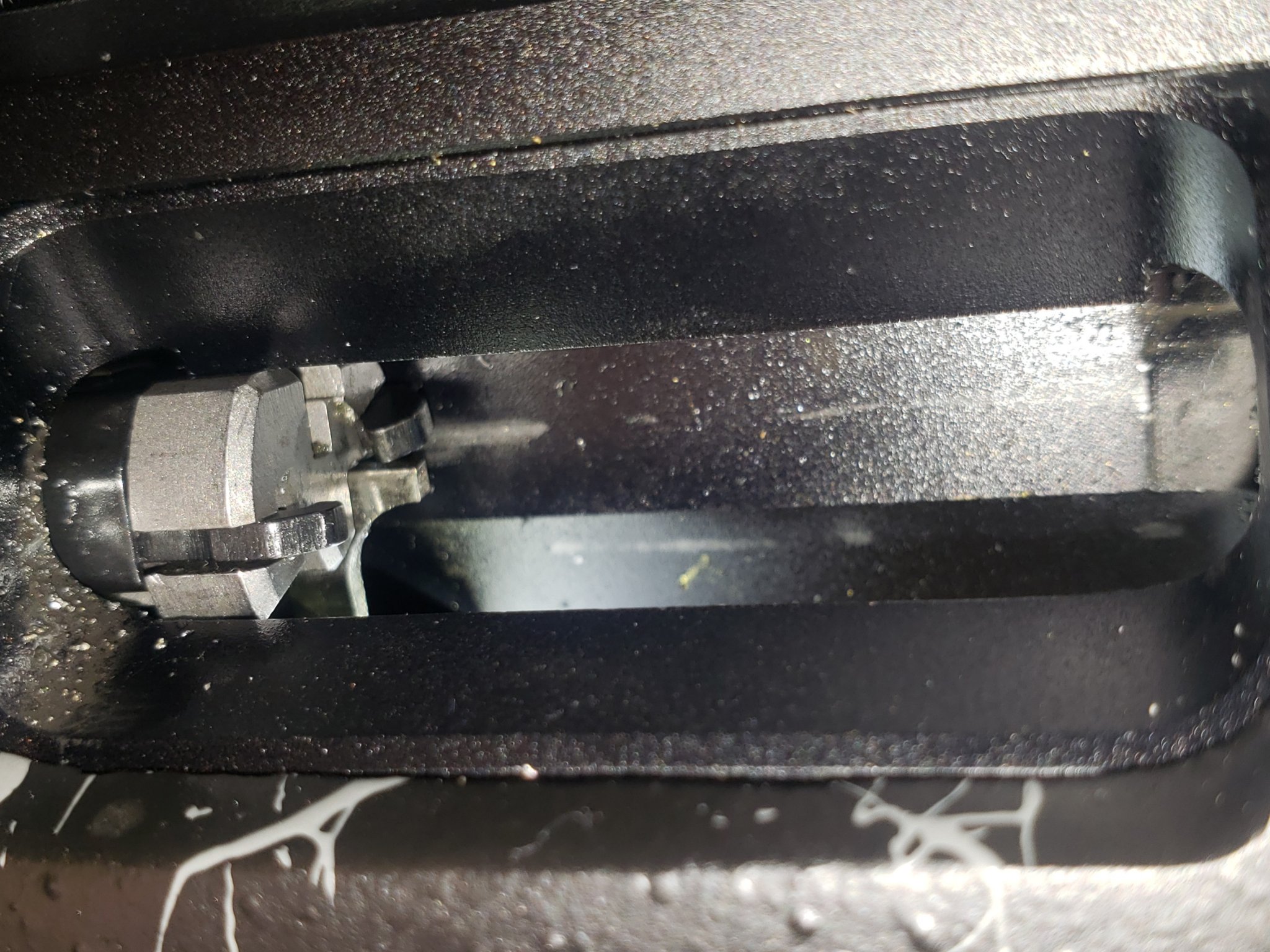

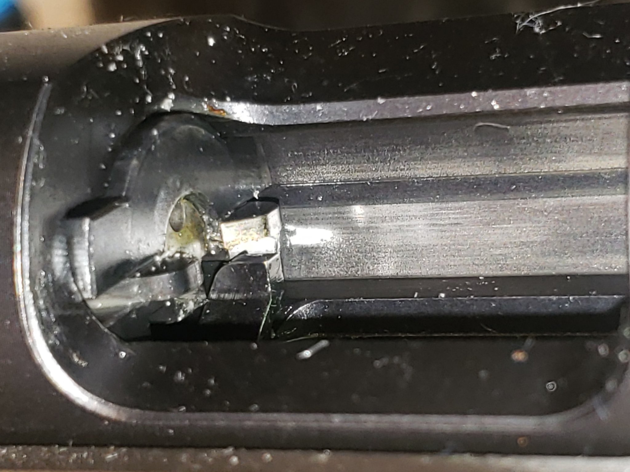

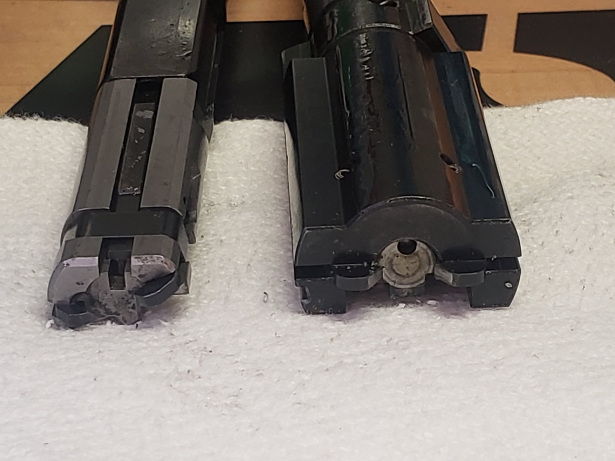

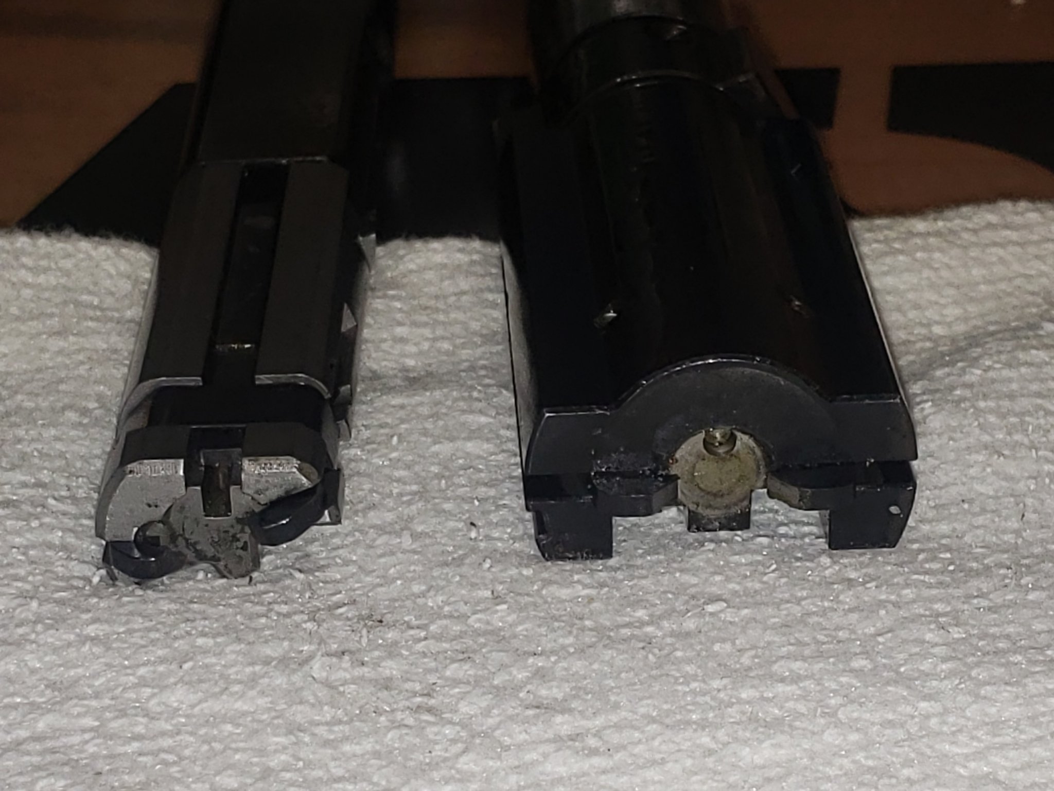

Any chance you have close-ups of your bolt face and extractors?
Kind of strange or innovative extractor design. No pins or coil springs or plunger pins. Just a spring clip that holds everything together.
Make sure you clean all that good, and keep it clean... I noticed some grease gunk in mine when it was brand new, and I pulled it apart and cleaned the whole bolt and rifle before shooting it, and then put it all back together and torqued the action screws to 35 inch-pounds (per manual spec), and mine has been perfect in thousands of rounds. I shoot 100-250 rounds through it nearly every weekend, or every other weekend, at the very minimum. Not a single issue.
Not particularly strange, that spring-clip construction is extremely common in bolt-action rimfires. Savage, Marlin, CZ, Ruger, Anschutz (64-action) and many others are built similarly. The really interesting part is as you noted, no coil springs. I can only think of a couple old guns like that, not sure if any current-production rifles besides the Ranger are made this way.
Hmmm, I don’t see anything glaringly obvious.
I’d lube the parts with EP Molybdenum Disulfide grease during assembly. Then, since the bolts out of the gun, slide a fired case rim up in the bolt face. The extractors should retain it very well, without any sideways rocking.
This pic is the bottom of my Bergara’s bolt, obviously there is a lot of gap between the hook and case rim. While this isn’t ideal, thus far it hasn’t “caused” issues, but I haven’t used a wide variety of ammo in this rifle either.
Does the other ejector (not the mags) ride firmly up (in it’s groove) in the bottom of the bolt?
Does it ever skip passed the case rim?

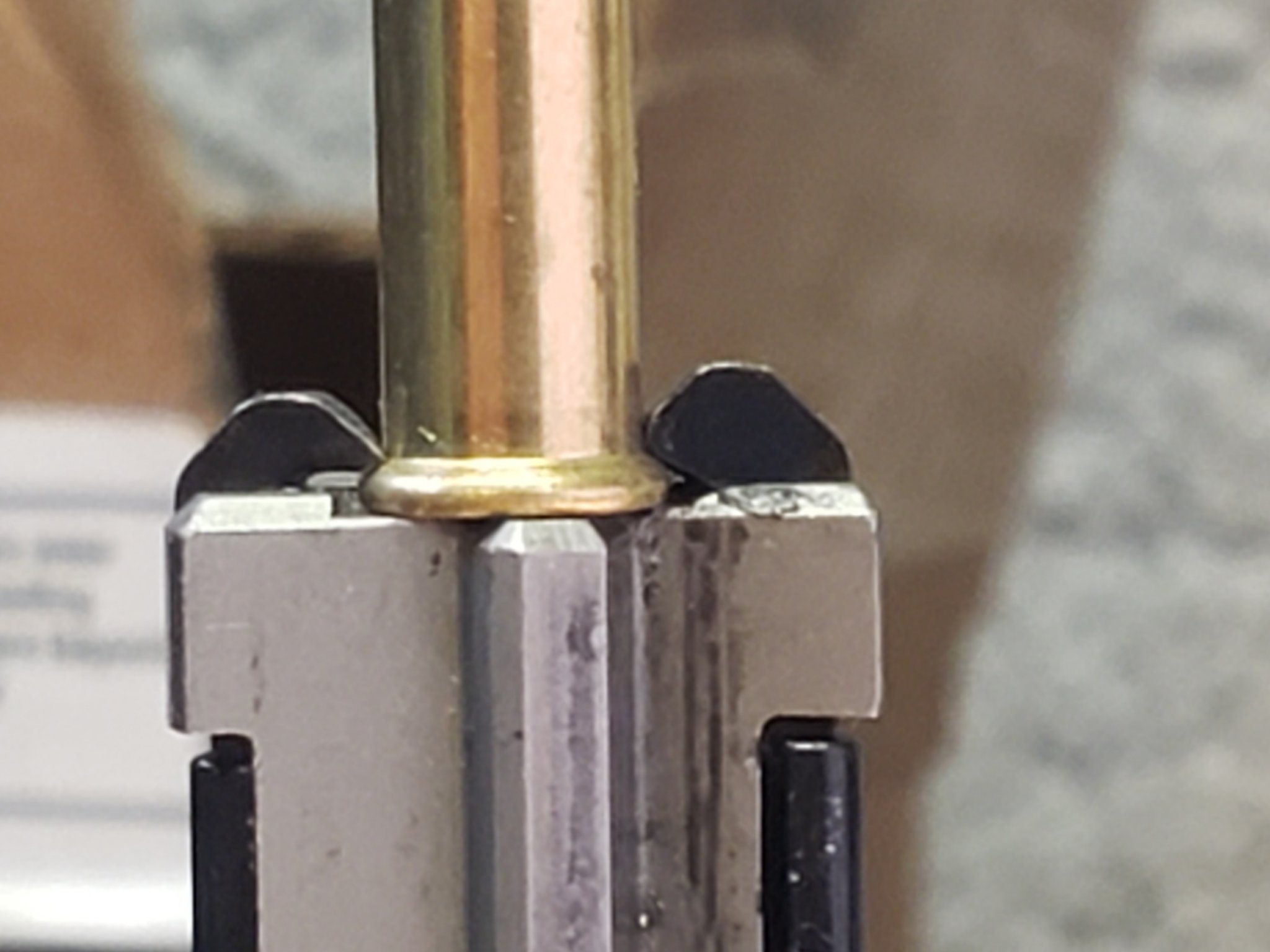

You guys made me think about the Bergara extractor ejector relationship. The Christensen ejector barley goes reward past the frame mounted ejector. Look at the Bergara. I stopped the bolt in about the same place as the Christensen then moved it all the way to the end of its travel. Probably an additional 1/2" of reward travel past the ejector

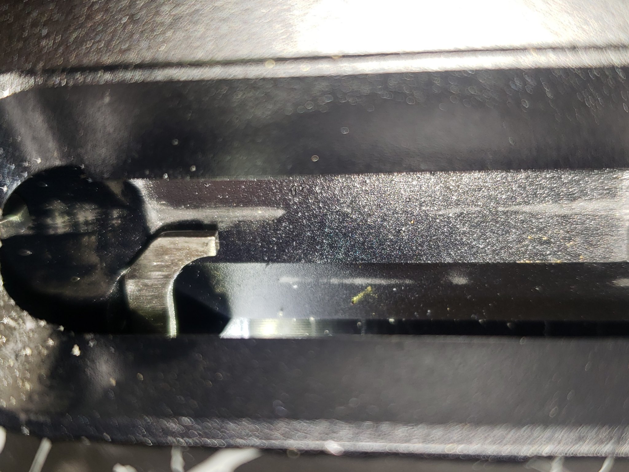

This gun has extracted 100%. The mag is the only functioning ejector. In slow mo vid I did an ejection attempt without the mag you can see the empty wiggle hitting frame mounted ejector but both extractors keep holding. With a mag that is sitting in the correct position/relationship to the bolt, the mag does the ejection the gun runs perfectly. It's like the frame mounted ejector needs more bolt travel to make it let go of the bolt face. See pics of frame ejector only, with bolt sitting on top of ejector and how the exactors hold a rim.

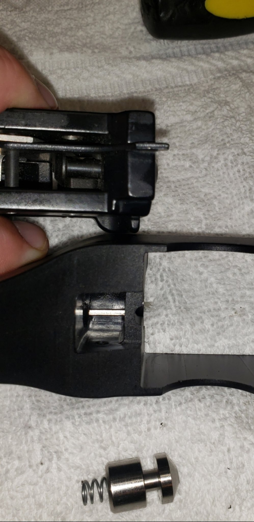

Actually, there's an ejector built into the stock... If you haven't removed your action from the stock, you wouldn't even know it was there. It's a 10/22 style ejector, but this one is glued in the stock, whereas the 10/22 it's in the receiver.

Great pics, but I’m still stumped.
That ejector should really be kicking the case free, there’s something wrong with the geometry.
If extractors are readily available, I think I’d be experimenting with a different shape on the left one.
The contact is too wide allowing the case to twist rather than snap free.
