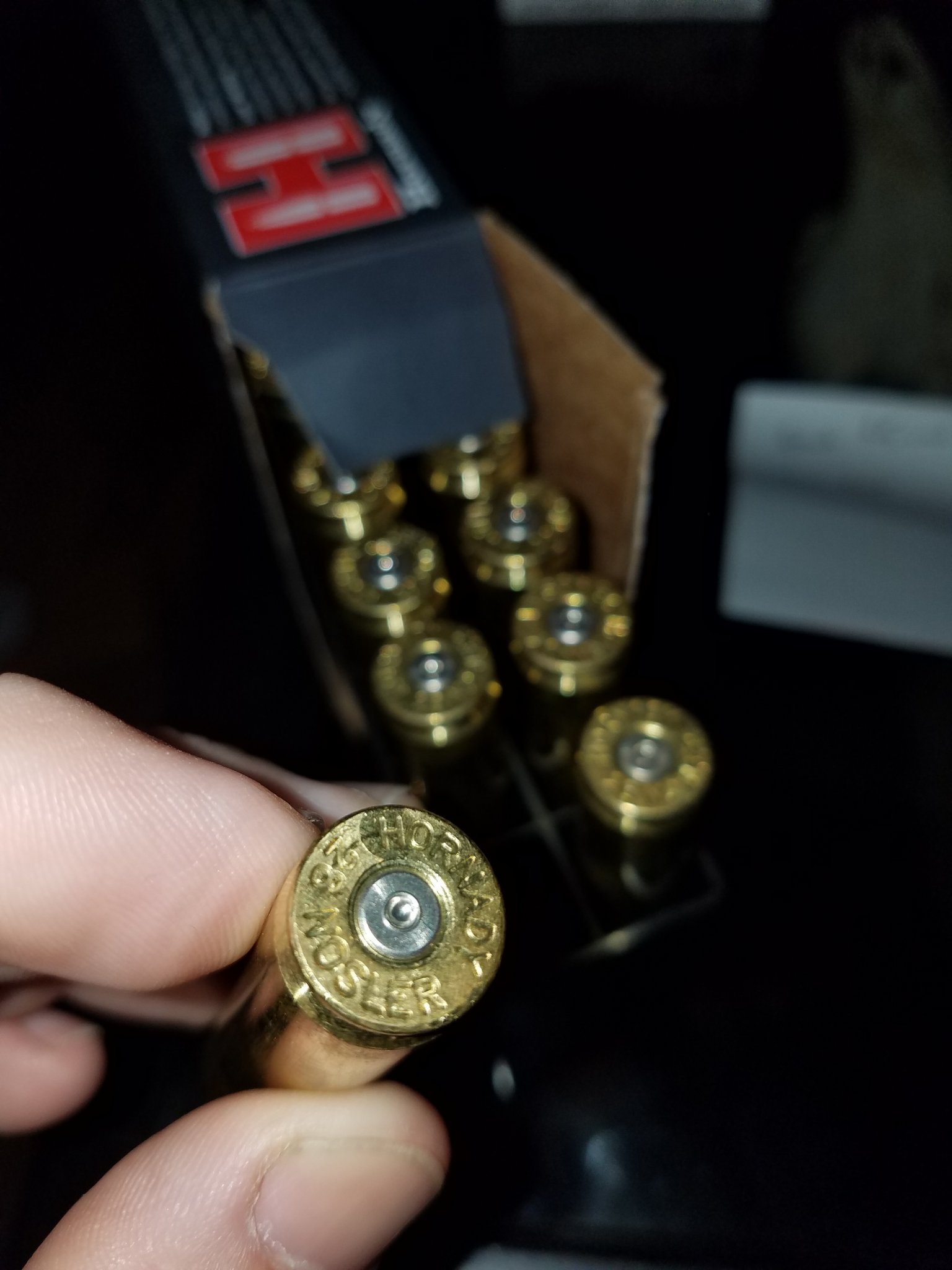

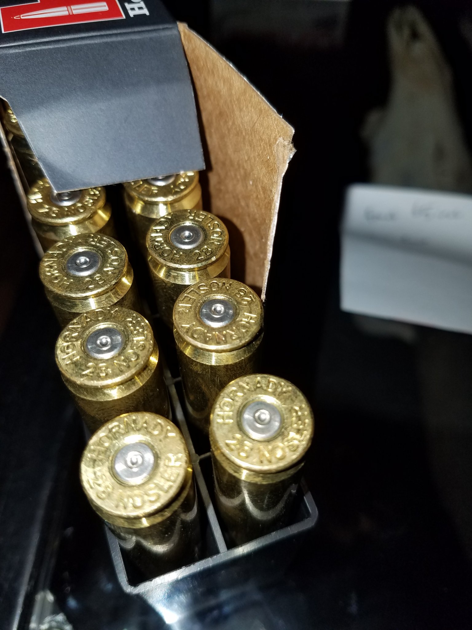

Was going through my spent brass from factory loads and found this on every single one... there were some sticky bolts but not all the time...
You can also clearly see plunger marks on the brass..
Rifle only has about 50 rounds through it.
What are your thoughts?

judging by these pictures, would you say its anything to worry about??
if there were or if I start to get funny marks on the bullets, what would that indicate??
The scratches would be a carbon ring that's built up. And just looking at them, it doesn't look like its way over-pressured, so its probably alright.
