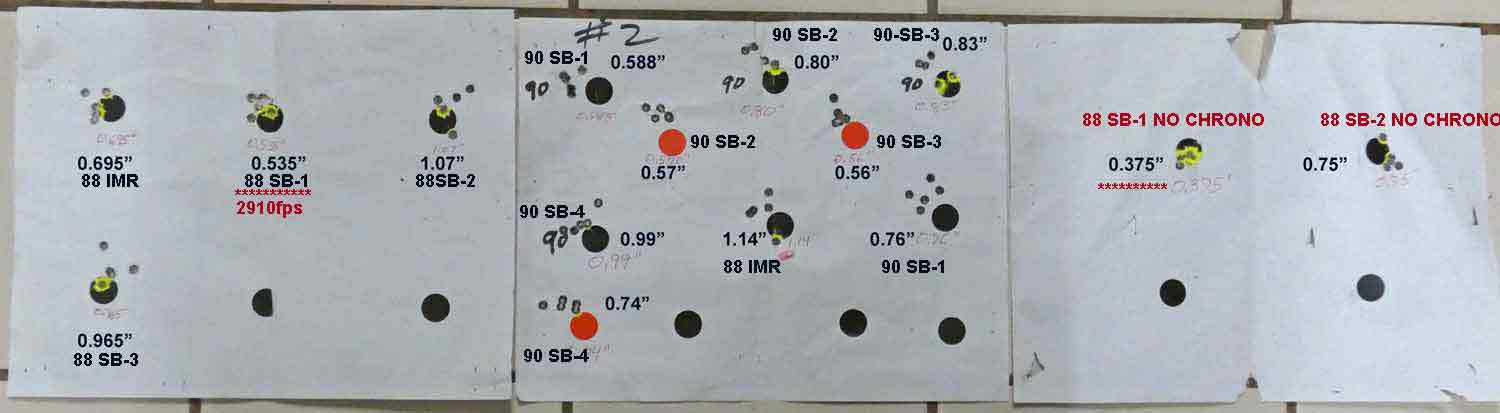

Really heavy barrel (28") and the Sporter seems to open up groups?
Ever notice groups and POI shifts?
The Magnetospeed on my .308 Krieger 26" barrel produces a vertical POI shift of a little over 2" at 100 yds. Groups with the Magnetospeed are virtually the same as without it.

Here's a pic I posted elsewhere a couple days ago.
Not shot in order but all labeled.
The 88-IMR4350 load has about a year history.
It shot high. OK, POI shift.
The 88-SB6.5 with and without Chrono is what I'm talking about.
No time before my next 600 F-Class match to test so I'll go with 2875fps 88's over IMR4350 in case the 2910fps 88-SB6.5 don't group.
There are a couple of flyers that might be me.
I can usually do 3 into .3, 5 into .5, 10 into 1MOA, 60 into 1.5MOA @ 100 yards.
