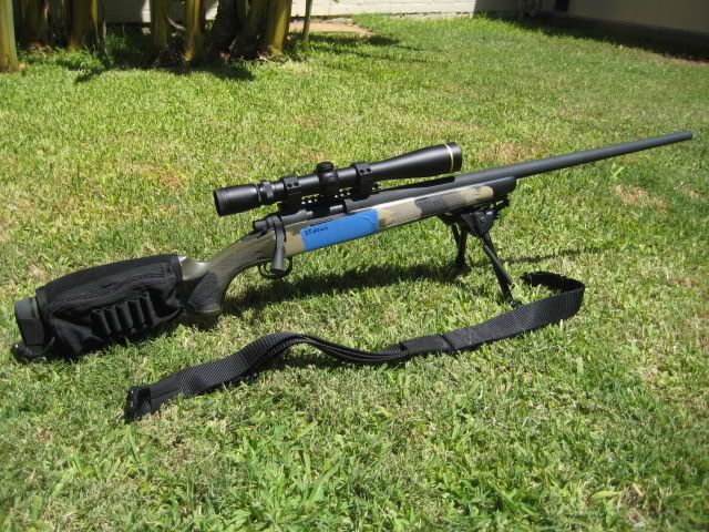

I'd like some advise here.
New Shilen 6mm cm barrel chambered in .243, headspaced and crowned by a local smith.
The crown has burrs or a rough edge and appears to be unfinished. I'd like to lap the 90 degree edge of my crown with a 3/16" brass ball, chucked in a hand drill with lapping compound. I do believe that the crown was cut true, just never finished.
Hope the picture below is clear enough to validate my observation. Also, you'll notice that the muzzle plug left a bare metal ring around the muzzle when cerakote was applied. The rifle has never been fired.
Seems like a simple task... Randy?, William?, smiths? any suggestions before I do this?
