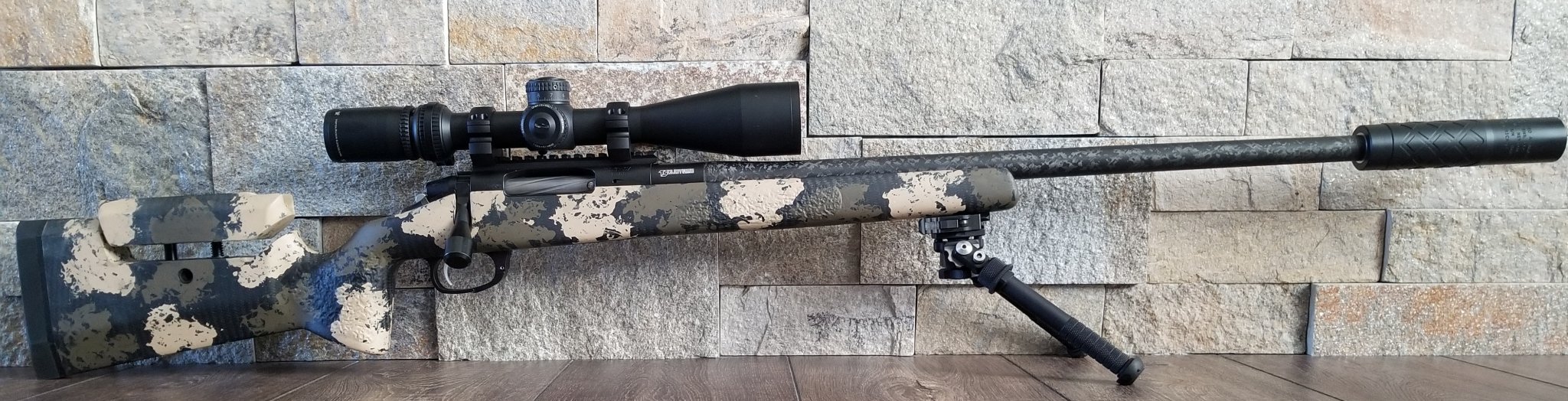

It's doable. My "do it all" rifle weighs 12lb 8oz with optics and bipod. It's a Stiller Tac30 with a 22" Proof CF sendero contour in a Manners Prs2 with barricade mini chassis. Weight includes the RRS dovetail for the mini chassis, Atlas CAL with RRS BTC Pro, and a 5rd mag. Cutting out the mini chassis and RRS dovetail would shave about 9-11ounces and without the adjustable cheek piece probably shave even more weight.
I don't mind shooting it and dragging it around how it is (6.5cm) but eventually I'll get another Manners without the Mini chassis to cut back on the weight.

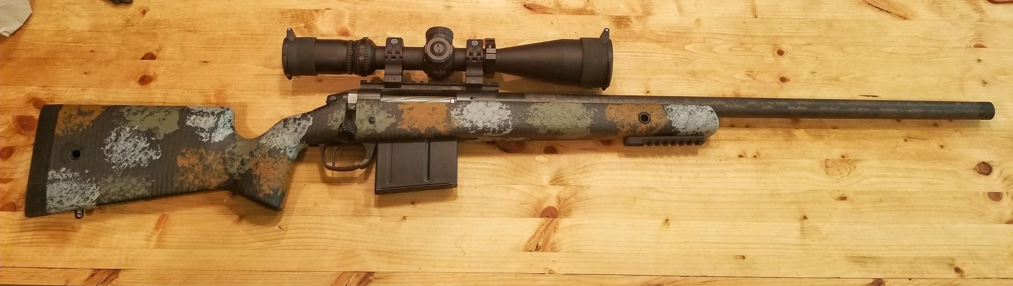

I had kinda the same idea, just finished it. Wanted a lightweight hunting rig, and switch barrel capability to practice with the rifle in the off season (without burning up the proof barrel), and if I wanted to shoot a local match or something I'd be able to. Went with carbon 28 Nosler and then for my range/practice barrel I decided on a heavy steel 6.5x55 swede. Will give a little better performance than 6.5 creed since I wont be limited by mag length, should be pretty easy on the barrel, and it's about the cheapest cartridge out there for Lapua brass.
I settled on the Big Horn TL3 for the action. Every one of their actions head space the same, so many reputable smith's make shouldered prefits they can ship to your door and you just torque it on. It also uses savage threads, so if you wanted an even quicker "to get in your hands" and cheaper option for a barrel you could get a savage prefit and use a barrel nut. Floating bolt head of the Bighorn means I just have to change it to go between rounds, the standard bolt head was $125.
Went with Manners EH1 (non adjustable to save that 1lb) with CIP length mini chasis, trigger tech special, proof 26", Vortex AMG and ARC rings. As its sitting right here with empty mag its 10.2 lbs.
