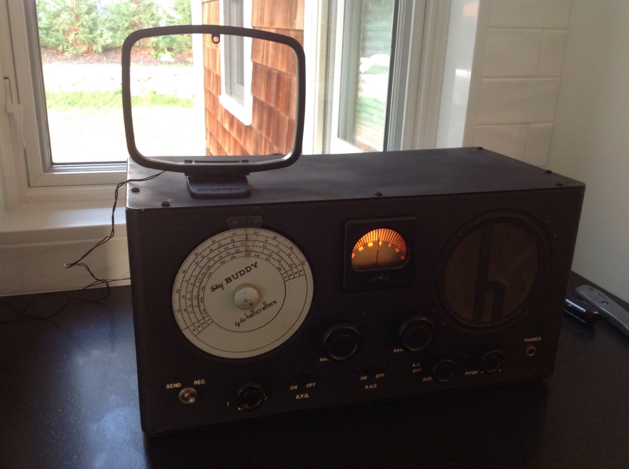

    US soldiers using a Sky Buddy on Bataan......

    Thinking if I had a real antenna things would get better.....
    I was just barely getting the local station that plays old time country music this AM. They increase their signal about 0700 maybe than.
    The radio definitely gets stronger if allowed to warm up. Starting to hear the music come in a little stronger after two minutes or so of operation.
    Fucking Time Machine....
    Screwed with the antenna, actually loosened the connection on one of the legs and the station came in stronger. Now I have both legs under the single terminal....
    I was just barely getting the local station that plays old time country music this AM they increase their signal about 0700 maybe than.

    It takes a while for all those tubes, transformers, and capacitors to get charged. Old? I remember all the little brick buildings that the phone lines ran in and out of. Repeater's.

    Getting better longer it runs. Some of the background buzz is disappearing.
    Who knows when it last ran.

    With old gear that hasnt been used for a long time its usually best to use a variac to bring them up to full power slowly. The 'buzz' could come from needing the old dried out resistors and caps replaced. If it doesnt clear up take it to an old guy who can work on vintage tube equipment. He can likely tweek it to get maximum performance.
