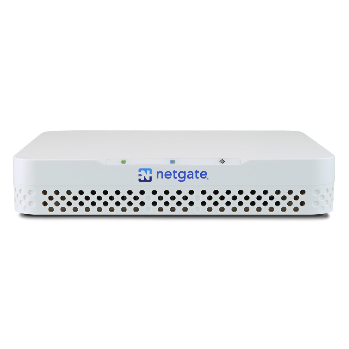

Something like these are all you need for a powerful edge device for a SOHO you can configure and lock down to your hearts desire
Reactions: Makinchips208

Here is a rock solid, secure, full of features SOHO setup that any small business can easily setup the basics and it just plain works. I dont think just under $1100 is breaking anyones bank unless its some Etsy sensation knitting winter hats in moms basement.
This setup has the ability to setup VLAN's, isolate hardware and networks all on that single Aruba 24 port switch and setup multiple WiFi networks with different policies. Throw Bitdefender GravityZone Enterprise EDR on each of your windows PC's and you will be good to go. As you grow, you can easily add Security cameras into this network as well as VOIP phones, access control, etc. Just setup more VLAN's and tag those ports on the switch and plug in your cameras, NVR, VOIP phones, etc. Super easy to manage while isolating your different hardware to different VLAN's (Virtual networks) all managed and monitored on a single device (Netgate firewall)...
Lets just say a Netgate 2100 Max - $392
Aruba AIO 24 Port POE+ Gigabit managed switch - $474.99
Aruba AP22 WiFi 6 Dual-Band AP - $169.99
Total Hardware Cost - $1036.98

The hardware I posted is fully.automated by design. He isn't patching anything. Do you have experience with this hardware? Aruba AIO is updating is fully automated, it is a set it and forget it platform with enterprise reliability. .
I can't tell you to date, the 1000s of pieces of the suggested hardware we have sold, none have died and clients networks gone down.... thats why you spend the money on quality hardware. We aren't in the business of selling hardware that we have to constantly roll trucks to support or repair...I don't think anybody is
