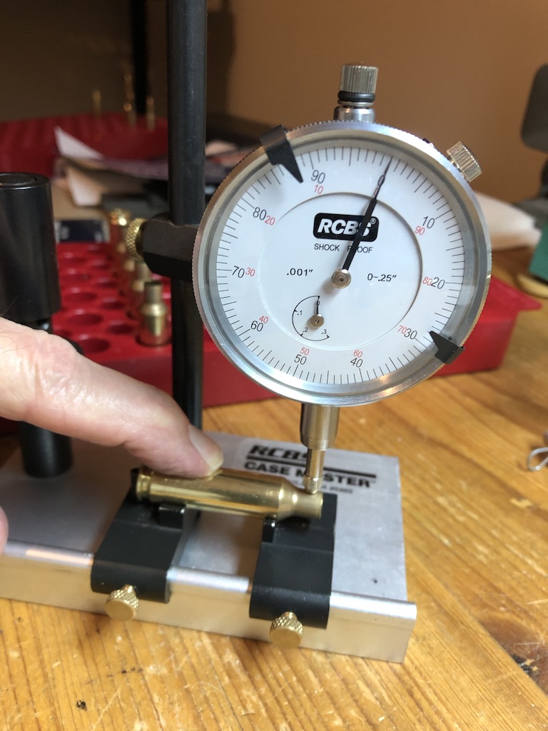

So Sinclair International's Bob Kohl talks about keeping Total Indicated Runout (TIR) under 0.003" here. He says "good" precision ammo should have 0.003" or less TIR.
Ok, so what I'm finding is all my resized (using RCBS Gold Medal Match bushing die and a Sinclair mandrel) Peterson and Starline 6.5CM cases come in as follows, measured on an RCBS gauge with the case supported as shown in the photo:
  1. Case body, measured about 1/8" below the shoulder: 0.0000 - 0.0005"
  2. Case neck (measured as shown in the photo): 0.0000 - 0.003" - Distribution:
    > 20% <0.001"
    > 40% 0.0015-0.0025"
    > 35% 0.0025- 0.003"
  3. Neck brass thickness varies <0.0005"
Pre-resize measurements are all 0.001" or better.
My Question: Given that I just started looking at case neck TIR (#2 above) and I'm getting consistent sub-two-inch groups at 300 yards (many groups of one inch or even better), do I need to get further down in the weeds trying to eliminate case neck runout? I've already made some progress in doing so. I've been working on getting TIR measured on the bullet about 1/6" in front of the case mouth down to 0.000-0.003" and have gotten that down pretty well.
Yes, I realize I'm making it harder to achieve super-duper concentricity by using a Dillon 550, even tricked out as described in articles by 6.5 Guys and others. Again, consistent 1/2-MOA or better accuracy at 300 yards or more - observed on paper, not steel - suggests that my handloads are adequate, but if improving TIR to <0.001-0.002" will make accuracy better/more consistent, I'll work on it.
Your measurements don’t mean shit without the bullet seated in the neck. The case with .003” neck runout might have zero bullet runout and vice versa.
I agree up to a point. I wanted to see if there's a correlation between TIR measured on the bullet and TIR of the neck.
So I have now seated bullets in the best (<0.001" TIR) and the worst (0.003-0.0035") neck runout. Bottom line is there is some correlation between neck runout and runout of the seated bullet but not as much as I expected.
The main thing I want to see is if there is significant accuracy difference between rounds with <=0.001" TIR and >=0.003" TIR (measured on the bullet) at 300 yards. That's tomorrow. Cloudy calm forecast - negligible wind & mirage.

And that's why I asked the question about going too deep in the weeds. It would appear the answer is yes, get out of the weeds.
I'll find out soon enough whether there's an accuracy difference between <=0.001" and >=0.003" with my loads. It's a matter of simple curiosity to me so I posted here to see if it has been to anyone else.
Your comment about factory ammo further stirred the pot so I looked at 5-10 rounds each of factory Hornady 140 ELD-M, 147 ELD-M, and 140 American Gunner. Most of the rounds were 0.002-0.003" with a couple near 0" and a few 0.004=0.005".
I'm with @308pirate on this one.... too far in the weeds. If you wanted to find out how to best figure out how this concentricity thing affected your loads, you would need to make loads with 0.000, 0.001, 0.002, 0.003, etc runout, and shoot them with the same orientation (i.e. the side with the most indicated runout chambered at 12 o'clock) Also need to know if your chamber is concentric to your bore, in line with your bore, etc. You would need to shoot a handful of those those runout rounds indexed at 12, 3, 6, 9 o'clock positions because.....
Your data is meaningless
I'd bet anything your rounds will be different if you chamber them from a mag, pull them back out and check again.
I've seen zero difference when I've checked and sorted.
My theory is when you put 50k+ psi behind it the bullet straightens itself in the bore quite quickly and doesn't affect a thing.
    > 20% <0.001"
    > 40% 0.0015-0.0025"
    > 35% 0.0025- 0.003"

I appreciate all the constructive comments ("constructive" includes "you're too deep in the weeds," which is part of the title of the thread). My curiosity itch has been scratched.
Earlier this week, I put 10 of my best rounds (0.0000 - 0.0005" runout) and 10 of my worst (0.003 - 0.004") on paper at 200 yards. I would have preferred 300 or more but wind and mirage pushed me back. Anyway, there was no difference. The sample size is small and wind/mirage almost certainly hurt groups... normally I get consistent 1-inch +/- 1/4" at 300 in optimum conditions, and this time I got 1-1.25 inch at 200... but I saw enough on the range and in this thread to set aside "concentricity" as a significant factor in accuracy of my handloads.
