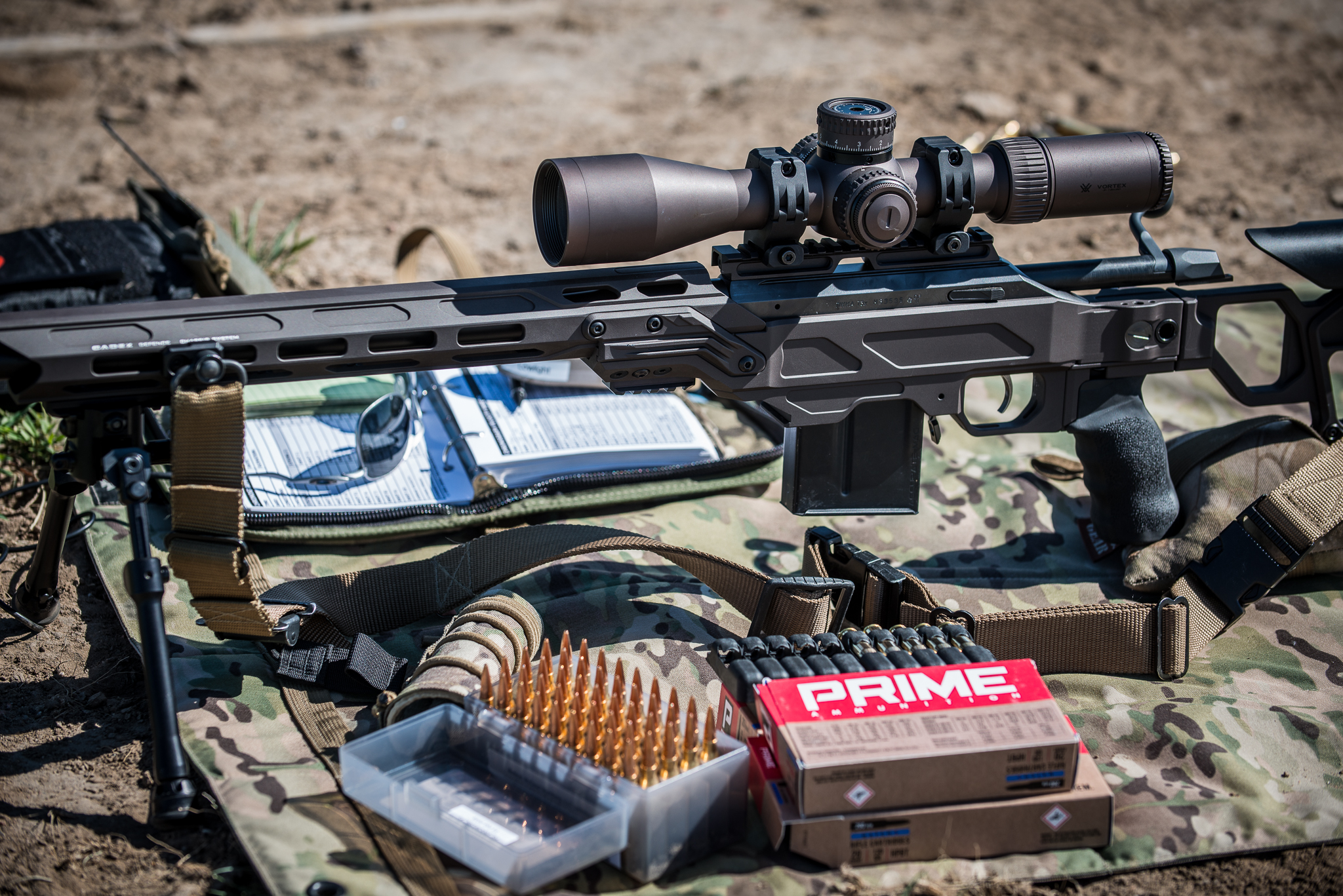

I am shooting a RPR Gen3 in 6.5 Creedmoor and have been using Hornady American Gunner 140 Gr BTHP. My question: How much better accuracy can I expect by reloading that Hornady spent brass or even purchasing new good brass in a reloader by handloading, cleaning, resizing, etc. My goal is only to shoot for best groups at each distance up to 1300 yds. I know there are many many variables but I have the time to reload as I am retired, and the desire to shot as good as I can be as an old Viet Nam Veteran with old eyes, arthritis, but perseverance. I got hooked the first time at the range when I zeroed my 6x24x50 scope at 100yds and shot sub moa groups consistently. That said, I have no desire to enter competitions. How much better groups will reloading vs good match ammo give me?
Can I improve on the match ammo by handloading?
