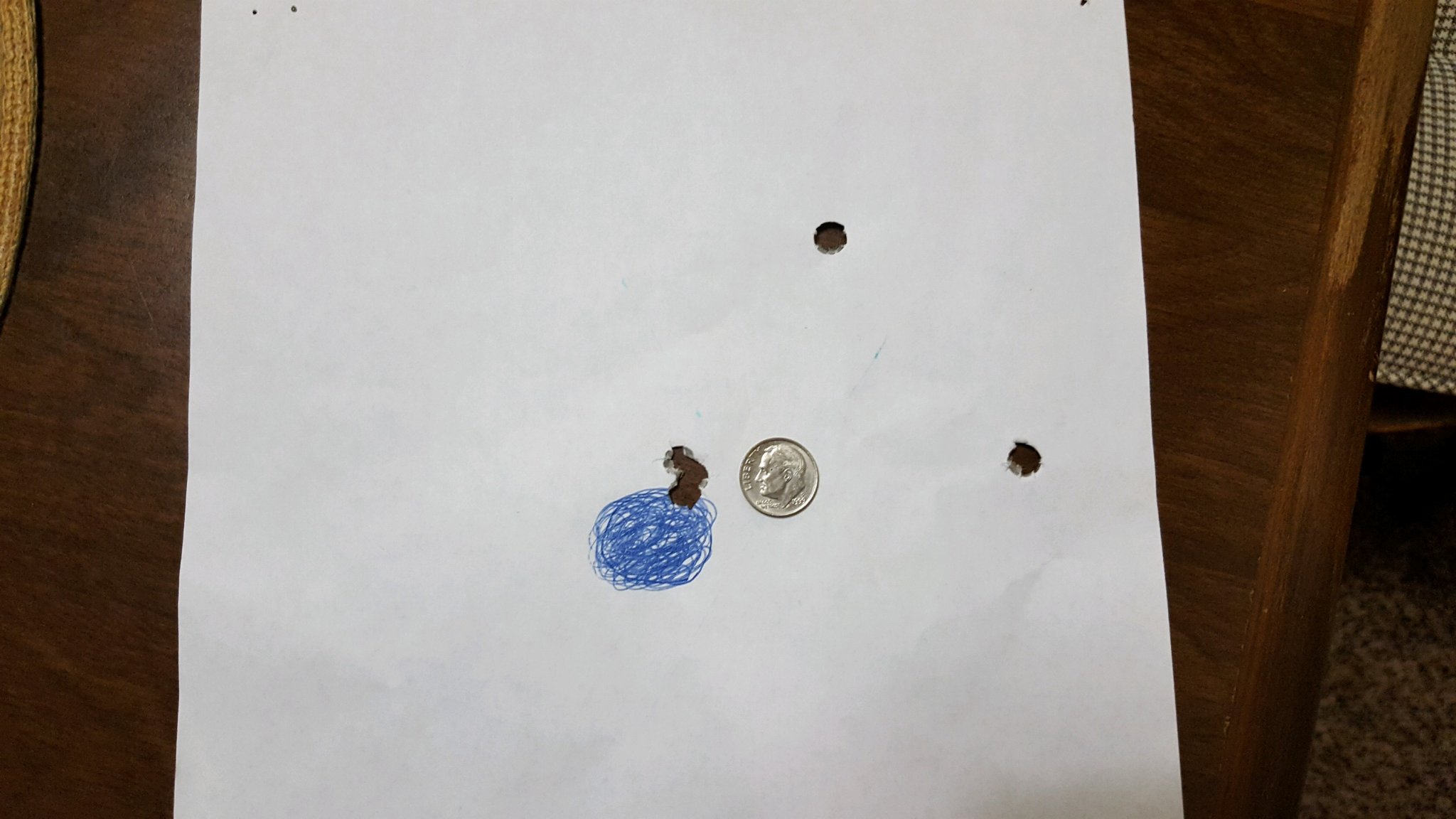

Berger 215 - Sighting in after scope change: (high shot was first shot, right shot is me turning the scope the wrong way like a goof):

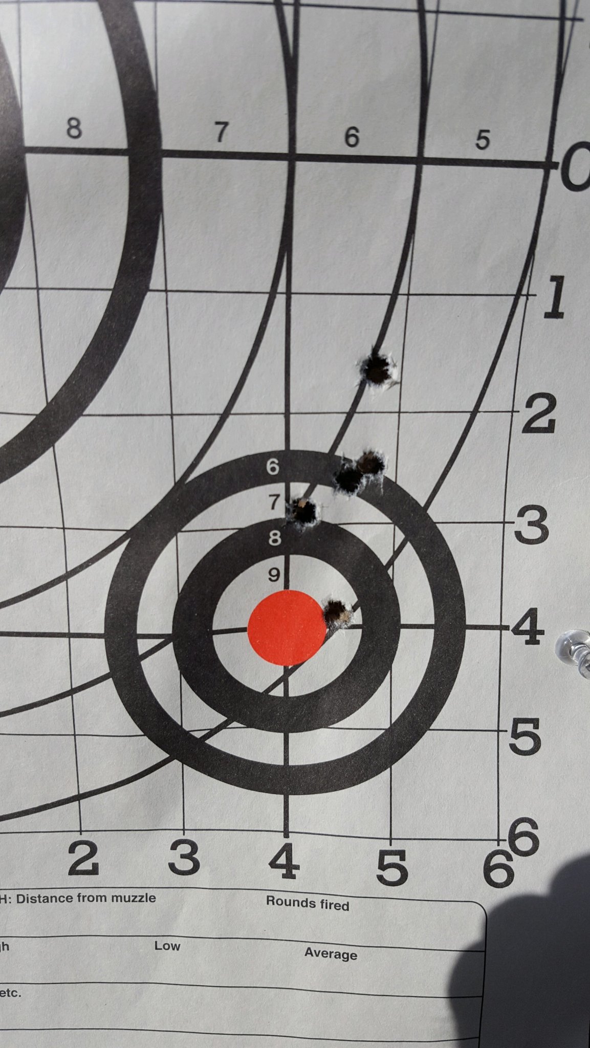

Berger 215 Load Validation - Says post cleaning, this was after I cleaned the rifle because I could not get it to reproduce the above group. I shot 5 foulers after cleaning and before trying this group.

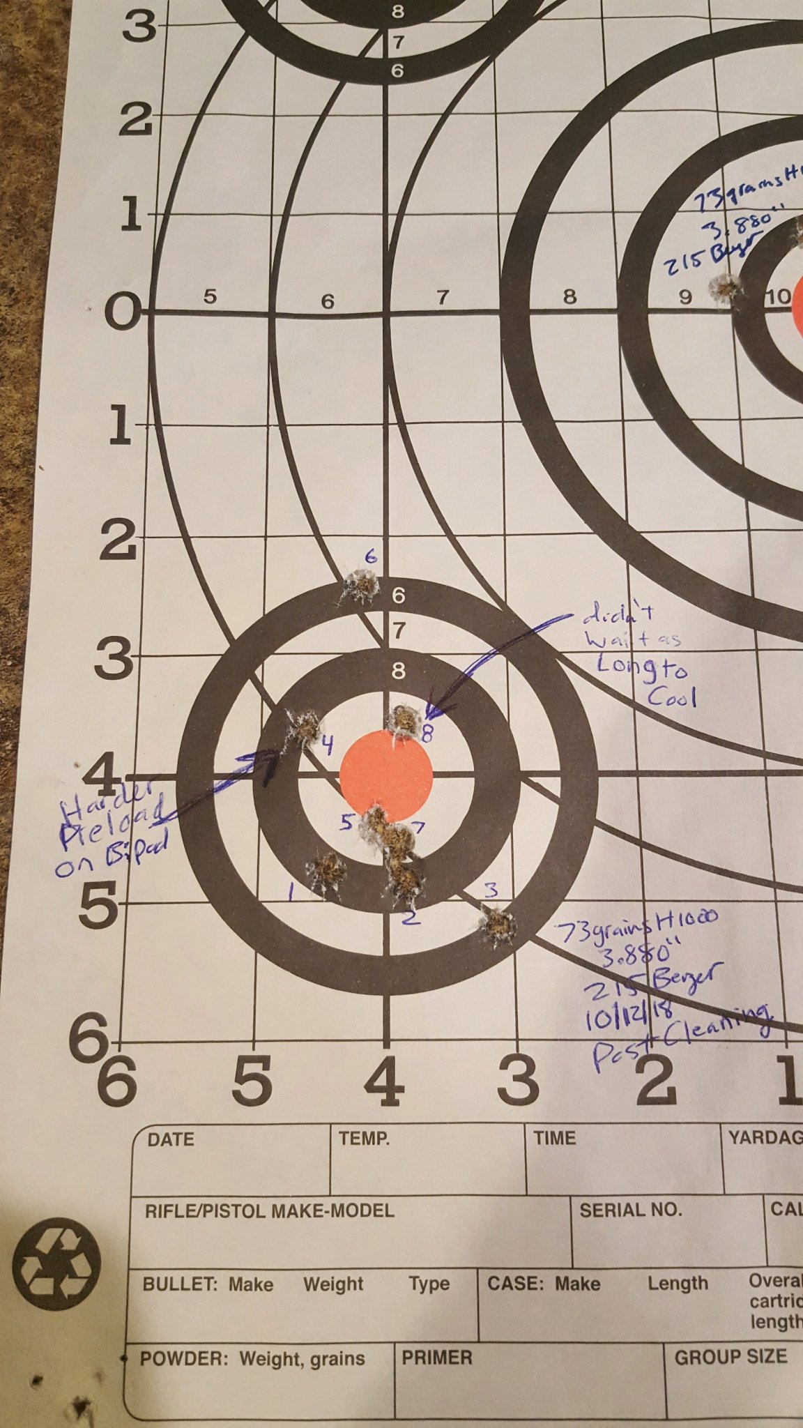

ELD-X Testing - top right is 75 grains with a decent group (middle is 71 grains, top left is 73 grains, bottom left is 77 grains). All bullets are jammed.

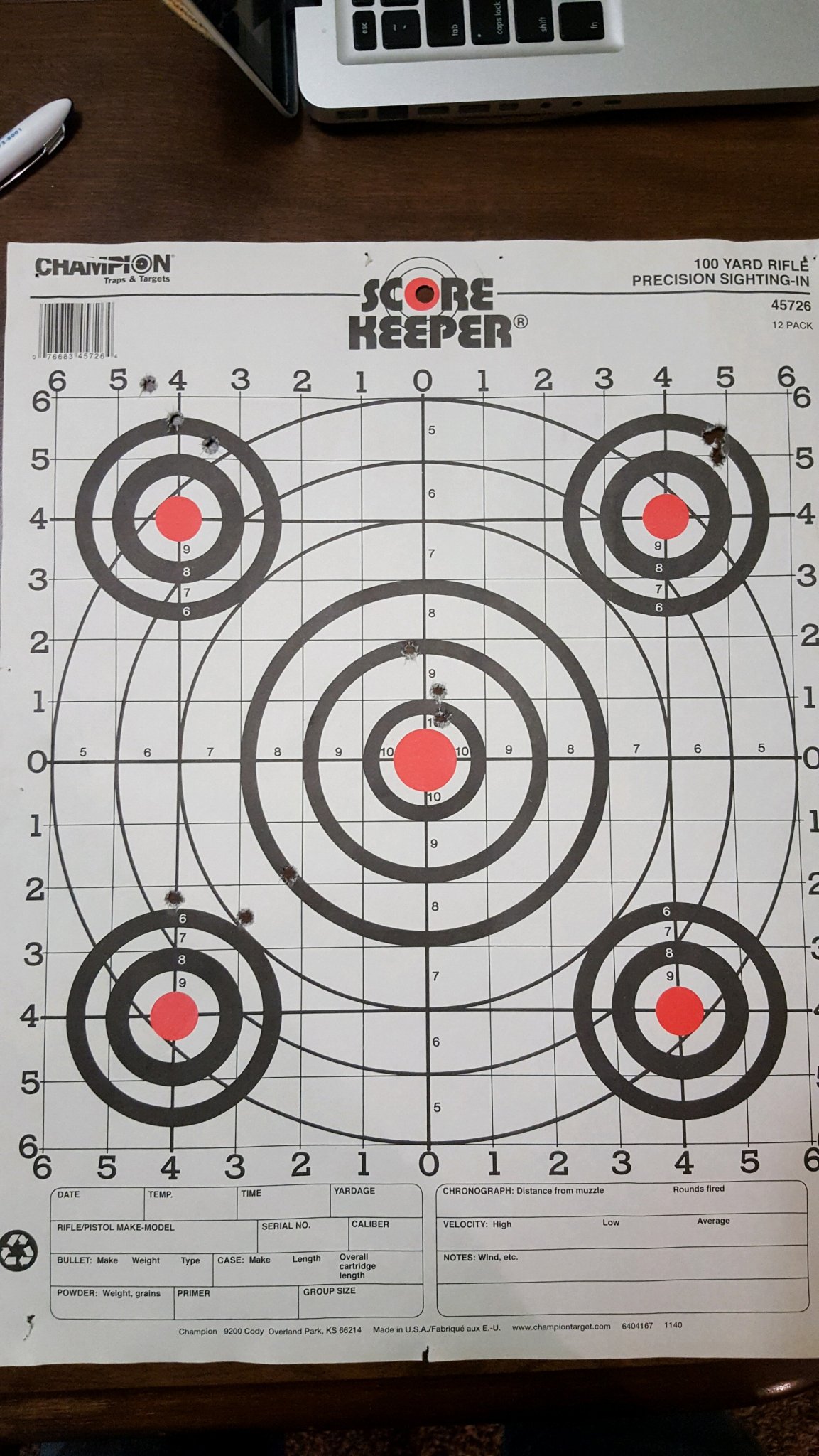

ELD-X validation - same exact load as above
