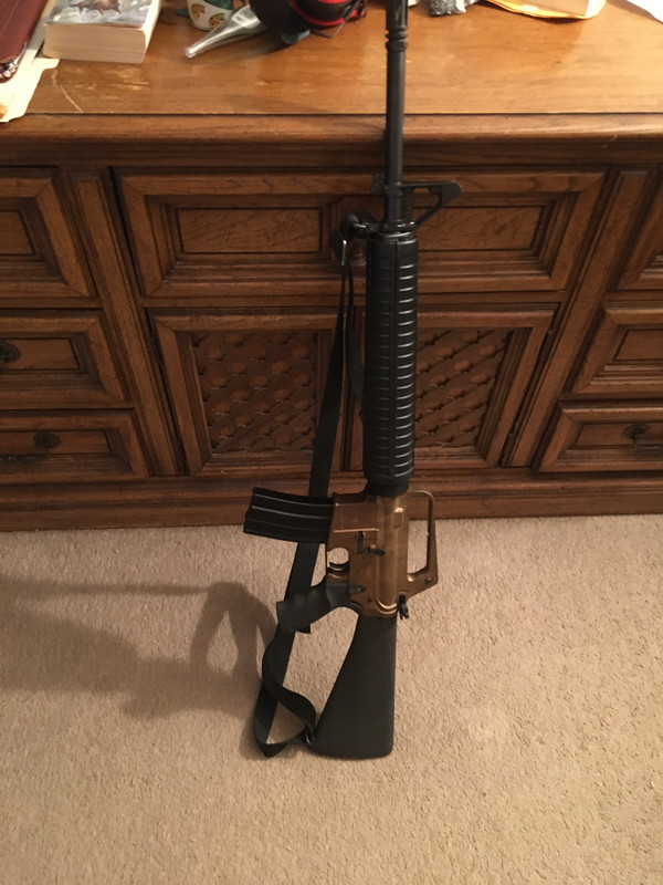

    Here's my 3 sets (was my 3 sets, I recently gave 2 sets to friends). The AR15 lowers are finished, but the 1911 frames are just 80%. I have no idea who to send them to for finishing, does anyone have any suggestions?

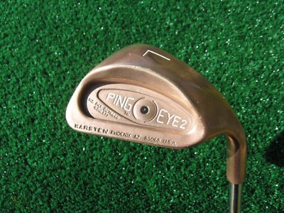

    Do those actually feel softer? I’d heard that from a couple BeCu owners but have never swung em in person.
    I’m not an avid golfer and was looking for a club that was more forgiving and produced good spin around the green. They seem to do that if I do my part. They definitely feel softer compared to semi-cavity backs and 100% better than blades. I haven’t hit them next to their steel counterpart Eye 2s.
    I have Project-X rifle shafts and nice grips so these clubs remain “relevant”. I’ll possibly play these irons for the rest of my life. I get a lot of compliments and “I wish I never sold mine” stories. 🍻
    Reactions: themightytimmah
