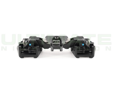

This?
Or this
Reactions: TheHorta
I would think the Mod Armory QD bridge (not the light weight one above) would be the one you want...

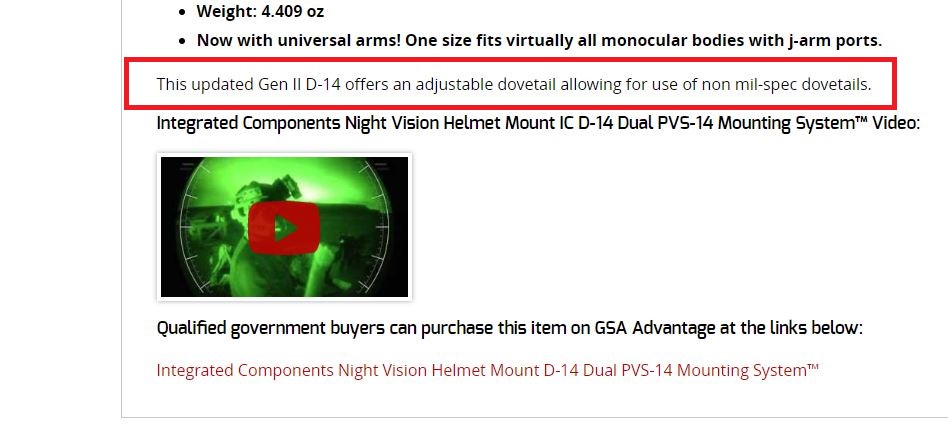

MA updated their QD bridge mount to allow adjusting (via a set screw) the amount of tension/variance in the wilcox shoe. They marketed it as an "improved" version that allowed for "wear adjustment". This (I would suspect) saved them from having to bad mouth Wilcox for a spec that had enough slop/tolerances to cause issues.

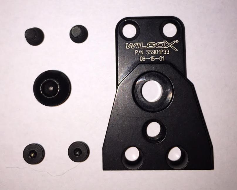

The UTMx Shoe doesn't have the milled out section in the middle like the Skeet and RQE/KVC dovetails, and therefore isn't compatible with how the Mod Armory bridge locks up. Before switching to the Skeet, I ran a UTMx on one eye and a PVS-14 on the other eye using a G24, KVC bridge, and OSS shoe set.

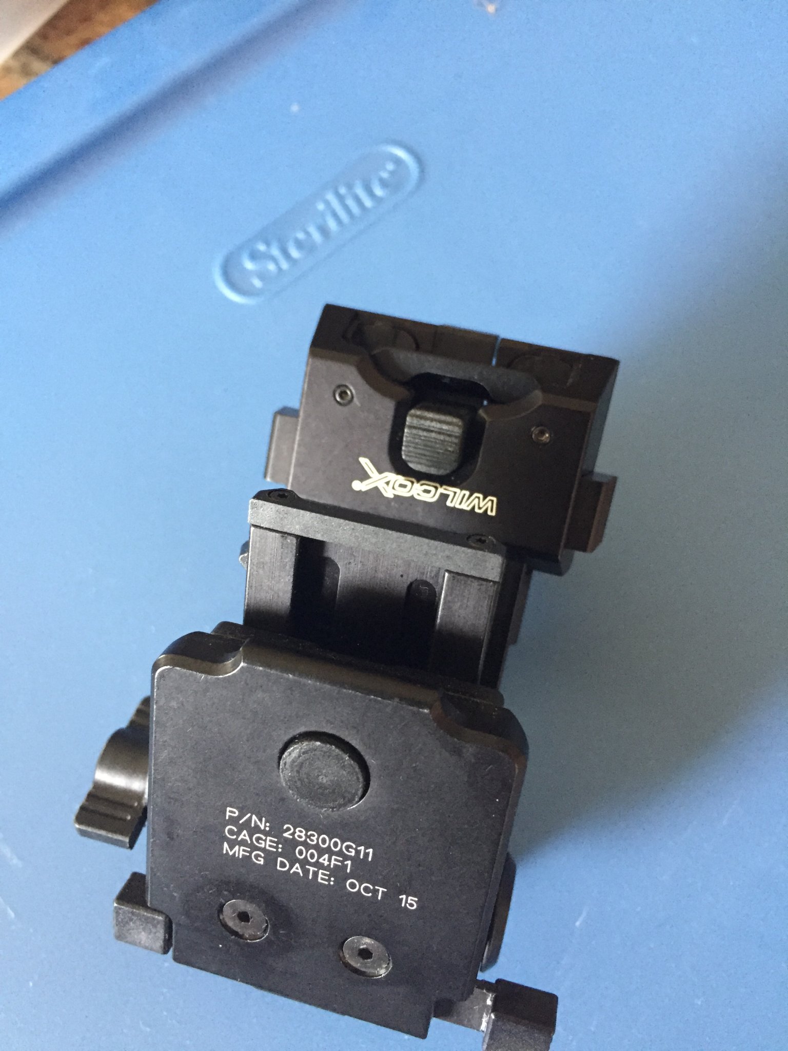

Ok I think this is the G24 Mount ? View attachment 7376569View attachment 7376570
So I just need the KVC Mount and OSS shoes?
That's a G11, which uses the the horn interface. The G24, G22 use the dovetail interface which is what you'd need to connect to the KVC bridge. The Wilcox bridge has a horn interface option, but dovetail is a much better system in my opinion.

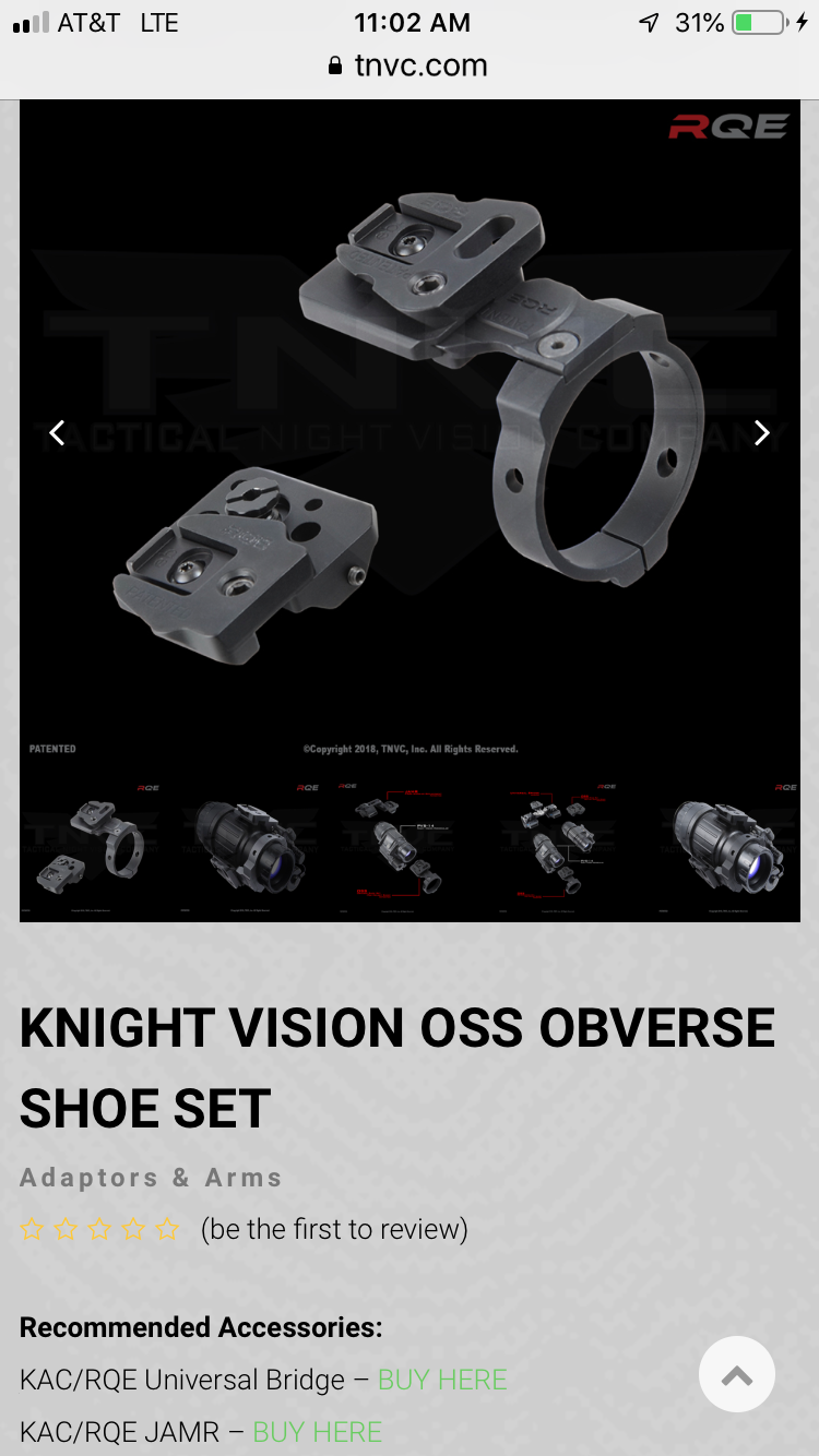

Thanks for everyone’s help
Is this the correct show set?
Yes for a -14. Shouldn’t need one for the UTM to my knowledge since the KAC bridge takes the Wilcox shoe. Someone fact check me on this...

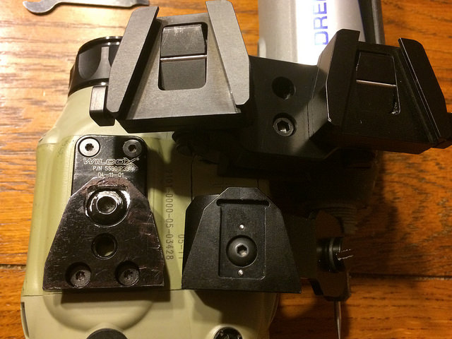

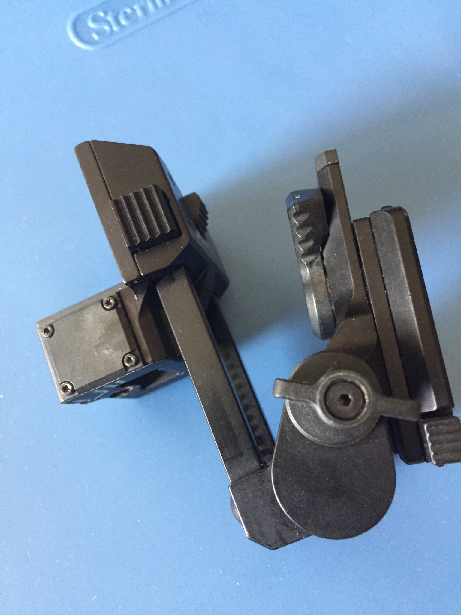

The image above was posted years ago and it shows why the UTM/UTMX Dovetail did not work with the Mod Armory mount . I shows how it was milled out to match the mount that is to the right of it so it could work. The UTM/UTMX was never meant to be helmet mounted. When mounted in the Wilcox flip mount it gets locked in via a rear spring loaded latch that comes up. The Mod Armory mount locks things in via different method.
Again, maybe the UTM's dovetail has changed over the years or perhaps Mod Armory did something else to allow the UTM/UTMX to work today but it did not back then without a modification.
Original Wilcox UTM/UTMX Dovetail.
