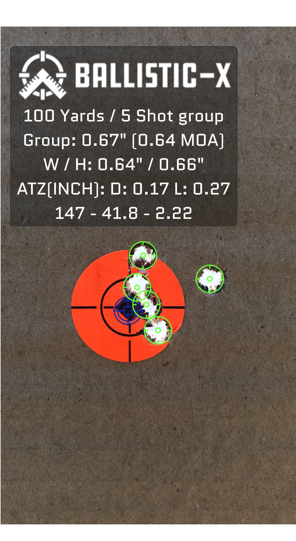

    I have been practicing a lot more this summer on proper fundamentals learned through this forum and podcasts/videos/ etc... so thank you to all who have put out good info and helped in that regard.
    I know in-person training is king, but with a 3 month old kid and remodeling 3 rooms in our house right now, floating in person training isn't gonna happen until 2021 most likely...but I do plan on getting some legitimate training. So for now I've just been practicing at 100 and 300yds working through the fundamentals.
    I'll attach a few videos of me shooting, one from the side and one from the front, as well as the groups that accompanied those videos.. Rifle and load info below.
    Savage 10 - 24" - B&C Target/Comp Stock - CDI bottom metal
    147 ELD-M - CCI 450
    Starline SRP brass - Mandrel(.0015 neck tension) - PP uniformed - chamfer/deburr
    41.8gr H4350 averaging 2715ish fps.
    Every time I get to the range I do 5-10 dry fires, building a position each time working on natural point of aim. NPA has been the hardest thing for me to get down. I then confirm my zero, do a couple warm up shots and go into my group shooting and dot drills, etc. I should mention, I try to use the rear bag as little as possible and I use my support hand to try and control and hold the rear of the buttstock. I use the rear bag to steady my support hand. The rifle is definitely not sitting on the rear bag heavily.
    The last two range trips I've made two adjustments:
    1.) Get my shoulders more square and to stop putting my support elbow so far forward
    2.) Move the butt stock closer to my face so I don't have to lean my head over and reduce the reticle movement to the left after firing.
    This is the first real group for practice for the day. I felt like I went a bit fast for me, and maybe still had a bit of flinch going on. Follow through felt good and eye flinch was minimum for me. The group I shot is below that. The reticle finished high, and a little left on a couple of the shots. Obviously theres one yank there, and I felt that one so I knew I screwed it up. The vertical stringing.... I'm curious is that my breathing or NPA? or possibly something else
    Ballistic-X-Export-2020-09-23 11:38:48.872172.PNG

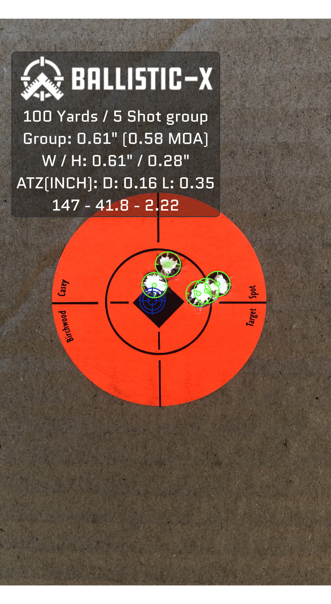

    Heres my best feeling group of the day, and a side recorded video of it. A side note... I pop my thumb up and down a little to try and remind myself to not put any pressure on it. The 3 grasper fingers are attempting to pull straight back. Group is the best of the day, but seems to really be two groups, both awesome, but not together lol. Not sure whats causing that, I'm assuming a shift in body position maybe which slightly changed impact. Reticle still finished a bit high and to the left but definitely an improvement. It finished about 1-2 mils high and maybe a mil to the left. So maybe 6" high and a few inches to the left.
    Ballistic-X-Export-2020-09-23 11:36:33.068597.PNG
    Any input at all would be helpful. If that input is keep doing what you're doing and with practice you'll get better then that works as well. Appreciate the help guys. If it's not really plausible to see how I'm shooting based on the videos, lemme know what might help. Just trying to get better and would prefer to snip out any bad habits or reinforce good habits now.

    Doesn’t look bad at all. The vertical could be several things. You should know if it’s your breathing as you either break your shots at the bottom respiratory pause, or you don’t. Be conscientious about it going forward.
    You built the bridge with shoulder an bipod well in the first video. However you shuffled around after quite a bit. Might look to rebuild it in the further if you find yourself shuffling around after building bridge.
    I appreciate the response. I'll try to be more mindful of the breathing aspect. I was definitely trying to keep a calm, steady breath...but I'll give more adage to the bottom of the breath and the break of the trigger.
    The shuffling is a combo of maybe not the best NPA and where my recoil finishes. Although it's been probably cut in half since I started making minor adjustments, I'm still finishing my recoil high and to the left. The shuffling I think was after 2-3 shots, and the stacking of recoil management was throwing off my NPA a tad, so I adjusted to try and get back on it.
    At this point, I'm hoping repetition is going to be the best reinforcer of NPA for me. I feel like I have the motions down, I just need to get the habitual feel for it. Sometimes its spot on, sometimes I feel like I'm shifting for a minute before its locks in.
    Its like putting on an 3 layers of shirts....they just don't feel right at first and once you keep wiggling around they finally fall into place. Well right now I'm the 7 year old kid who has apparently never worn multiple shirts in his life lol...

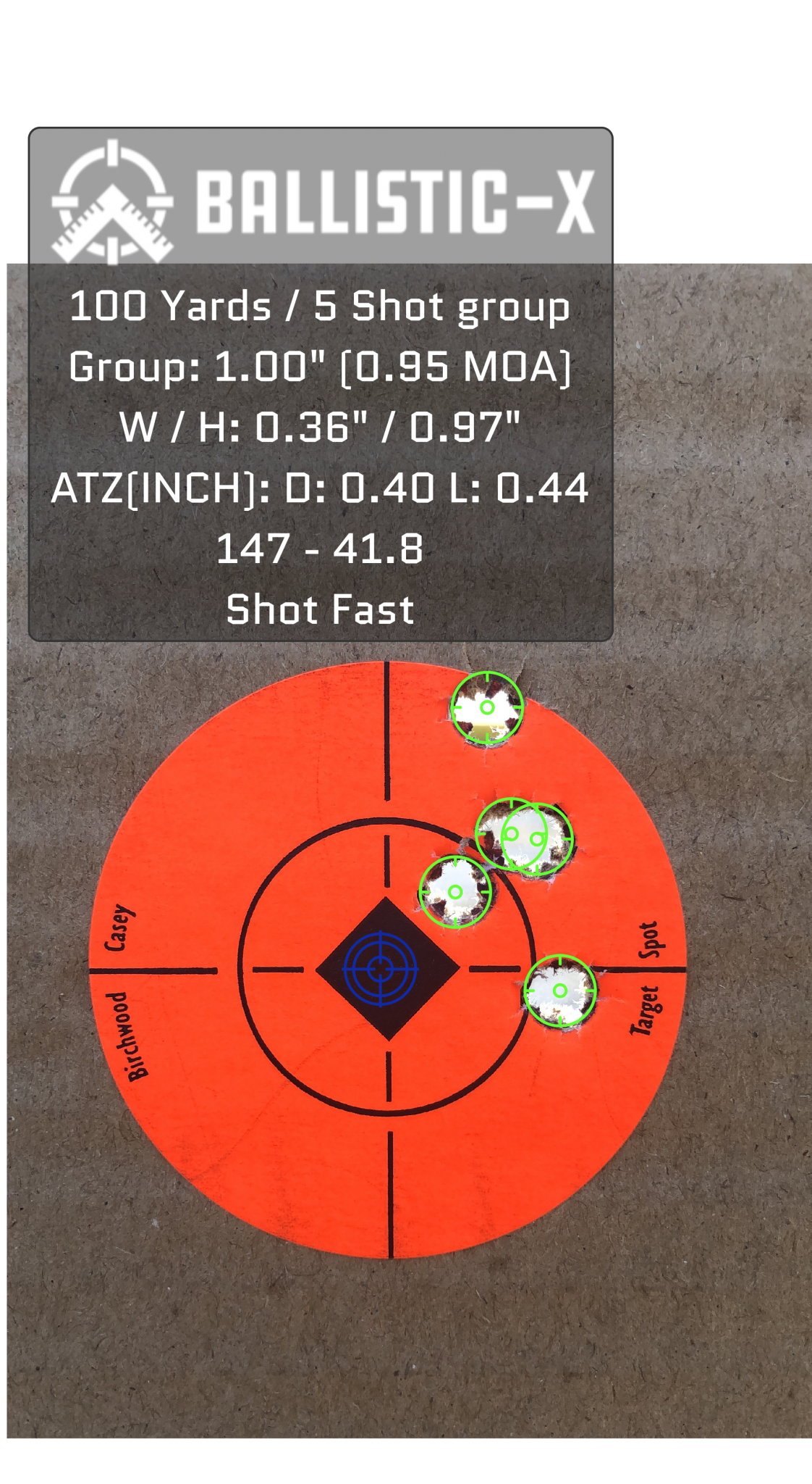

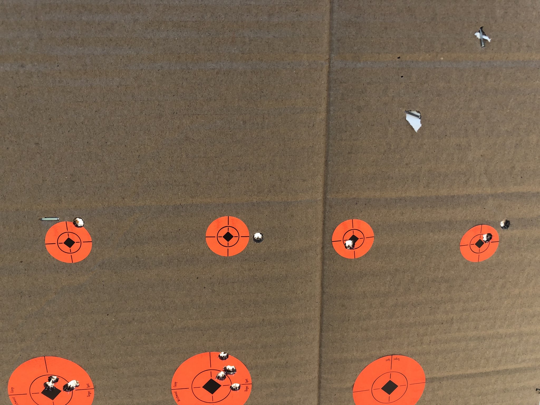

    Appreciate the input, and I understand what you're saying with the group shooting. I didn't want to make the post super long from the start, but what I posted above is only a portion of my range practice. I usually shoot 2-4 groups to confirm zero, confirm consistency, and work on slow methodical fundamentals. I then do either dot drills or 5 shot groups where I will break/build my position for every shot, or build position and use my phone timer to put pressure on the speed with which I do shots. I may also switch positions and shoot prone then modified standing prone on the bench, etc. I sometimes go to the 300yd range and work on positional shooting on a 2moa steel target, etc.
    I'm in the middle of building another load with RL26 as well, so I was doing some other stuff with the rifle this day as well. Speaking of RL26, I think I found a little spot around 2830fps with the 147's, no pressure as of now. Will be retesting/confirming that when I go back.
    Heres my fast fire group, and one of my dot drills. Both 5 shots, with a par time of 30-45s which includes getting into position, loading, and firing all 5 shots.
    Awesome, that's dedication. I am in the same sort of boat, doing good but the refinement takes a higher level.
