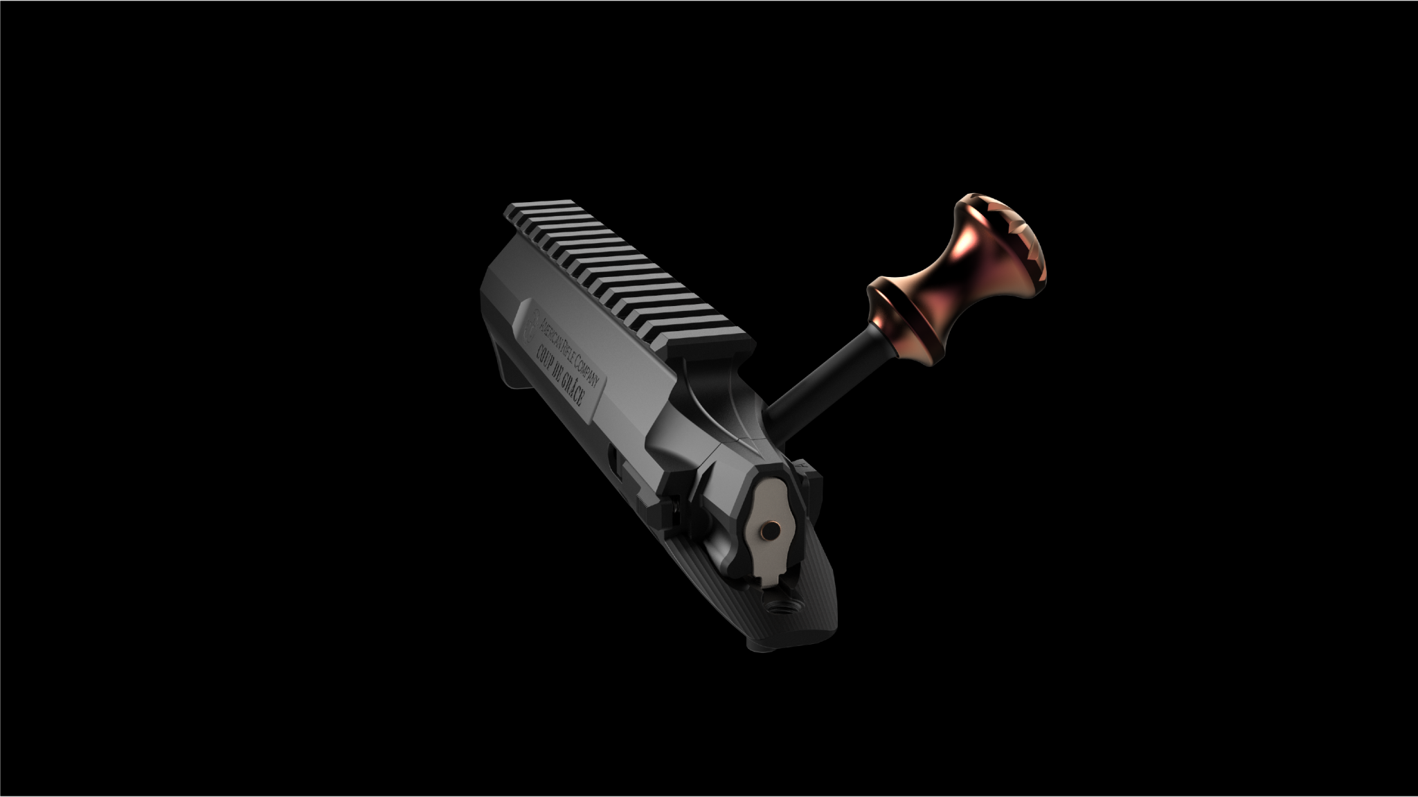

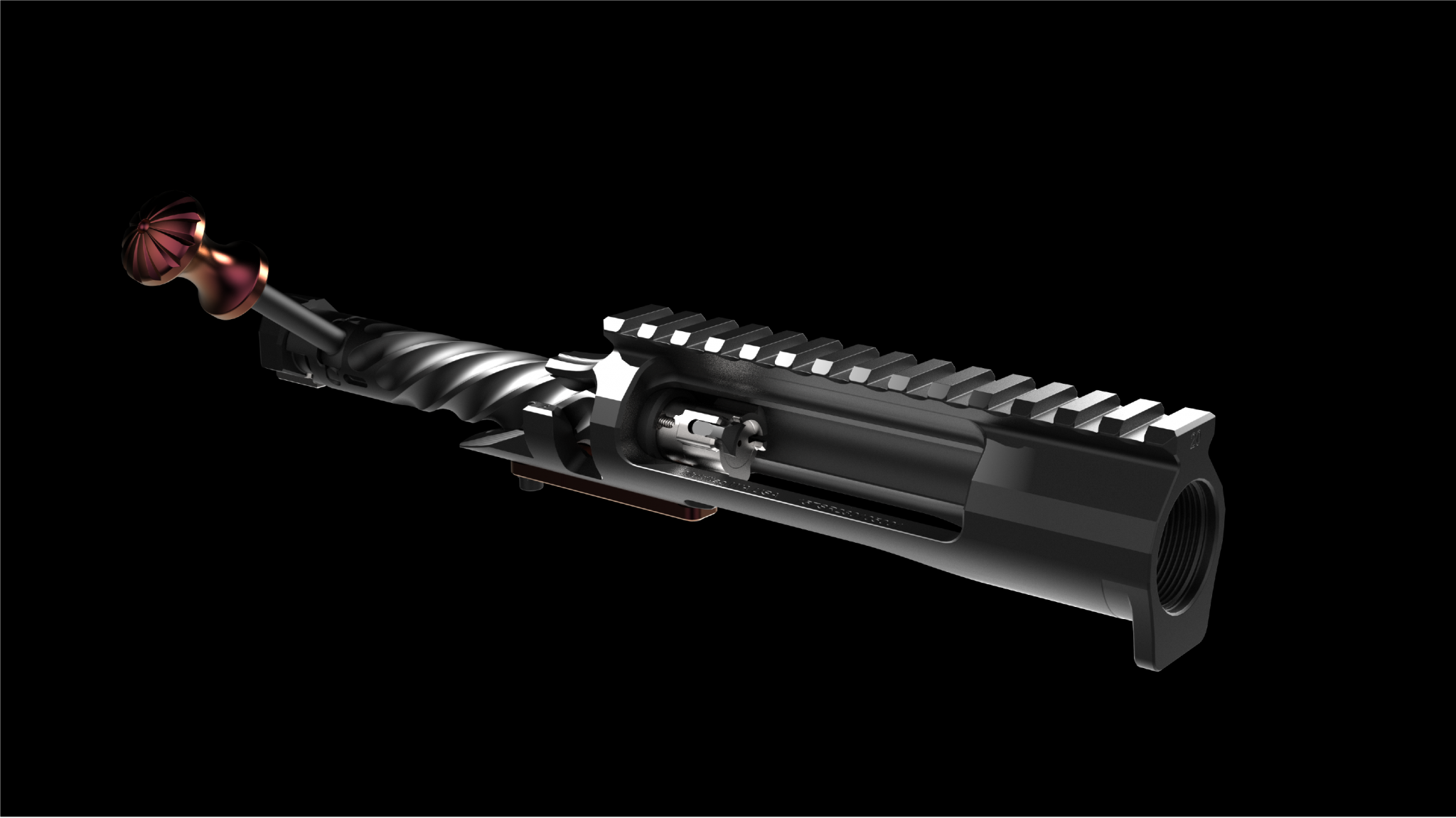

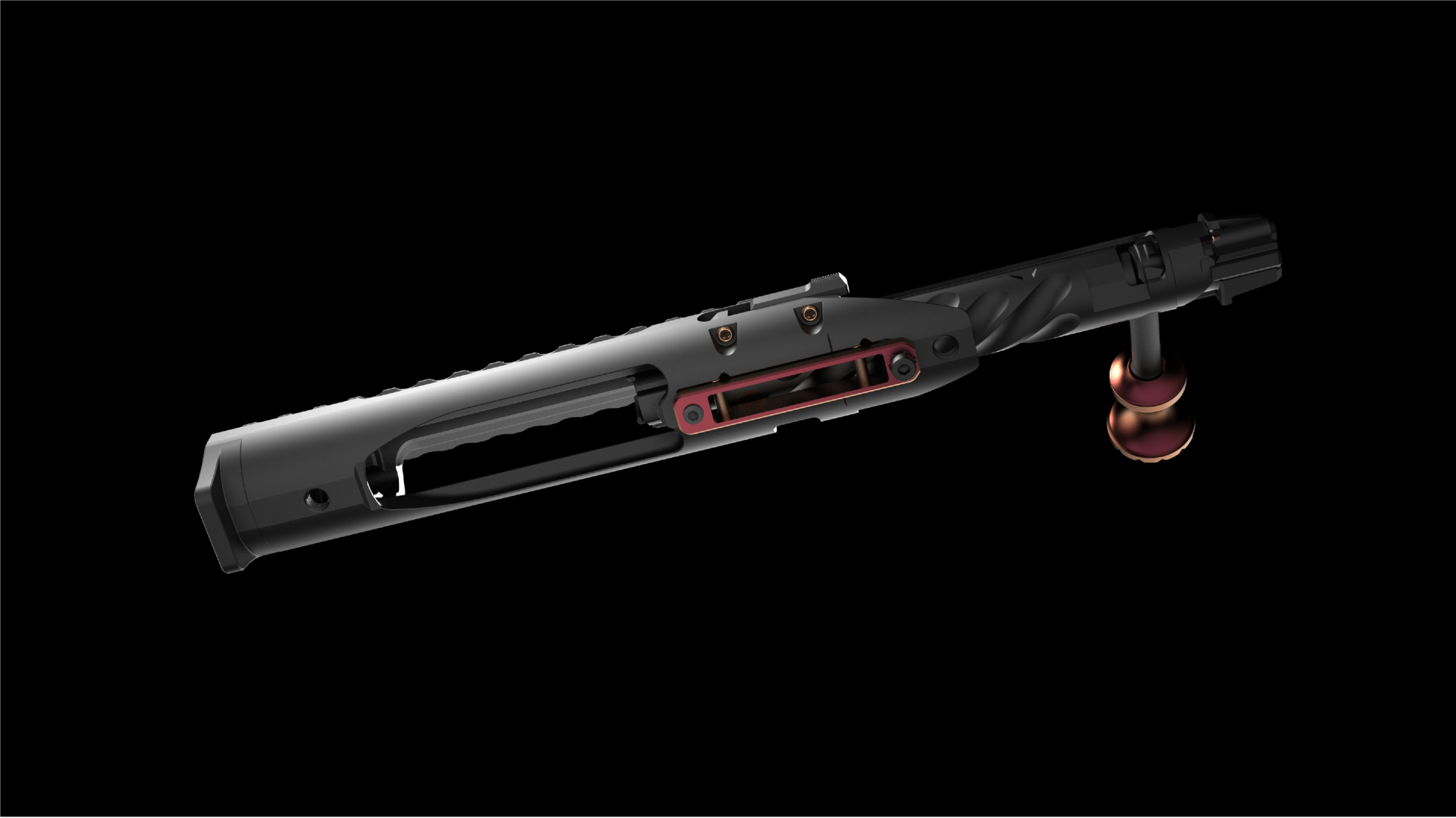

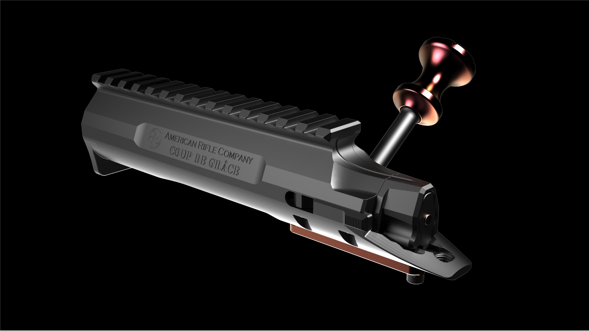

People of Earth,
American Rifle Company proudly introduces the Coup De Grâce at the hard to believe introductory price of only $899.
We'll be taking orders soon, probably in about eight weeks once actions are on the shelf.
From the Oxford English Dictionary:
e. coup de grâce n. /ku də ɡras/ [literally stroke of grace] a blow by which one condemned or mortally wounded is ‘put out of his misery’ or dispatched quickly; hence figurative a finishing stroke, one that settles or puts an end to something.
Whether it puts competitors out of their misery or puts and end to the confusion resulting from the myriad of other bolt actions with little or nothing to distinguish one from another, American Rifle Company’s Coup De Grâce is certainly worthy of its name.

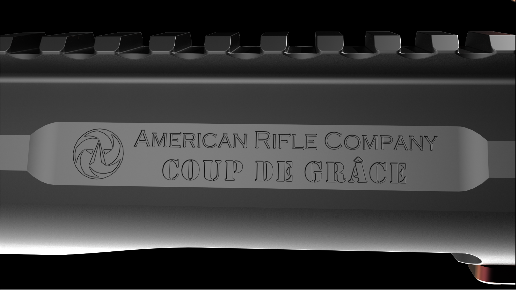

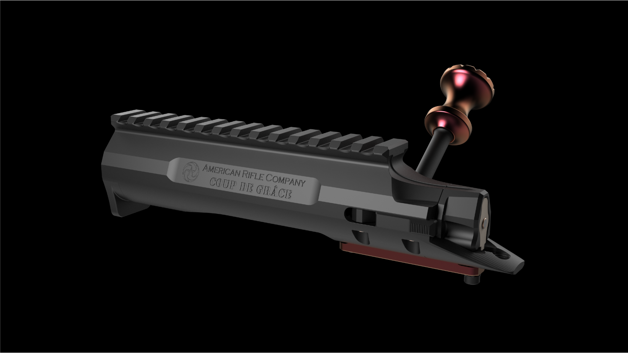

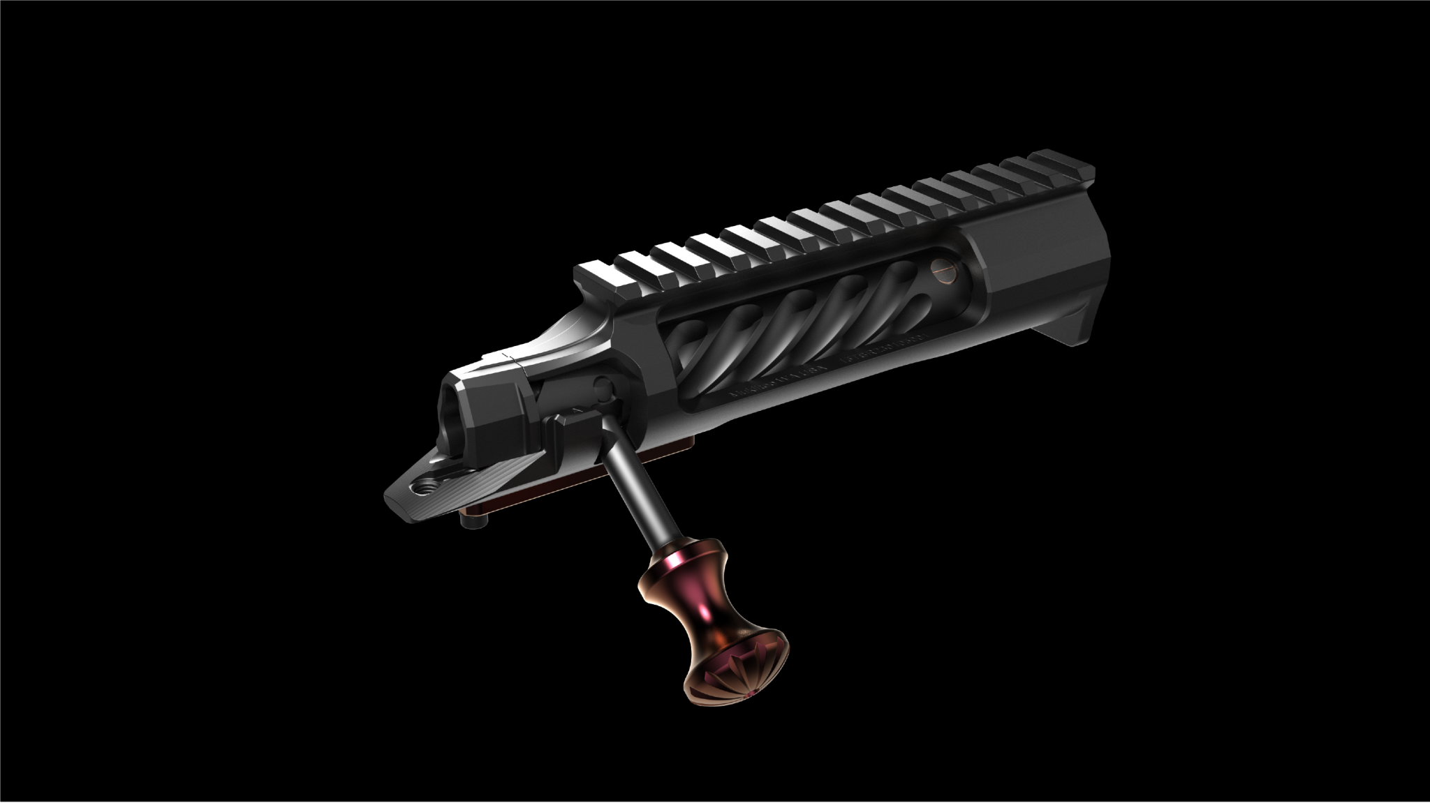

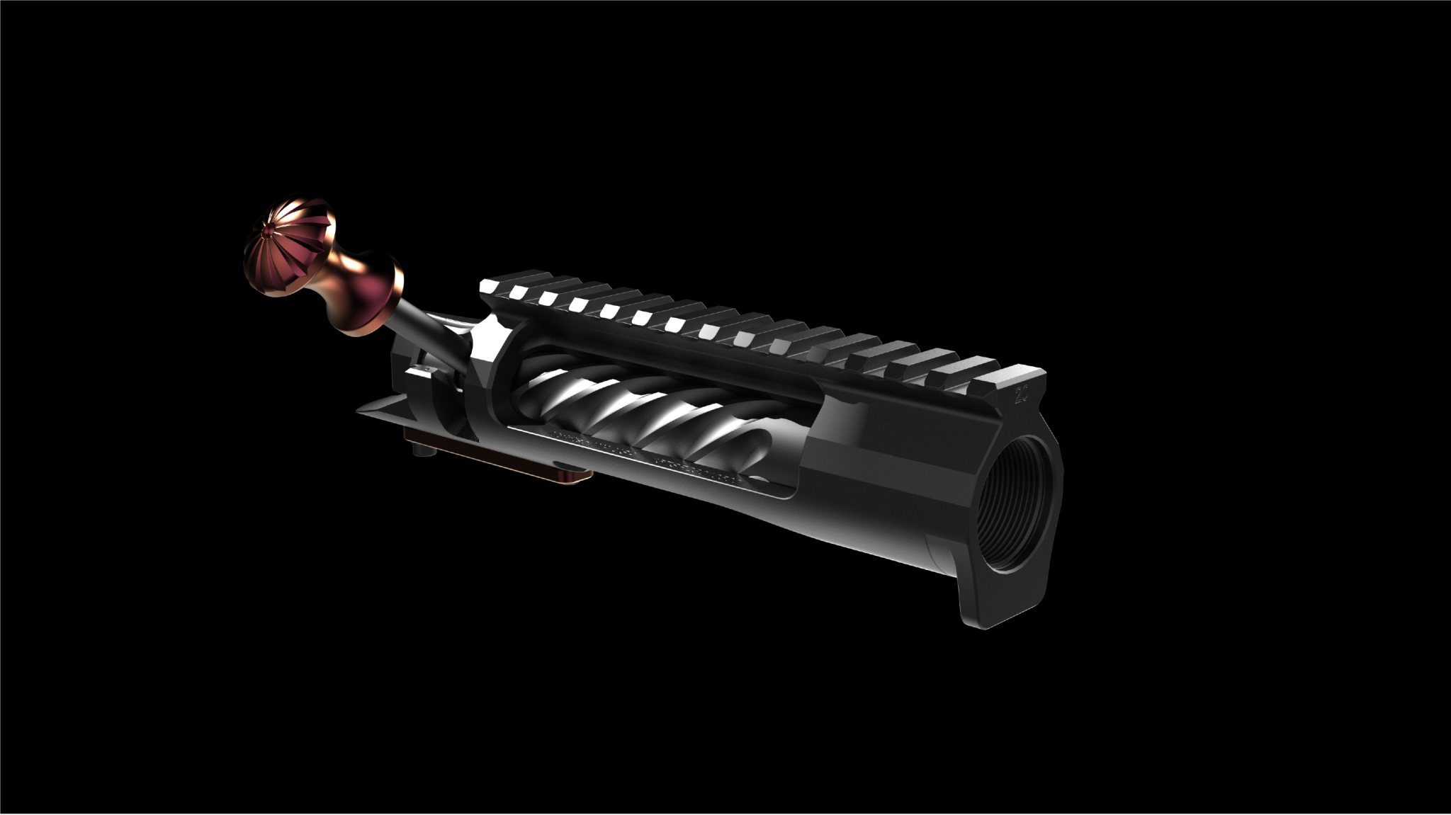

Simply put, the Coup De Grâce does more with less and looks great doing it with its beautiful design, DLC and salt bath nitrided finishes.
It’s Rem700 footprint receiver is machined with an integral recoil lug and integral 20 MOA rail.
The three-lug, 70-degree bolt uses interchangeable floating bolt heads and accommodates everything from 223 Rem on up to 338 Lapua.
Receiver and bolt work well with AICS mags but are optimized for incredibly smooth and reliable feeding using AIAW mags and conical breech barrels.
The AIAW mag will hard stop against the bottom of the receiver thus preventing interference with the bolt.
The back of the AICS mag will hard stop against the receiver but if pushed upwards, the forward tips of the feed lips will interfere with the bolt. The mag will be driven down when pushing the bolt forward. An optional forward hard stop for the AICS mag can be placed between the receiver and the stock/chassis.
Receiver-mounted passive (aka mechanical) ejector sends cases out at three o’clock through a large ejection port.

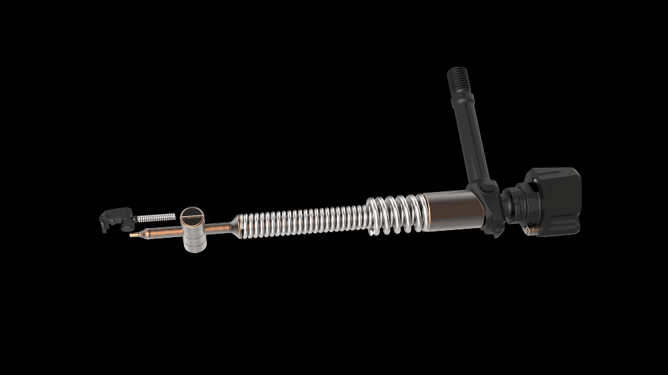

Controlled-round feed extractor grips a large portion of the case rim taking full advantage of the patented pivoting bolt handle that easily pulls even the most stubborn cartridges from the chamber.
The pivoting bolt handle can be swapped out for a fixed handle thus converting the action to one with conventional cam extraction better tolerated by highly sensitive triggers.
The entire bolt assembly is composed of only sixteen parts, but can function with as few as twelve, of which two are springs and one is a ball.
The entire bolt, even the striker assembly, can be disassembled in the field without the use of tools.
A screw-adjustable trigger hanger makes easy work of positioning Rem700 compatible triggers for bump-free bolt closing.
Dual cocking cams reduce friction within the bolt for easier bolt lift.
The bolt knob is our best ever and makes fast cycling really easy. Other knobs can also be adapted to the standard 5/16-24 handle thread.
The circular section of the bolt handle makes sweeping it back easy if that’s your preference.
Robust 9 o’clock bolt release has a direct load path to the receiver which protects the its pivot pin.
Patented toroidal bolt-lug bearing surfaces reduce stress.
The Coup De Grâce is explosively tested for safety at pressures that greatly exceed standard proof loads.
Weight: short action 947 grams (2.1 pounds), long action 1084 grams (2.4 pounds)
Why, you might ask, would we offer the Coup De Grâce at such a low price? Well, let's just say I'm a big fan of decentralized decision making and to that end, I think everyone should have long range rifle built on the best action ever offered by anyone at any price. But that's just me.
Enjoy
Ted

Traditional actions cock and cam for primary extraction on bolt lift.
The Archimedes cocks on bolt lift and does primary extraction with the tilting handle.
Does this action work the same as the Archimedes?
I ask as I did not see a mention of camming in the description.
Thank you.
-Stan

The description says it does both, but to have camming vs pivot you need to swap the handle.
Same barrel thread specs as everything else ARC, allowing Nuke barrels to interchange and vice versa?
Sort of. Ideally, you'll want to run a conical breech although it has fed well with 6.5 CM and similar from an AIAW mag. AICS mags will certainly require a conical breech. We'll post a drawing of the breech on our website soon. Cutting the breech face is easy, even with a conventional lathe.

As others have replied, the Coup can run either way. Elaborating, the pivoting handle does not make contact with the extraction cam machined into the back of the receiver. The fixed handle does. A spring and bushing is used to bias the pivoting handle forward giving it a convention feeling. It run the pivoting handle just fine with the spring and bushing but that would leave the handle loosely pivoting back and forth until the bolt is closed. Totally ok to do that if you like the way it feels.
We decided to offer fixed handles specifically for triggers that have a tendency to drop strikers when actions cycled quickly, most notably the Trigger Tech Diamond single stage and one from Bix'n Andy. The fixed handle will contact the extraction cam before the cocking piece contacts the sear bar of the trigger, thus softening the blow.
All that said, run the pivoting handle if you can, especially with bigger cartridges like 28 Nosler on up. Hitting a bolt knob to break loose a stuck round has been an undesirable necessity for over a century until the introduction of our Archimedes some years ago. The Coup De Grâce just takes it to the next level.

This looks like 🔥. Any chance of a swept handle? I’ve got a thing for them and as fast as the tikka handles sell out I’d think a lot of other people do as well.
Yes. The handles have a circular cross section that is easily bent for sweeping it back. I should mention that it's easily bent before it's heat treated for strength. Maybe we should selectively heat treat the handle so that they're bendable outside of the machine shop. How about that? Yet another feature. I'll look into that.

Does the extractor flex and stop contacting the case rim when you close the bolt like on the Mausingfield?
Is this sort of an Archimedes 2.0, or does the Archimedes retain some features that this doesn't have?
Wow I am going to have to add to my ARC collection.
Just a question for Ted why the trigger hanger? I know you will have a good reason for it and will the action come with options for different triggers. How does the screw adjustment function?
Curious to know why this type of extractor was used over the ones found in the Arch/Nuke or MF. I've seen this extractor design used in pistols, can't recall if I've ever seen it anywhere else.
The circular section of the bolt handle makes sweeping it back easy if that’s your preference​
From the OP
the knob is pictured, and looks very ARC like. they've had that shapefor a while this one just looks even more 'refined'. or like the A419/Zermatt offerings
thumb on top of stock/chassis. lift and pull back with side of hand type motion. not grabbing a whole the whole knob with your hand
not the traditional sense of a swept handle
swept bolt = origin, R700
straight bolt = tl3, Impact
