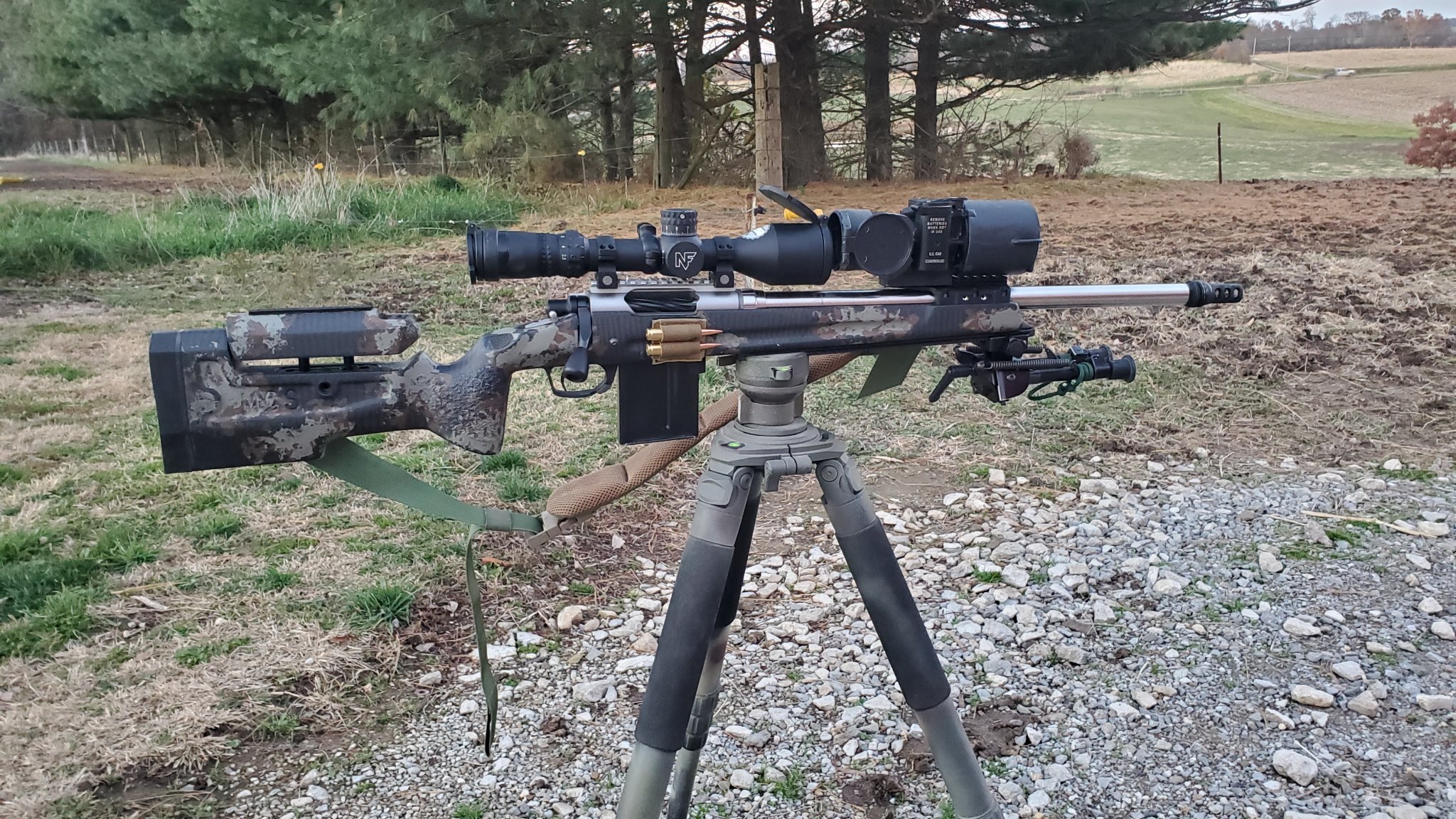

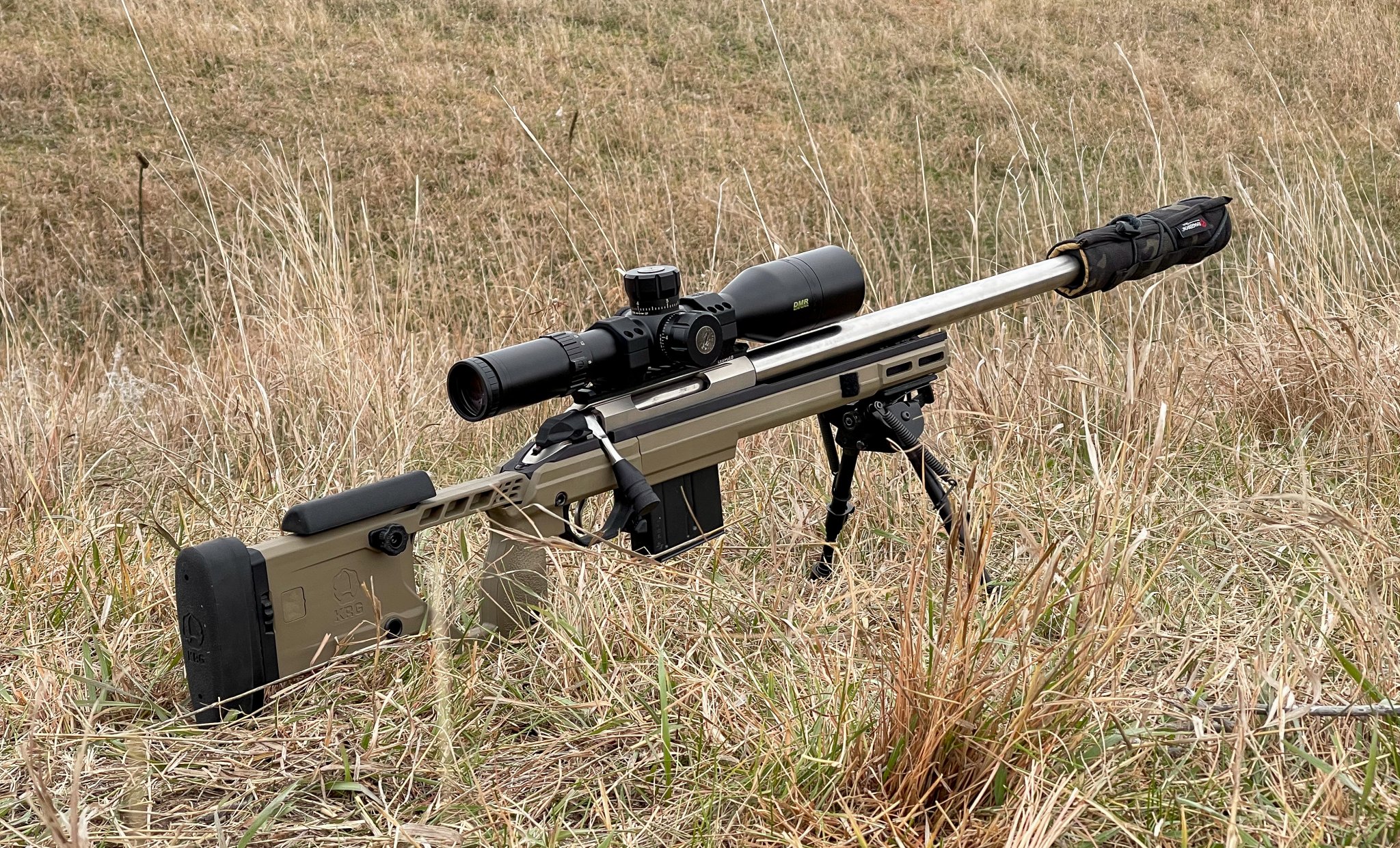

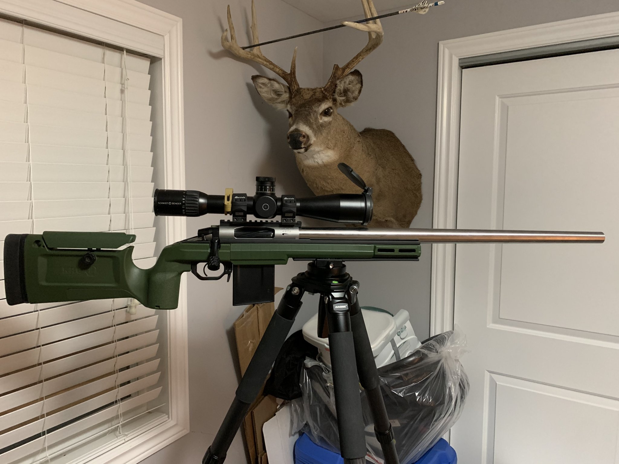

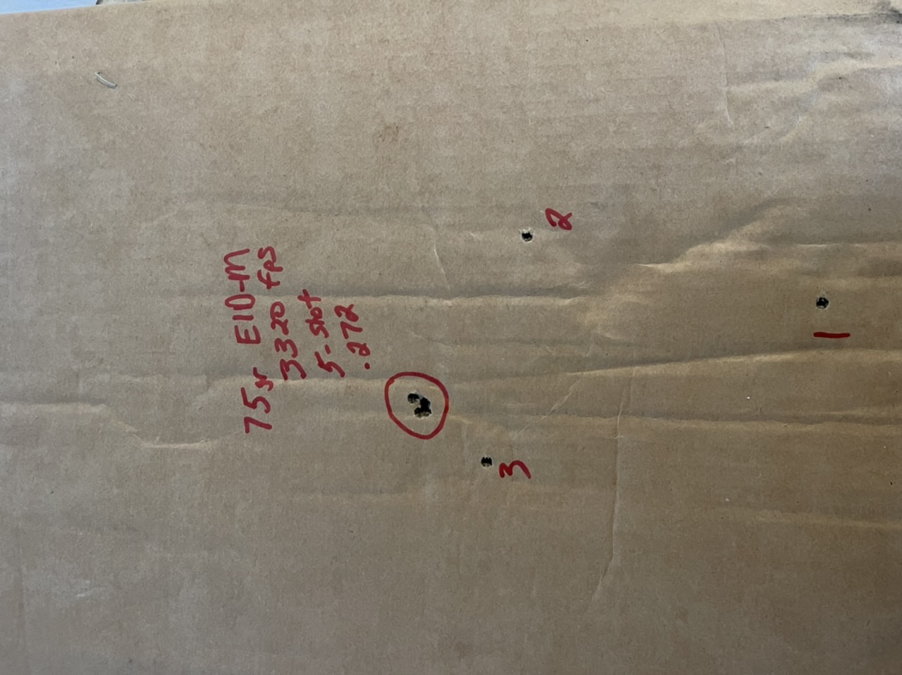

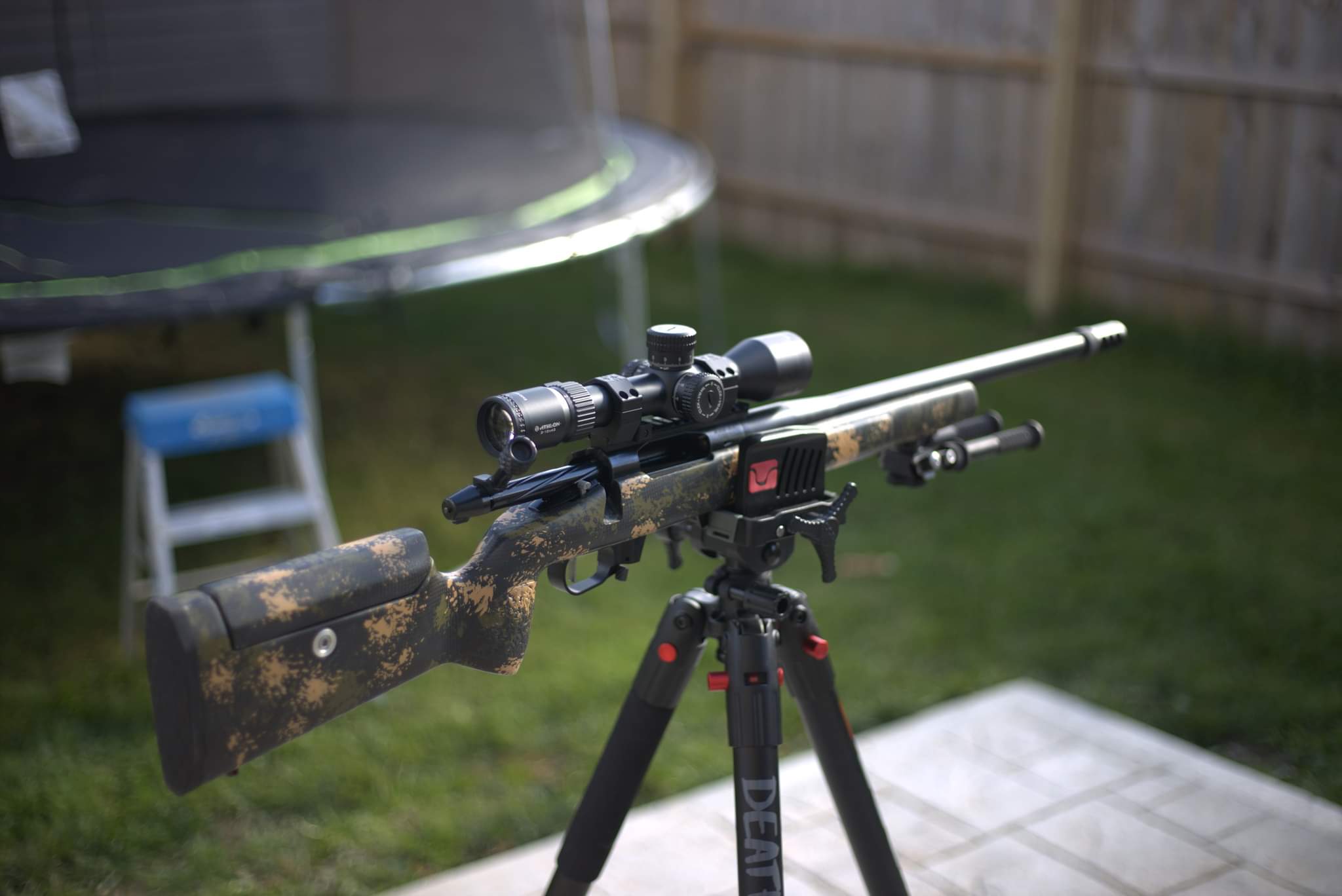

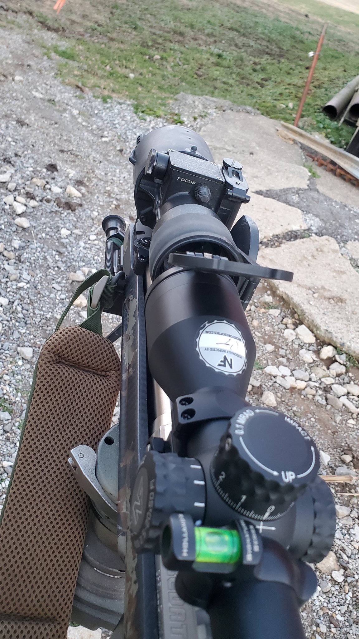

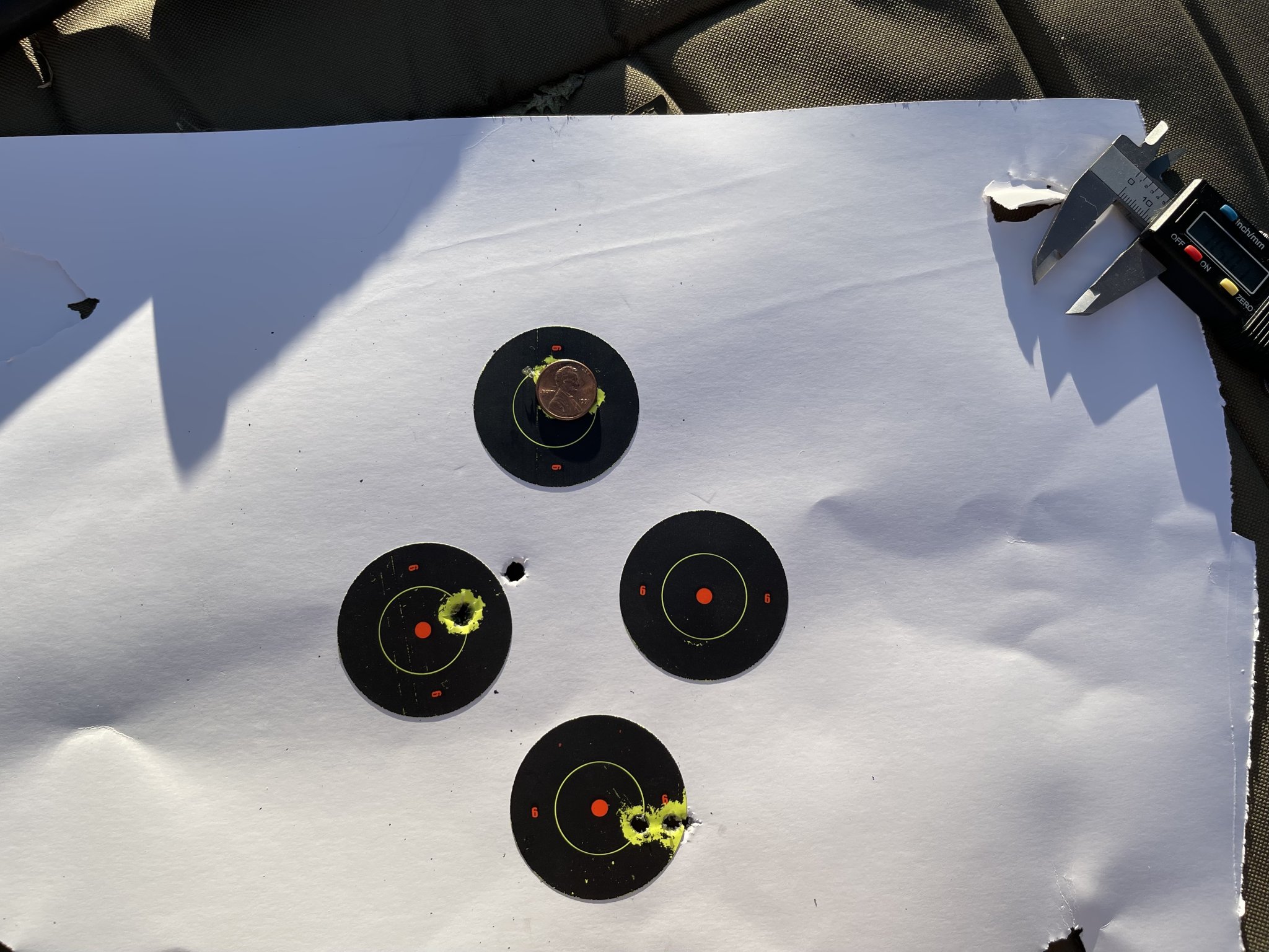

My New Coyote Rifle Build:
Tikka T3 22Creed, Bartlein 18” m24 8 twist, Krg X-ray, mt. Tac trigger spring, Surefire Socom can, bushnell HDMR G2, seekins rings
Shot the new rig for first time today. Guessed on a load of 42.0 4350 and 75 eldm .015 off lands. Shot 1/4 moa and averaged 3320fps across first 8 shots down barrel. I am extremely impressed. Going to be heck on coyotes.
What are some of your main squeeze rifles for coyotes and preferred load 🤘

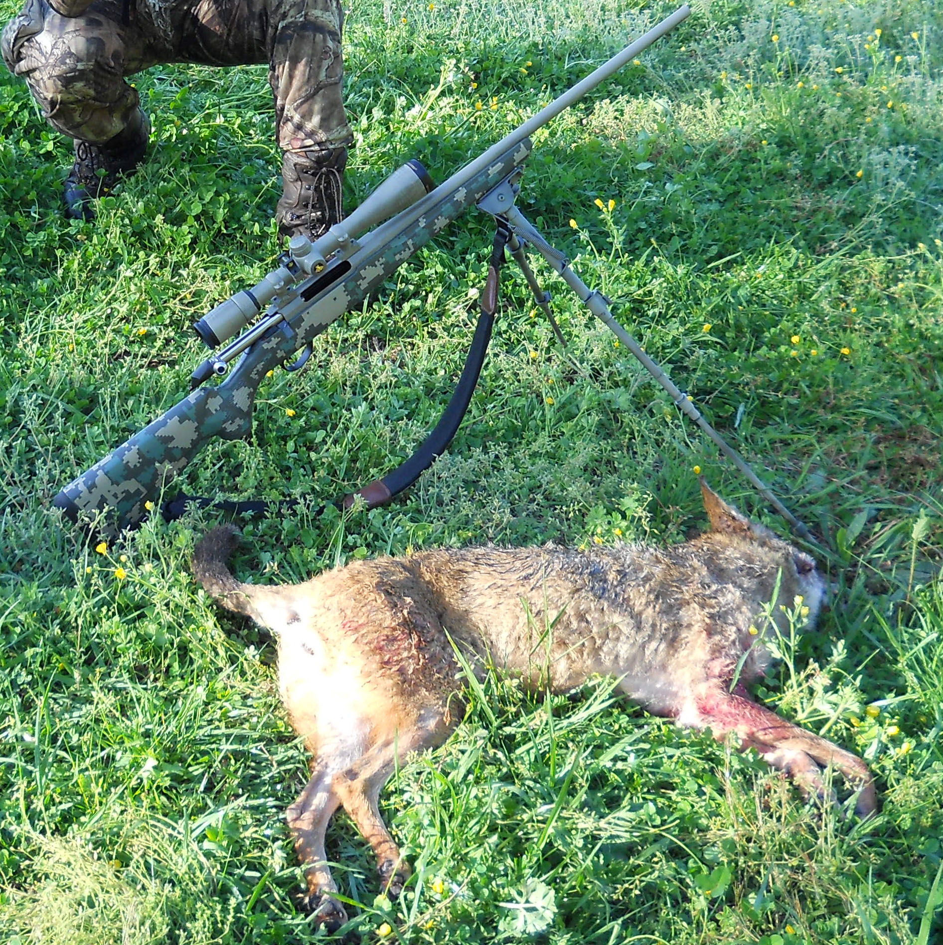

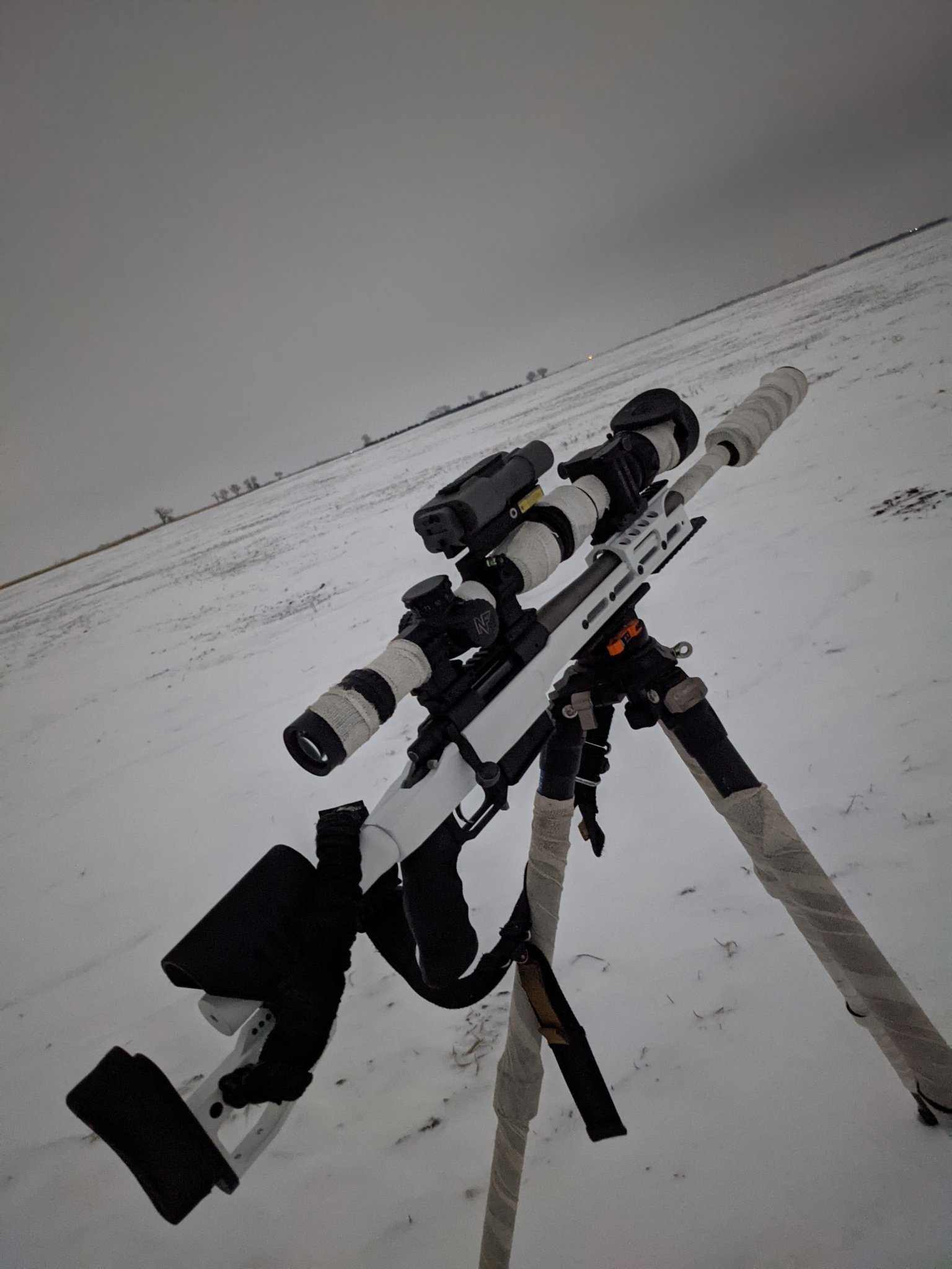

Here’s mine:
- Bighorn TL3
- Xcaliber 1:8 22-250 AI @ 22”
- Manners PRS-2 w/mini chassis
- Triggertech Special flat blade
Slings the 88 gr ELDM to 3150 over 40.3 gr of RL-23. Shot this coyote a few weeks back at 600. It’s a great combo!

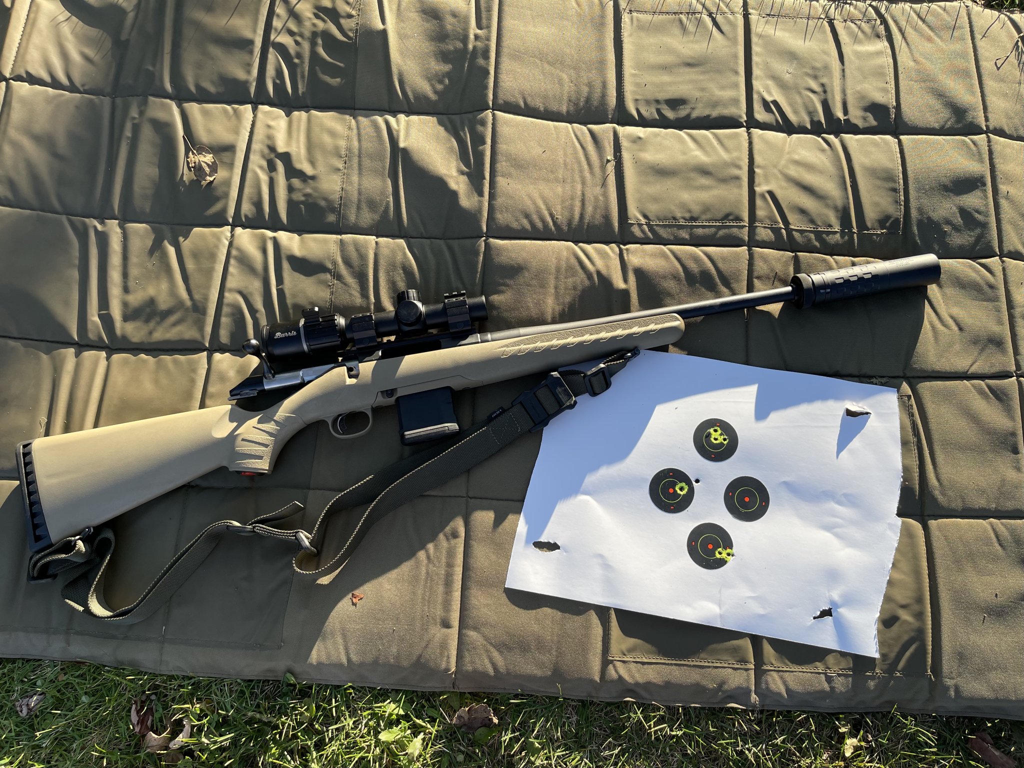

12” 6.8 spc 90gn Speer tnt going 2700fps, Burris rt6, silencerco specwar. I also just dropped off my tikka 223ai to get the barrel chopped and threaded down to 16” and will probably use that more.

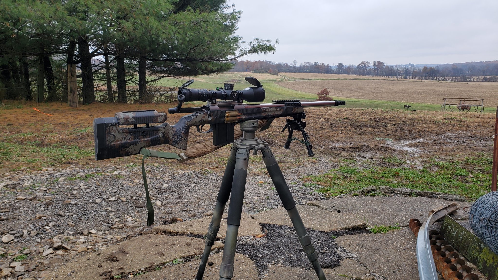

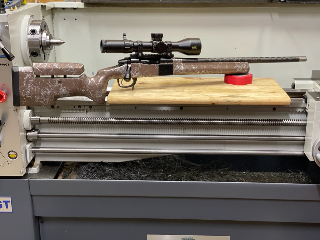

Origin action
Bartlein CF 8 twist at 21"
Bushnell DMR2 glass
TT Diamond
NF UL rings
My old Manners I keep for a spare
22 GT pushing 73 ELDM at 3350 fps.
I've pushed it faster but backed it down for now.

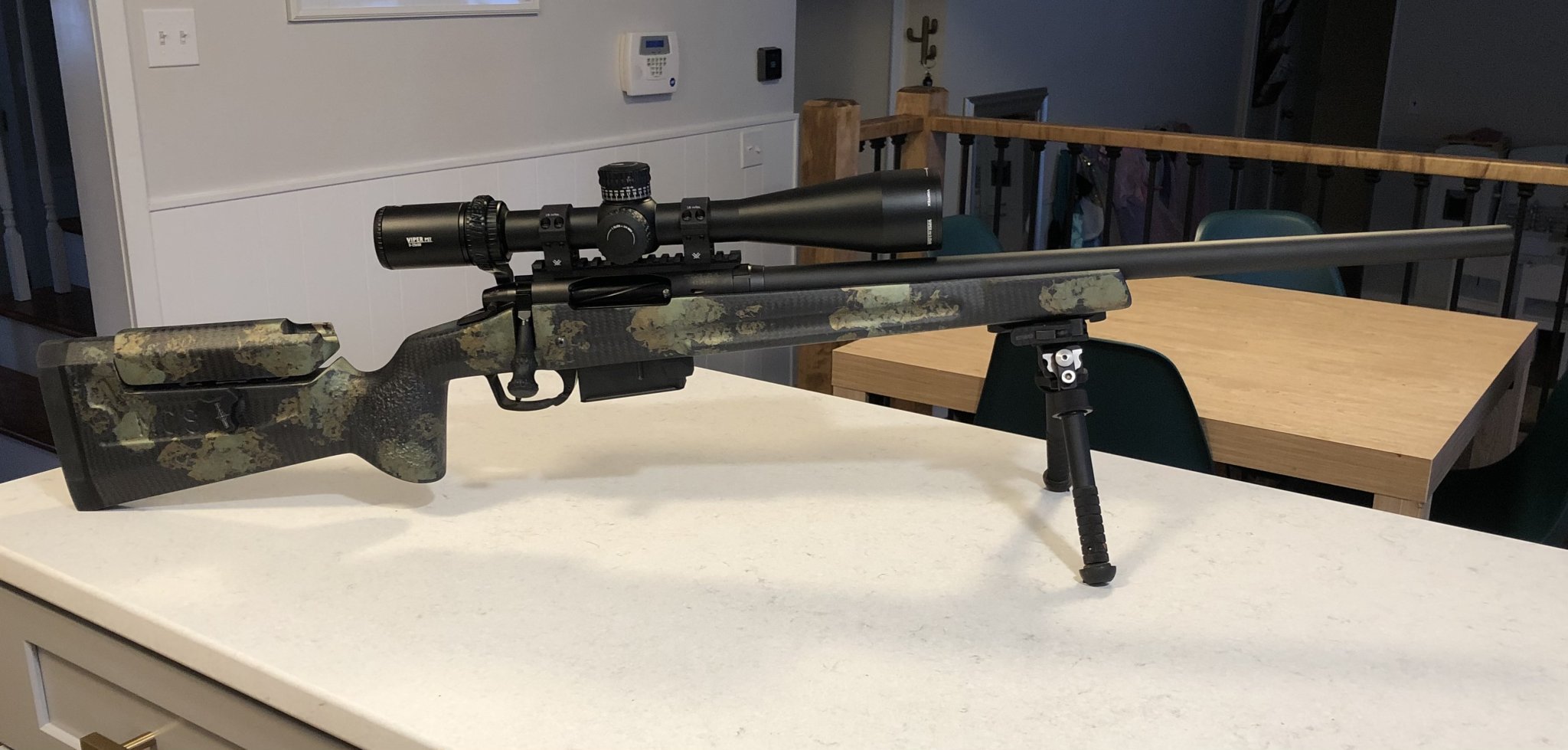

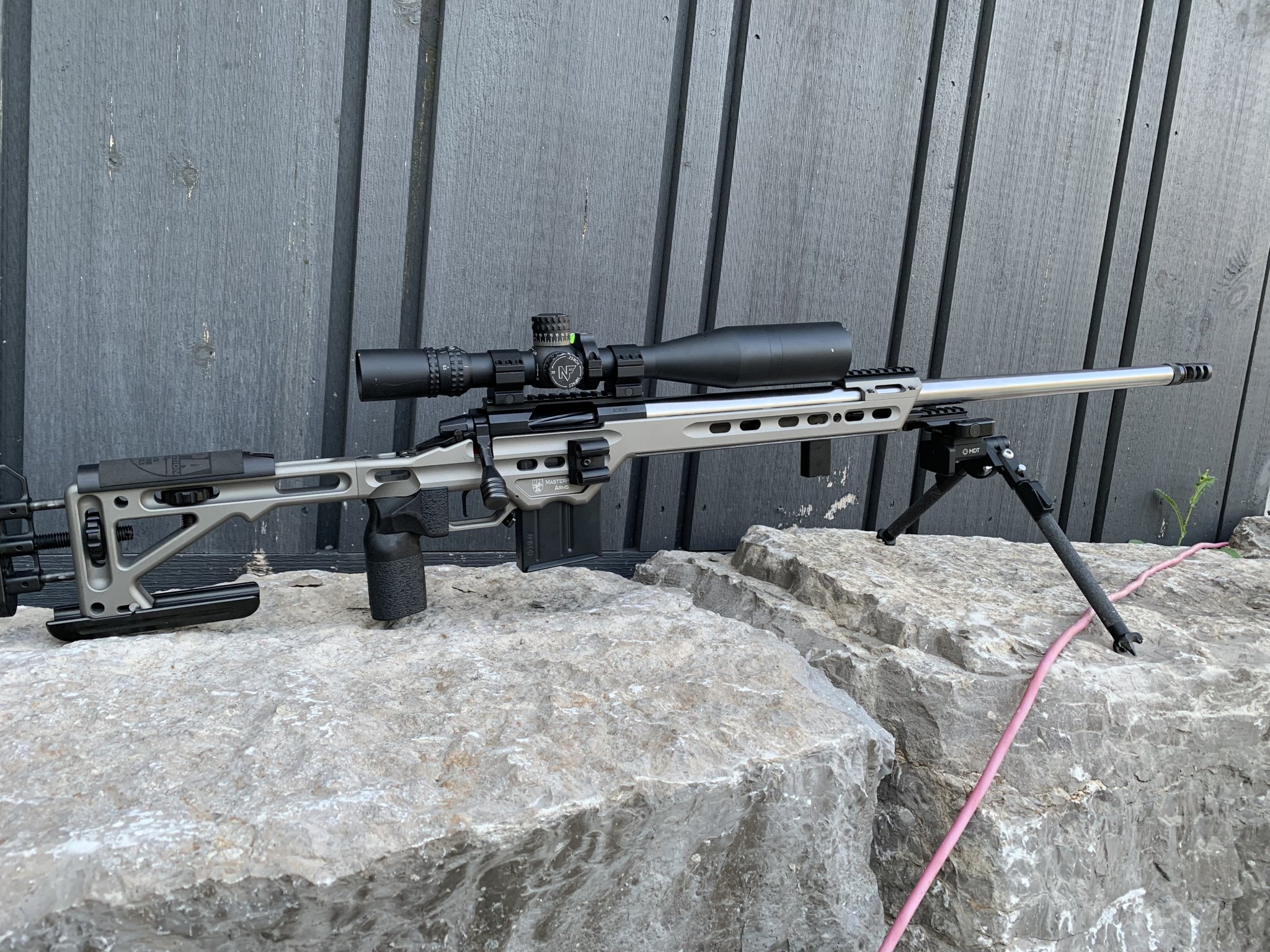

Primary critter killer all around for myself is this 223ai. I've swapped scopes a few times but that's about it. I do also have a 22 creed barrel for this rifle but it stays the 223 99% of the time.
Surgeon 591 dlc coated
Mcmillan a3-5
Either a 3-15 premier or s&b pmii glass

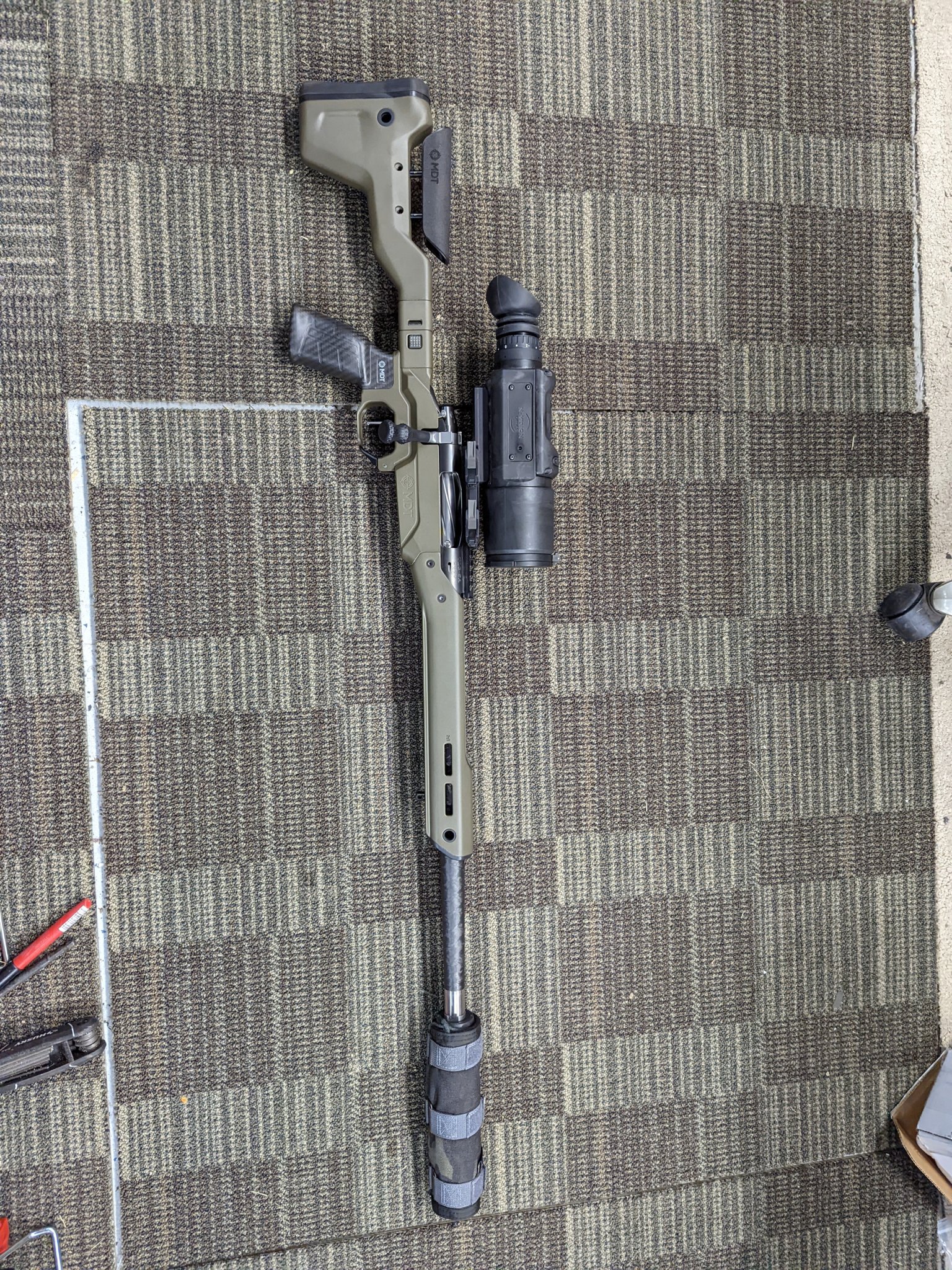

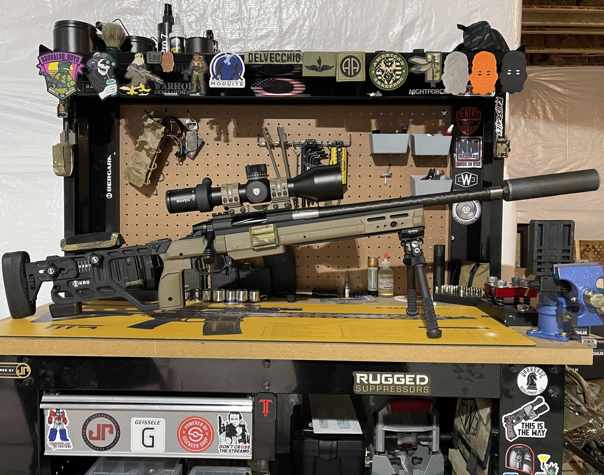

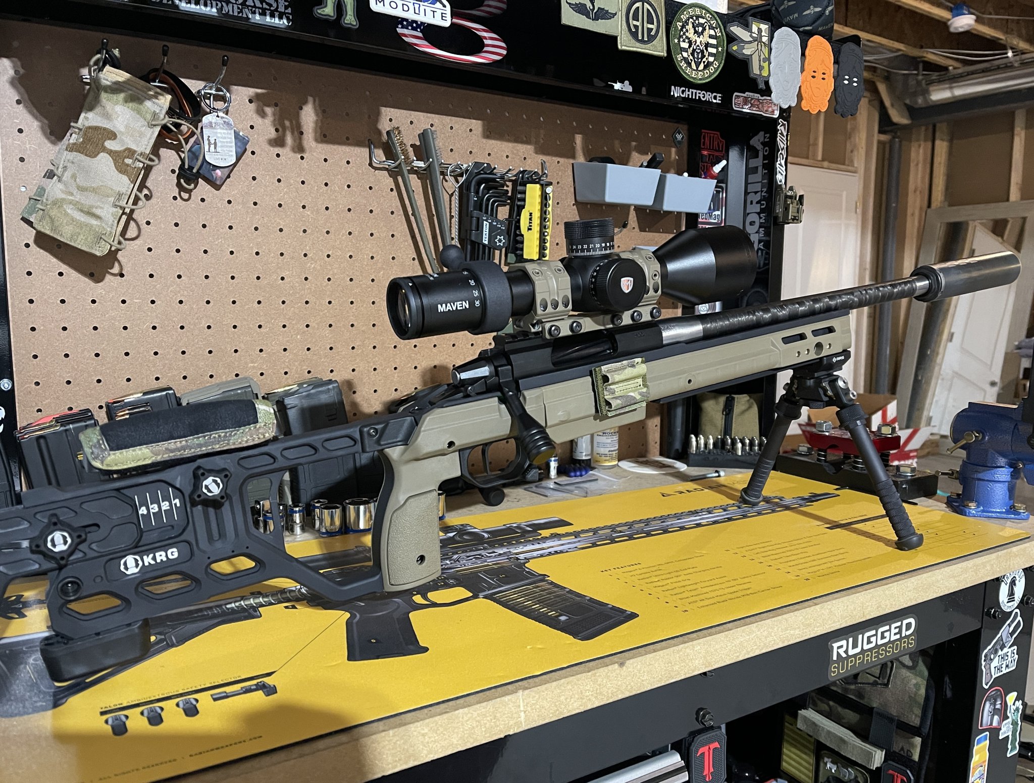

Just got it together and get to shoot it tomorrow and coyote hunting Friday so pretty pumped.
Krg whiskey 3 chassis
Impact 737r
.223 Bartlein 16” cf barrel
Triggertech diamond two stage
Maven rs4 (moa2 reticle)
Spurh 4001 mount
Omega 300 can w/area419 system

Two kids under two so factory has been the go to for a couple years now. It’s a 1/7 so hated three types of 55gr, liked the hornady tap 60gr urban, loves the 62gr vmax and hated the one I was hoping for hornady tap 70gr so for now it will have 62gr vmax until I get time to try more.

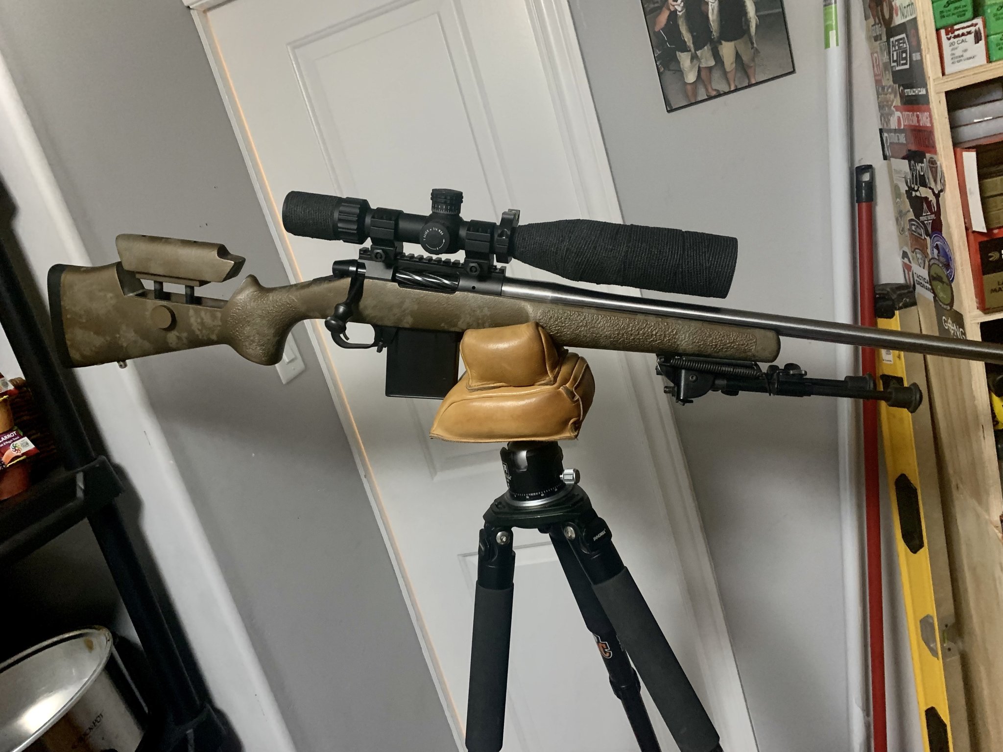

Trued Rem 700 - Northwest Action Works
Side bolt release - Southern Precision Rifles
HS Precision Bedded (me)
XLR Cheek Riser custom install (me)
Custom bolt knob
Trigger Tech Special
Bartlein CF 1:7 twist Chambered by Southern Precision Rifles
Tungsten/Black custom mix Cerakote (me)
Duracoat custom stock paint (me)
Steiner T5Xi 3-15x50
88 Eld-M and 90 A-tip 3,050 fps
