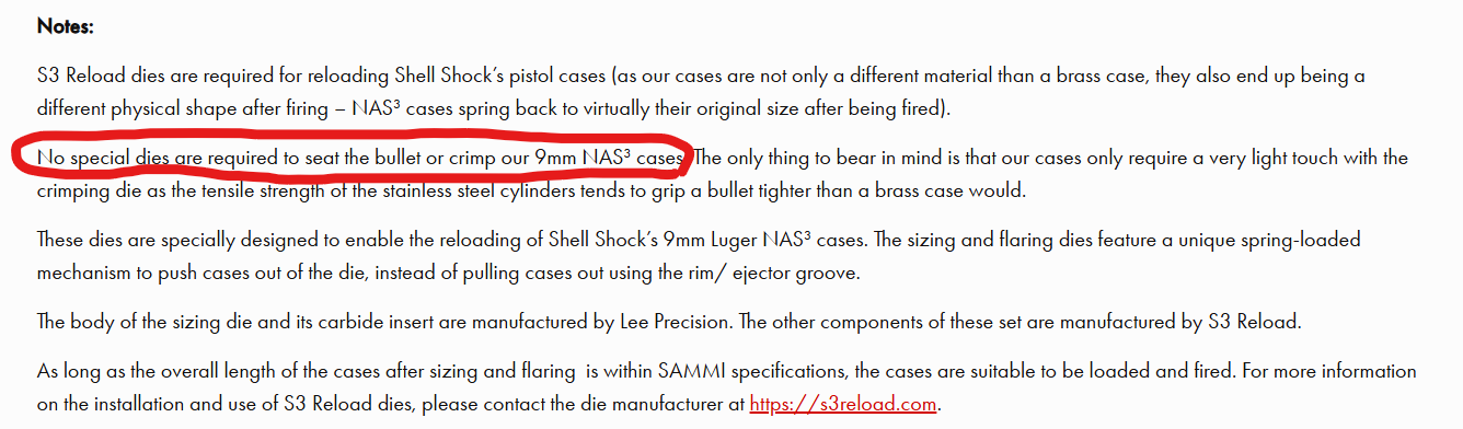

    From the Shellshock web site:
    https://shellshocktechnologies.com/...and-flaring-dies-for-shell-shocks-nas3-cases/
    You may want to consider their dies for the sizing and flaring, but the taper crimp is nothing special.
    Also, you must consider that the 9mm was never meant to have a hard crimp since it technically is supposed to headspace on the case mouth. All you want to do is remove the flare and maybe coax the mouth with a gentle taper. YMMV
    I did see that and I already have their flaring and sizing dies (well, S3's dies). Was just worried about wear on a progressive over time.
    Lyman has their micrometer taper crimp and they sell a carbide insert and mention the NAS3 cases specifically which got me started down the rabbit hole in the first place. I wasn't willing to pay over $200 for a crimping die once all was said and done.
    I'll stick with what I have and I do realize I'm only removing the bell. Conversely, these are being used in a PCC in super semi mode, not a hand gun, so they'll get slammed around a bit more.
