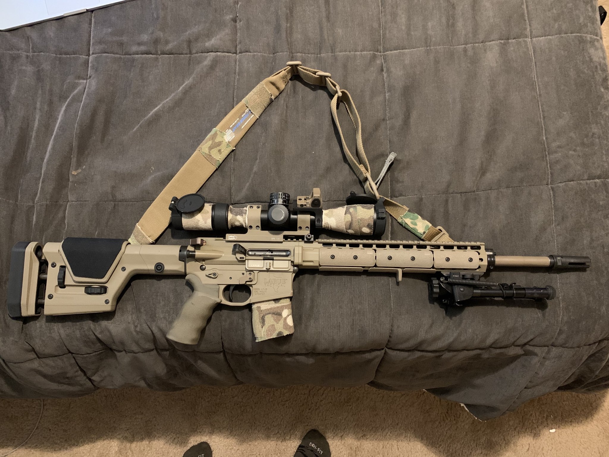

Id spend the cash and get the complete JP BCG to go along with the bolt and SCS. I went through bunch of different gas blocks on my build. ended up sticking with the SLR. The XTR will suite you well, although its a bit large on a small frame AR.

Id spend the cash and get the complete JP BCG to go along with the bolt and SCS. I went through bunch of different gas blocks on my build. ended up sticking with the SLR. The XTR will suite you well, although its a bit large on a small frame AR.View attachment 7399126
nice looking rig is that the same XTR scope? what size receiver extension?

No, thats a PST Gen 2 3-15. Carbine extension. Rifle started off as a complete Larue Grendel but I wasn't impressed with the accuracy so I had Craddock spin up a Bartlein barrel and replaced the BCG with the JP
