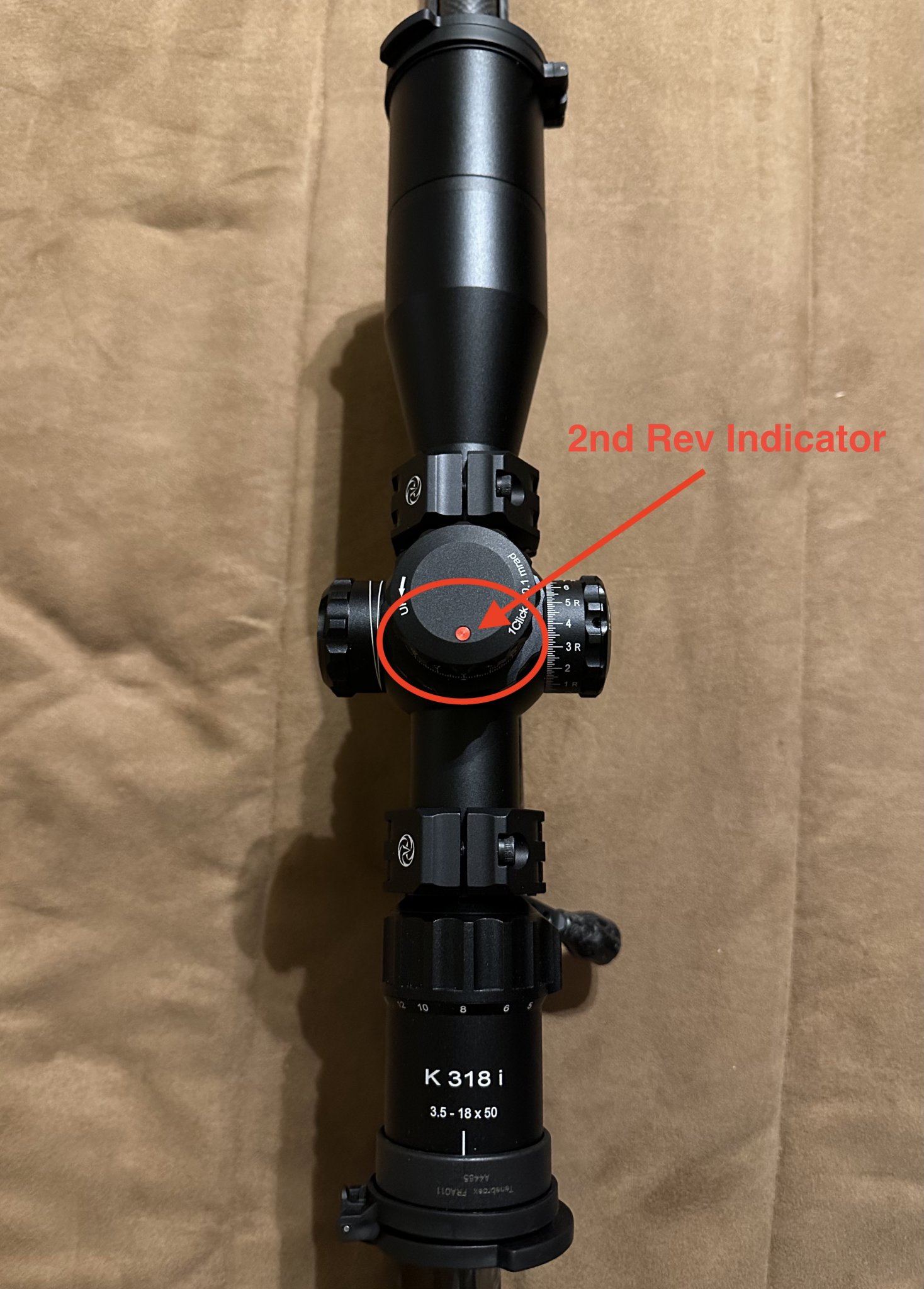

Kahles K-series have a little anodized red button that pops up when you hit the 2nd rev letting you know where you're at. I thought that was pretty cool.

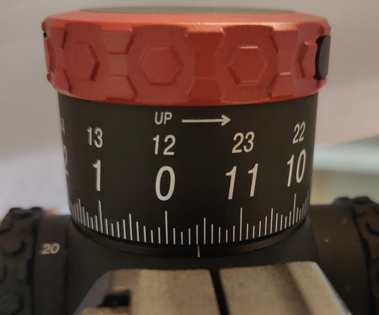

Total elevation turret travel on my scope is about 29.5 mils, so more than the advertised 26 mils. The scope has 22.5 mils of elevation up from zero, so it's about 7 mils up from the bottom of the travel at zero, and I didn't notice any degradation in the image quality at my zero setting compared to dialed 8 mils up to be in the center of the elevation travel range.

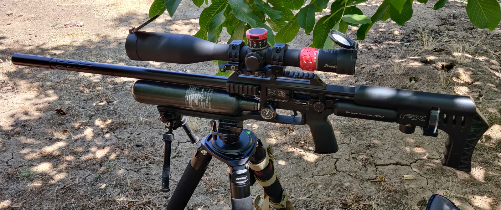

Pic of the XTR Pro out doing its thing this morning. Got 34 squirrels in a little under 3 hours before I decided sitting in the pool sounded better than sitting in a 102F orchard.

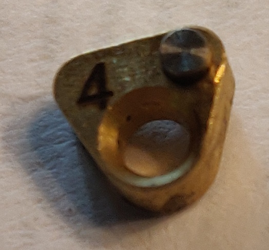

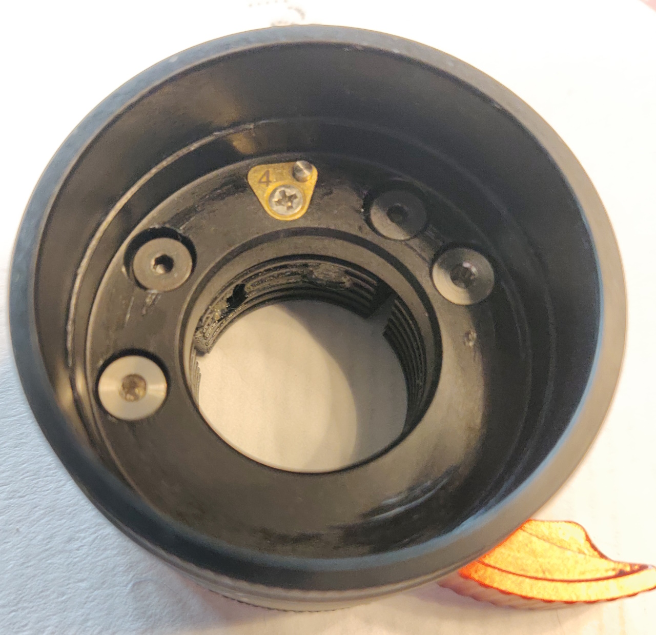

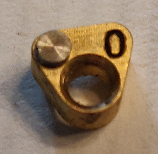

I was a bit disappointed to find that the zero stop is fixed at zero and is non-adjustable, I was hoping it might be set at -0.5 mils like many other manufacturers do.
Look under the turret cap. There is a very small tab with the number 0 on it. You can remove this brass looking tab and flip it to get the zero stop to go negative. I believe there is a video on YouTube that shows it.
I was just messing with the elevation turret and found exactly that before seeing your post. I flipped the zero stop pin holder and took pics to post it here and then saw your post about it while resizing the pics. Thanks!
The brass piece with the zero stop pin can be flipped which offsets the pin giving you zero or -0.4 mil for the zero stop. It's marked "0" and "4".
All you have to do is remove the screw, tap the turret so the zero stop piece falls out, flip the tab to the "4" side, and reinsert it and reinstall the screw. Now dial your elevation turret down to -0.4 below your zero, reinstall the turret and while pushing downwards rotate it until it contacts the zero stop pin at -0.4, and relock the cam lever. Dial up to zero and you're ready to go. Now the zero stop is at -0.4 mils... perfect!
I'm very happy the scope has the choice of zero stop at 0 or -0.4 so I can dial down -0.3 for target use in the backyard. It's obvious Burris put some thought into this thing and it's appreciated that they did.

Inside of turret showing brass zero stop pin holder. It had the "0" side facing up as shipped:
Brass zero stop pin holder, one side shows 0 and one side shows 4:
After reinstalling with "4" facing up, zero stop is now at -0.4 mils:
