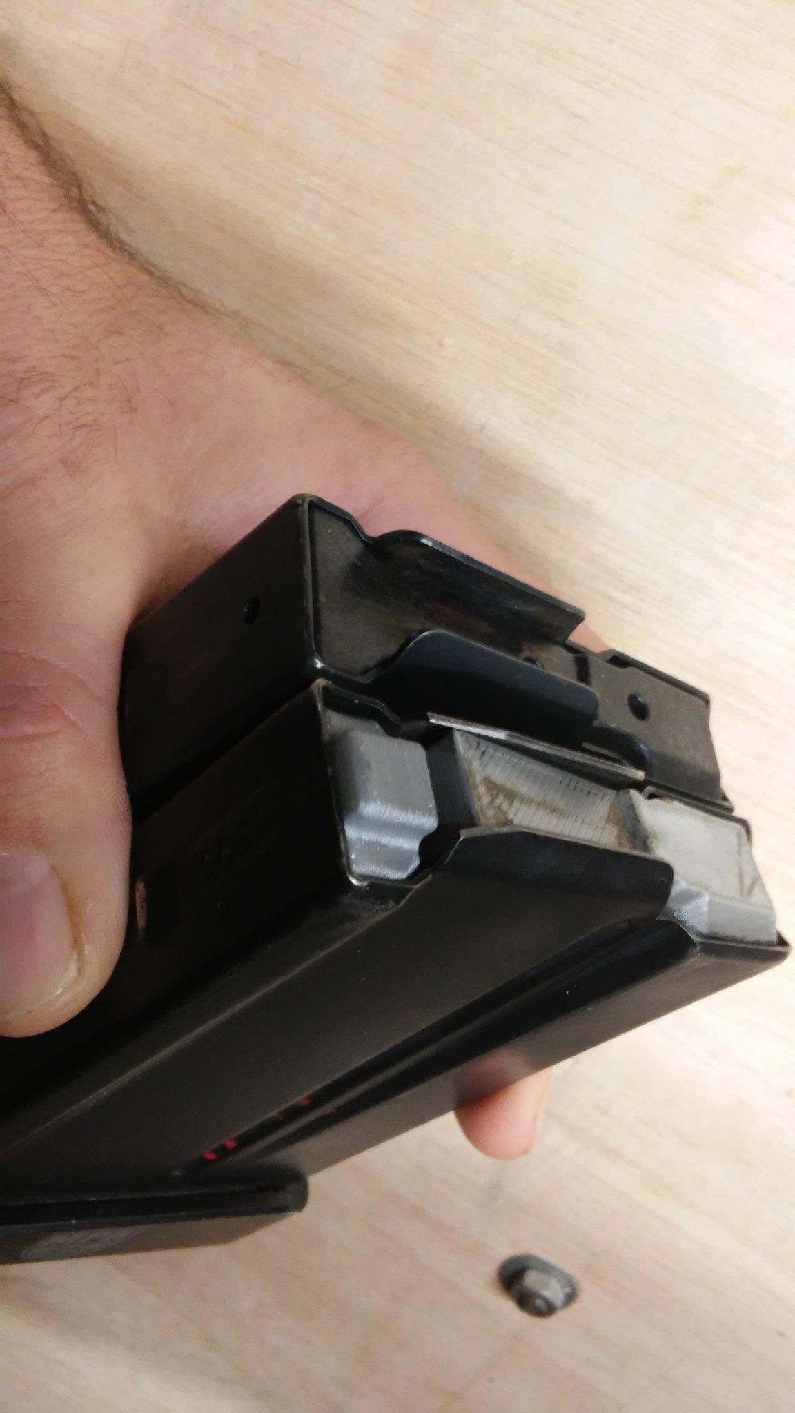

And here's a comparison of the feed lip length between the AI mag (front) and MDT mag (rear). It's a .308 MDT mag, but the same issue occurs in the BR mags. I've had one (returned it for this problem) and also recently tried with my friend's.
Thanks for the pictures and videos! That is very informative and unfortunately there is little that can be done on our end to solve that issue :( It looks like the AI's with the kit feed and function okay, and it may be worth giving the AI AW's a shot with the HRD gear kit too? I know that a lot of people have had good luck with that combination in 3-lug actions (if your action is cut for it that is).
