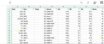

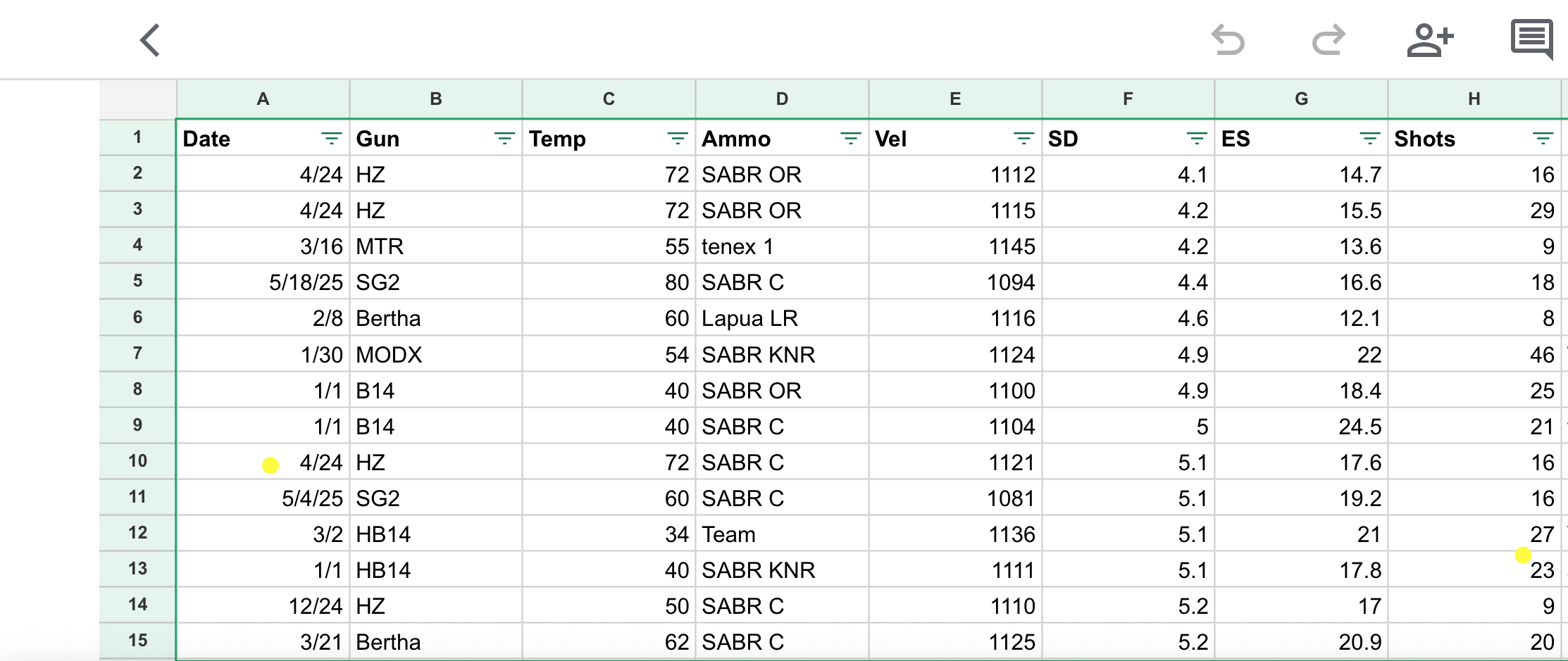

Oh, and here is a snapshot of my chrono data that I track. I shoot a lot of eley for historical reasons. But that random lot of Lapua long range was amazing. It was sold out when I realized how awesome it was, or I would have bought a few cases of it!

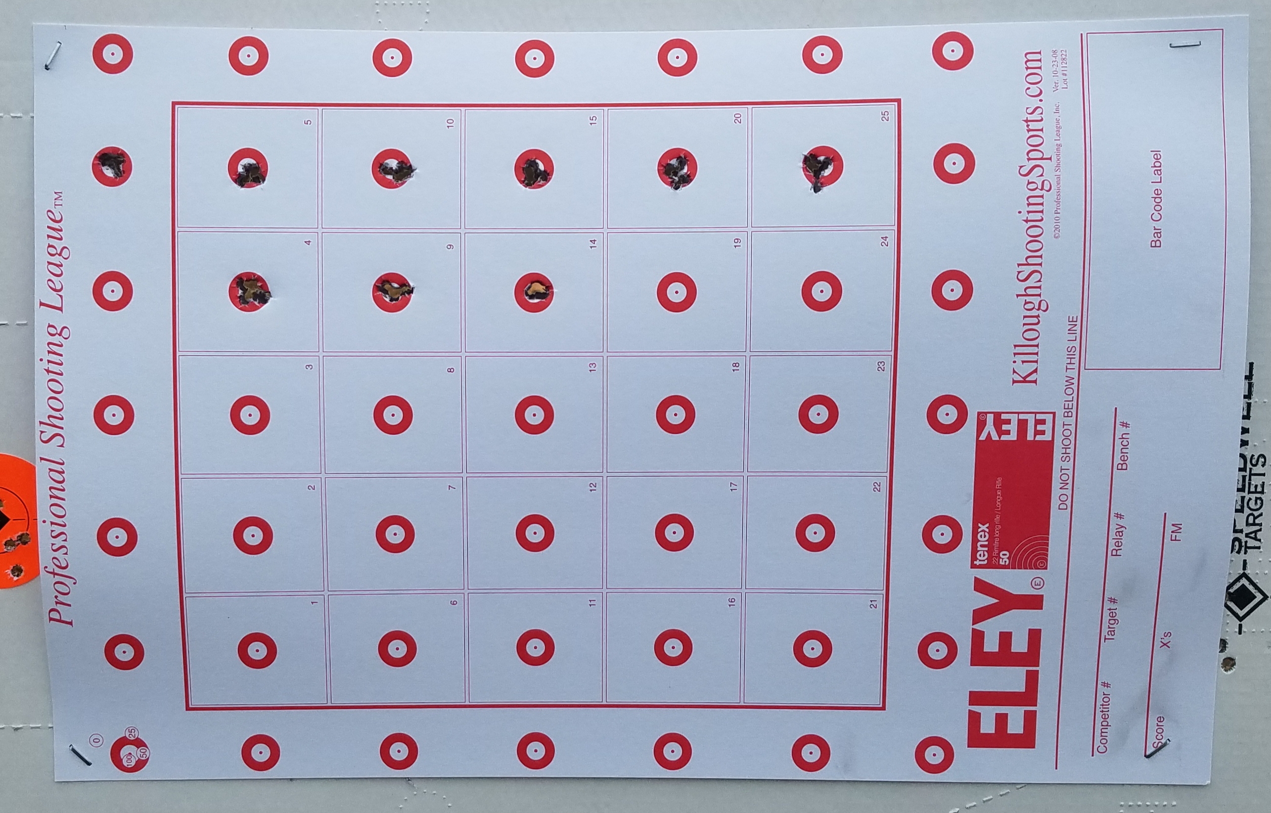

.25" for 25 shots at 50 yds is what I want.
Something like this puts a smile on my face........ 5 shot groups at 50 yds.

If we are getting into a "custom" build, I would expect the gun to shoot .3 or less at 50 and .4/.3 at 100 once tuned with the chosen ammunition.
I'm guessing a customer isn't happy?

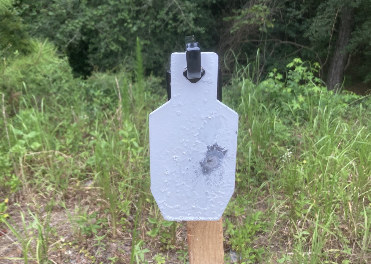

Older V22 with ACE barrel, not considered to be a "custom" to me anyhow. Bipod front, bag rear from bench. Tuned with Cx and Cortina v2 tuner.
.3-.4 at 100 yards consistently enough to say that’s how it shoots would be absolutely exceptional in my book. Most guys struggle to average that in a centerfire
Of course barring the wind with that number. Ammunition is a big part in these as you know. Although Center X isn't the top shelf, nor the bottom, it does have some fliers here and there. I have some 100 yard targets to where I tracked the velocities and normally I'm in the 1085-1095 range depending on temp, but those ones that pop out at 1060's or 1115 or so do show up. The Garmin has been a pretty good tool to help with the wild shots that occur.
