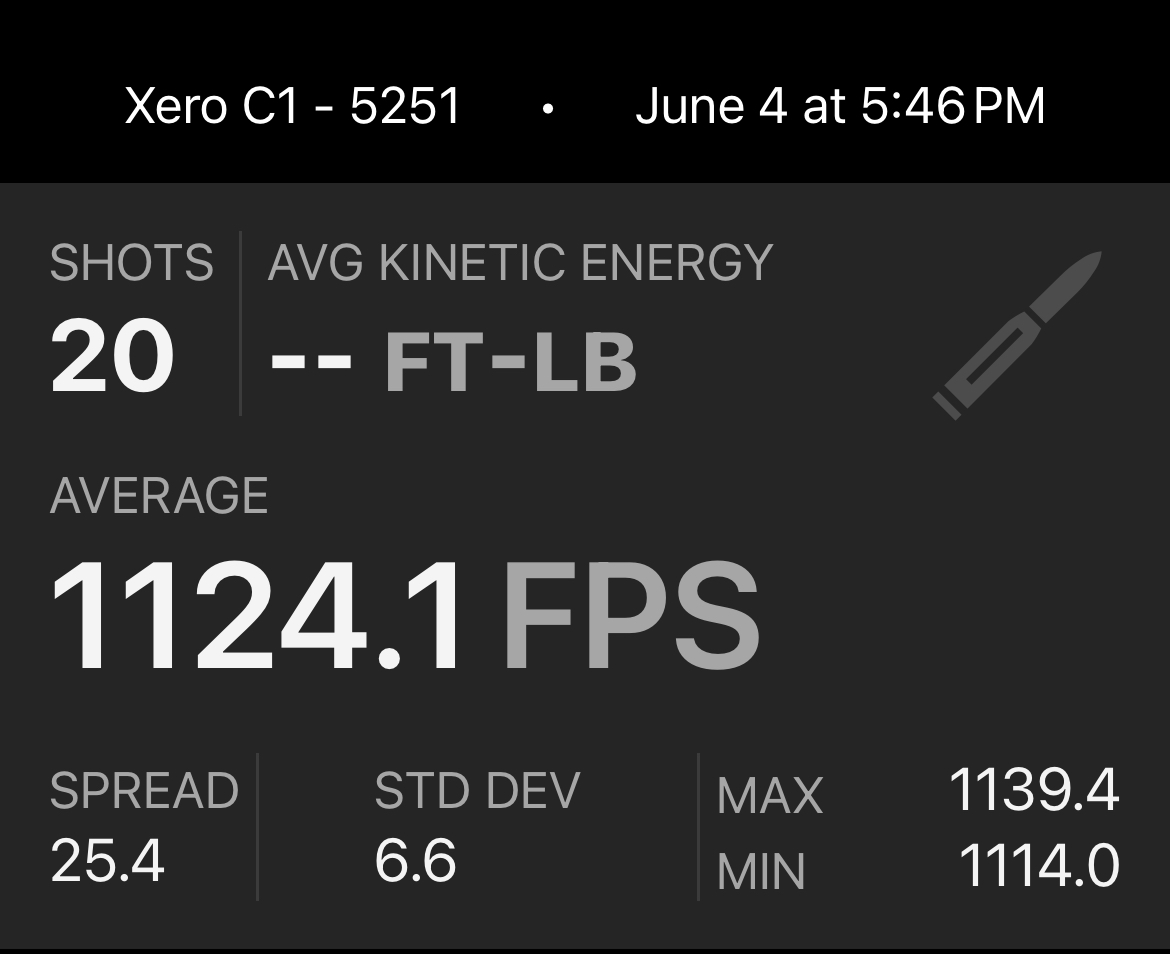

Oh, and here is a snapshot of my chrono data that I track. I shoot a lot of eley for historical reasons. But that random lot of Lapua long range was amazing. It was sold out when I realized how awesome it was, or I would have bought a few cases of it!
Those are some exceptional ES/SD numbers over long shot strings, and from half dozen different rifles to boot. Please PM the name of your barrel maker so I can have a few spun up.
