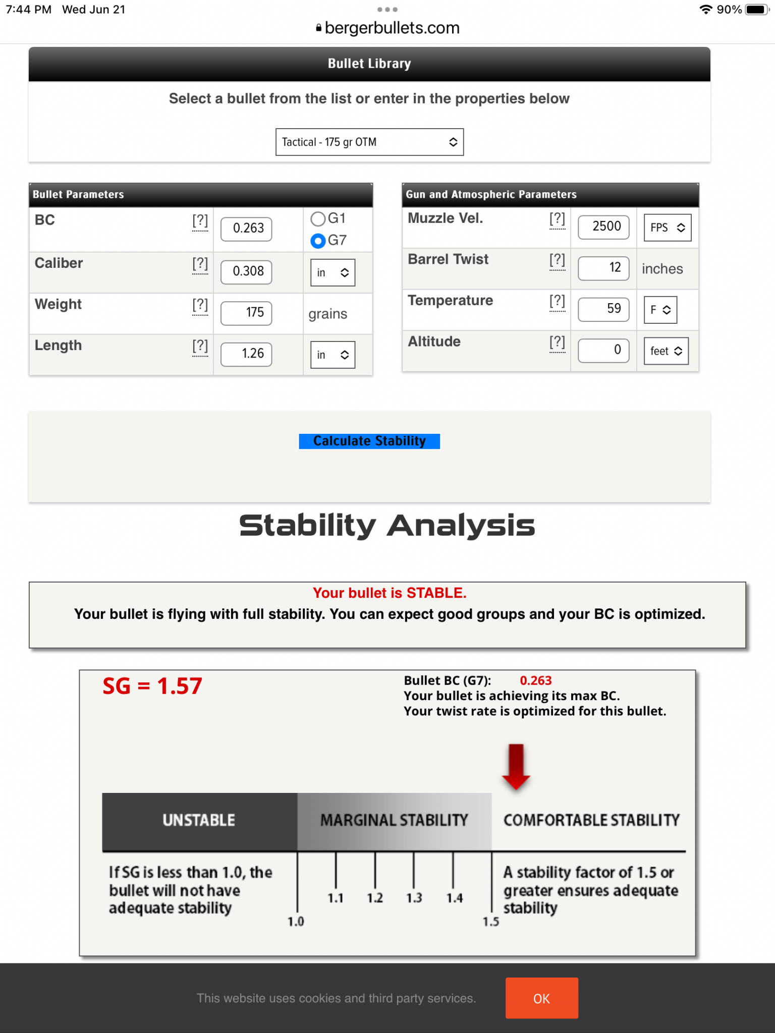

For reference, I shoot 175s at 2500fps out of a 16.5”, which gets to 1000 yards without issue. So your load is probably quite mild.
Using the 175 OTM as an example, the Berger Stability Calculator says you’re fine.
Correct, though number of twists tends to correlate with velocity. Aside from gain twist barrels, the angular momentum will increase with velocity. So if your barrel was 10” instead, it would need a faster twist because it would be unlikely to get the bullet up to that 2500 fps velocity where the bullet is stable with a 1:12 twist rate.
