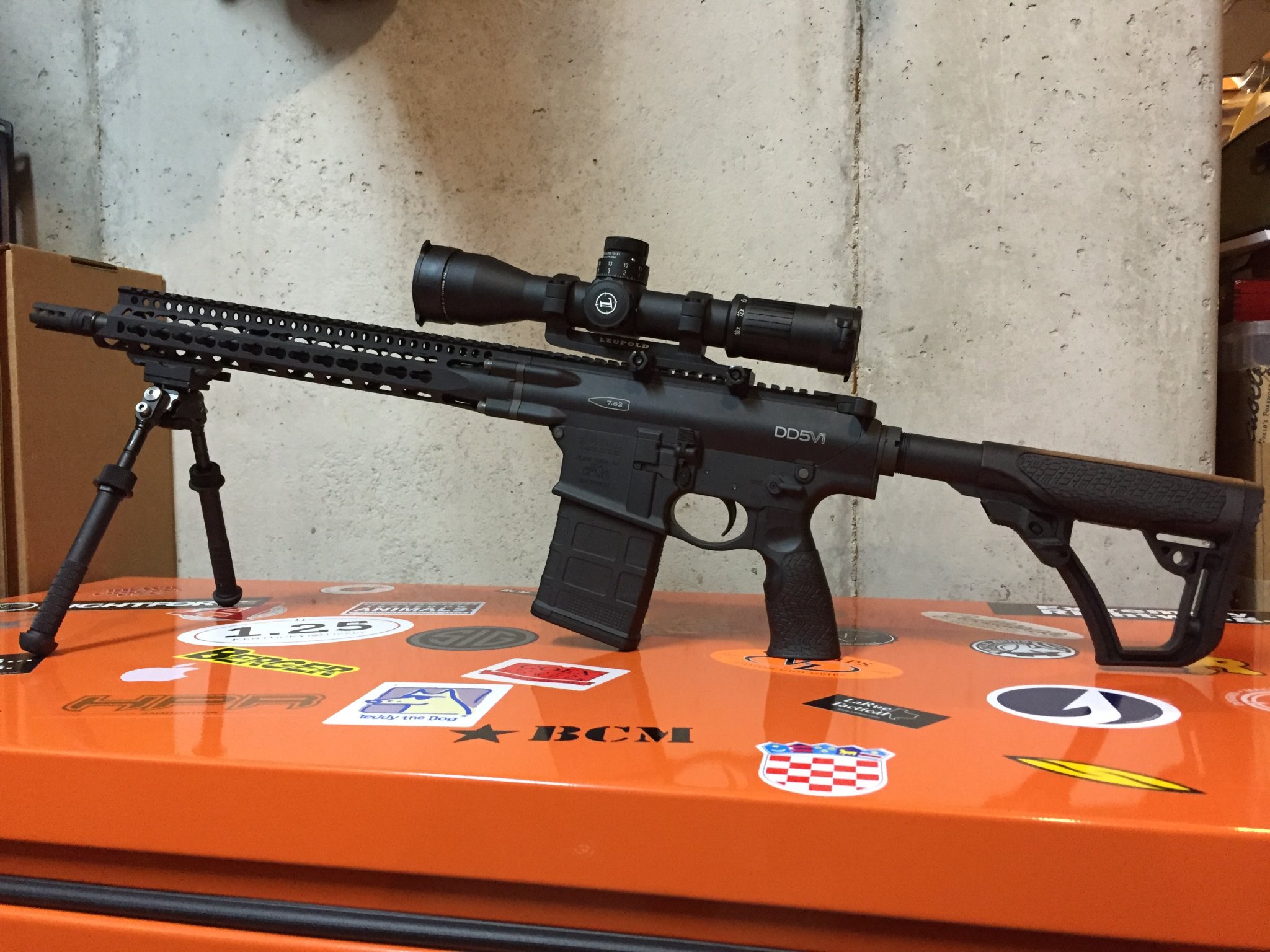

Hey,
So long story short, I have been trying to work up a load for my 20" Daniel Defense DD5v5(AR-10) chambered in 6.5 Creedmoor. During this process, I have been having many jamming issues with this platform. I believe that I am experiencing a "bolt-over-base" malfunction , which destroys the brass in the process. I know that this firearm cycled factory boxed ammo just fine, so I'm 95% sure the problem is with my reloads. This malfunction is occurring with an approx. 10% chance.
Here's What the jams look like:
Here's the damaged cartridges:
Here are the details of my 6.5 Creedmoor reloads:
Hodgdon H4895 36.4 grains
Hornady 129 grain SP
Hornady brass
Win WLR primers
Velocity: 2668 fps as measured from MagnetoSpeed V3
COAL: 2.775"
Rifle Fire-Forms @ approx. 1.563"
Resized Head Space @ approx. 1.559" (-.004" from fire formed)
Fire Formed Case Volume: approx. 53.3 grains H20
Here is the condition of the case heads (ignore the text in photo):
Here's a screen shot of Gordon's Reloading Tool, based on my load. The software and my case heads disagree with the recorded high pressure levels in the software:
I am very eager to get this issue solved so I can move onto fine tuning my loads for accuracy. Please provide any guidance or suggestions to how and where I could maybe narrow this problem down to. Any and all help would be greatly appreciated!! Thanks.
